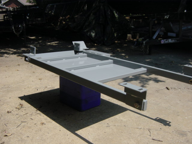

Hay wallace what is your thoughts about timber's suggestion of mounting from a bh frame?
I could see how that would work out quite nicely if done right. making a frame similer to the bh up to the back end of the tractor then attach to that frame some railing to go the length of the tractor and mount all the plates to that. I know it would not be able to go beyond the front axle due to 4wd and the side pivoting? of the fronts. might be able to put a plate on behind the bumper tubes.

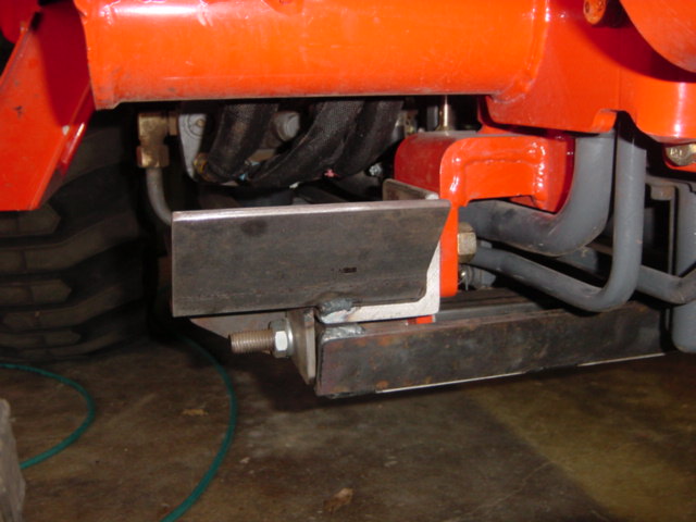

I tied my custom b/h subframe to the FEL subframe and bottom of the
rear axle casting. I incorporated parts that protected the most exposed
filter and suction tube. Not full coverage, but much better than stock.

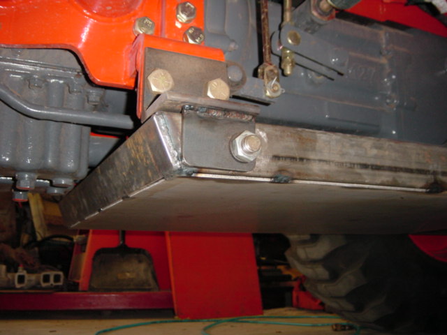

I have the same kind of property, so I armored up top and bottom on mine.
That's a serious skidplate! Nice work.
