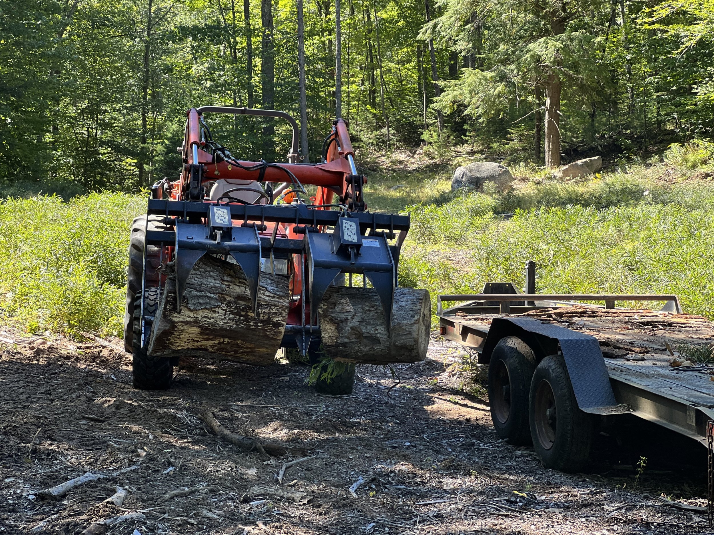

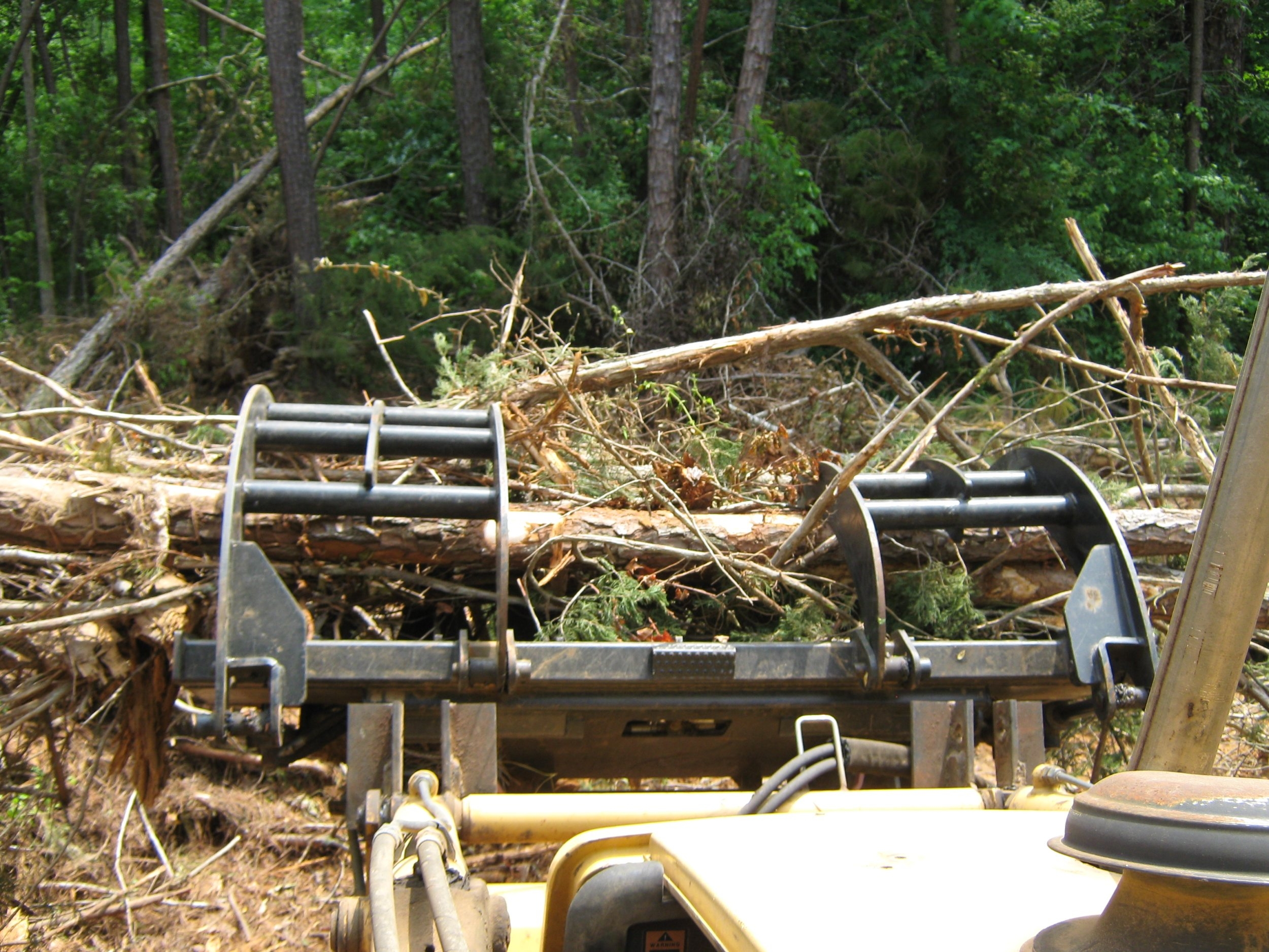

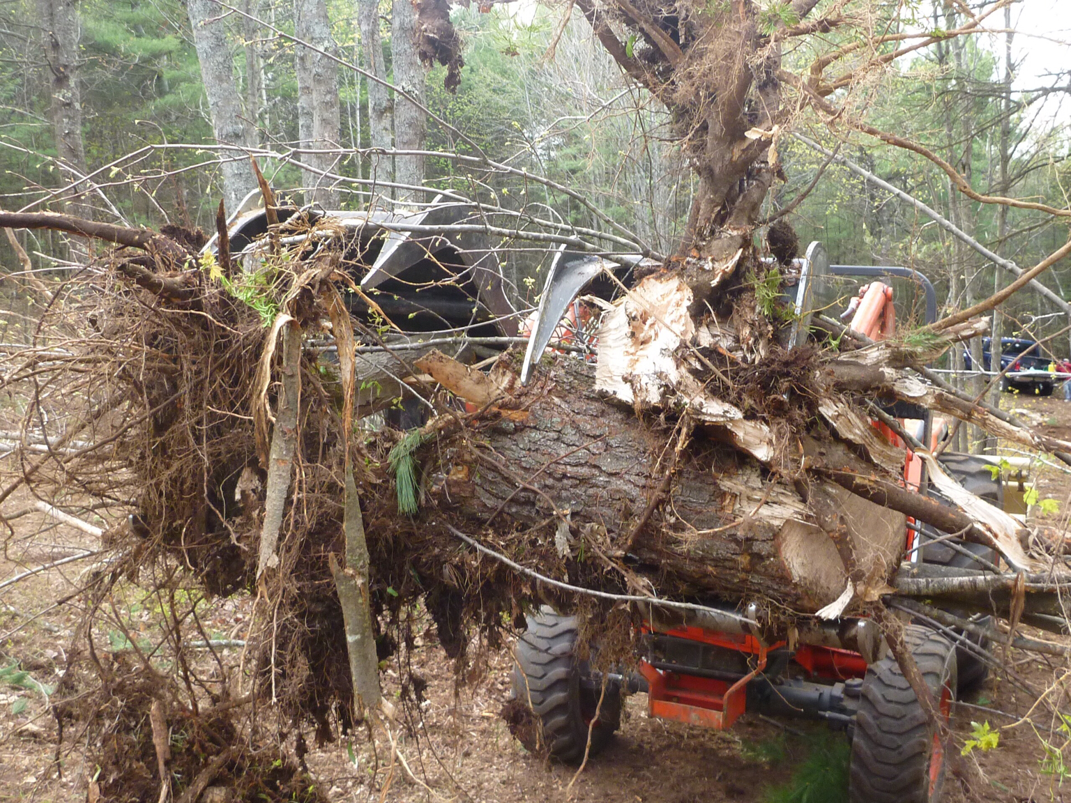

You definitely want to lift heavy objects like rocks/boulders in the middle of the grapple, whether it's a single lid or double lid makes no difference. As mentioned, both sizes/types will work and we all have our preferences.
These images show a few examples of how the double lid can do the same, if not more, than a single lid (or narrower) grapple, but that's not to say that the single lid or narrower grapple couldn't accomplish the same work in more time.

I don't know how wide my grapple is. It's not important. What is important is how well it picks up materials. I went with a double lid grapple because I feel that it holds material better by being able to close differently depending on what I'm picking up. But I'm sure that if I had a single lid bucket, I would adjust and figure out how to get the most out of that too.
Very well said! I also use mine for small scale land clearing, as it looks like you do, and many times I'll carry multiple stumps of different size where the two lids will clamp at vastly different positions, as your photo shows. If I just had the single lid, I'd simply take more trips but there there is nothing it couldn't do that mine can do.

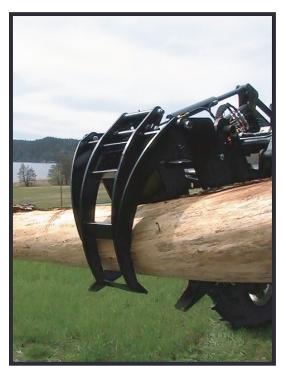

As others have already noted, it really depends on what you want to do with the grapple. My primary use is moving long logs. A secondary use is to clean up brush and slash after logging and firewood harvesting. I need to maneuver in tight quarters in my woods. Driving around with my 66" wide bucket sometimes takes more maneuvering just to get that bucket around trees that I don't want to damage.
I went with a Sundown GR40 forestry grapple (similar to the Frostbite that @fruitcakesa mentioned, though I have to admit, I do like the construction details on the Frostbite a little bit better.) These grapples excel at gripping long logs and holding them securely. To match that gripping in a non-forestry grapple, I'd have had to go with a double lid design. (Some single lid designs will pinch one end of a log, but not grip the other securely, allowing it to swing around.) That's a whole lot more weight and a lot more expense, and I'd lose some of the maneuverability in tight conditions that the forestry grapple allows. The forestry grapple weighs almost the same as the bucket it replaces.
A forestry grapple is more of a specialized implement: It's great for moving long logs and similar long objects. It works well for brush and slash, as long as it it not cut up into really short pieces. It does not do well on small items like firewood cut to 16" lengths or smaller rocks. You can't really "rake" with a forestry grapple. You also lose the ability to carry tools or other supplies which a bucket or some other style grapples allow fairly easily. (I've thought of making a box to carry in my forestry grapple to bring tools and supplies out to the work site, but it's not been enough of a problem to rise to the top of my to-do list. I added a couple of chainsaw carriers to my tractor and a receiver hitch to my logging winch so I can tow a trailer out to the worksite and still have my winch with me.
If I needed to do a lot of other grapple type work, I'd have a different style grapple (or maybe an additional grapple?) However, since very little of my work is out in wide open areas, I would not be at all interested in a grapple that is wider than my tractor (or even one that covers my tracks).

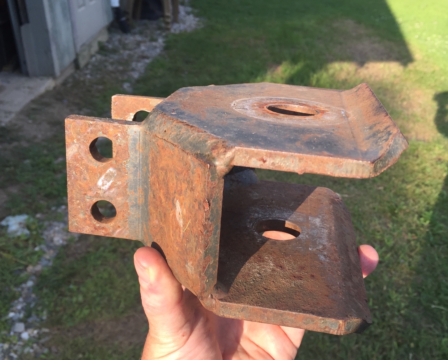

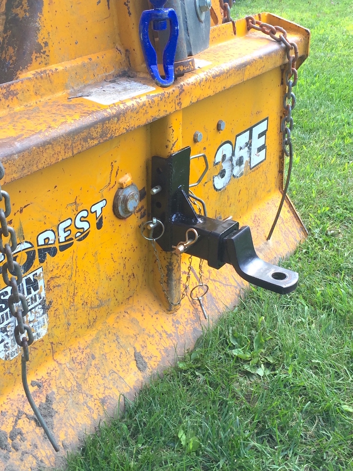

I have a Uniforest 35E logging winch (predecessor to their current 35M model). There is a vertical rib running up the center of the butt plate for this winch. I noticed that their larger winches came with a hitch that bolted on to this rib. I bought one of those hitches, drilled a couple of holes in the rib - mimicking what Uniforest did on their larger hitches and pinned it on, so I could remove it without any tools if it was in the way. (They recommend not having it on there when skidding logs, since it can get banged up by the logs.) This was a pin-type hitch. Here is what it looked like:
I wanted to be able to tow some of my trailers which take a 2" ball, so I had a local fabrication shop make me a receiver using the same sort of attachment method as the factory hitch. I bought the receiver tube from Northern Tool and the fab shop made the rest. (I actually shortened the tube a bit, since I wanted to keep things close in to the back of the winch. If I were doing it again, I'd leave it a bit longer: I have to cut about 3/4" off any insert I put in it, which is a bit of a pain just to tighten things up by 3/4".) Here it is installed:
I had him make the part that goes up against the winch longer and drill some extra holes, so I could adjust the height. I also drilled another hole in the rib, so I could space the pins further apart. I figures that would give a bit more strength/stability. It's shown in the picture above in a higher position. As it turns out, I always run it in its lowest setting. That allows me to raise the winch up higher to clear waterbars and other obstacles without also raising the front of the trailer too high.
I've also seen people add a receiver to a winch that does not have that center rib. They found a place in the butt plate of their winch to cut a hole that would not interfere with the winch mechanism, then welded the tube in to the hole (That's stronger than just butt-welding the receiver tube on to the winch.) I can't recall if they also added extra support gussets or not.

No center rib on my winch and like you, I am concerned about a butt welded receiver getting abused by logs. Cutting a hole and recessing the receiver is probably how I would have to do it.
/ Sizing attachments (FEL) #19
The one I saw welded in still stuck out just enough to get the pin in from the rear side of the winch. Different heights might avoid the logs better as well? I did not want to go really high and then have to use an insert with a big drop. I figured that long drop was also a long lever and would put more strain on the system.
Logs hitting the empty receiver does not seem to be too bad of a problem when the insert is removed. I've forgotten to take mine off a couple of times, and not had any problems with it getting damaged. However, I don't do a whole lot of skidding. I generally winch the logs out of the woods to the side of the trail, then pick them up with my forwarding trailer or if they are firewood I cut them up right by the side of the trail.
