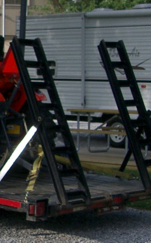

I built mine 5' long with 2" c channel & 1 1/2" x 1 1/2 " 1/4 " angle. I haven't loaded any thing much heavier than a car or my ck 20 but htey are standing up very well.

My current ramps are just loose like your neighbor's. The weight is an issue but also the spacing gaps between the rungs.
I got the dimensions today. They are 5' long, with each side being a 2x3 x 1/4" angle. The rungs are 2x2 x 1/8" or 3/16" (I already forgot) angle spaced every 8". I think they would support 4000-5000 lbs each. The weakest spot is probably the angle at the top end that sets onto the trailer bracket.
I'm getting the idea of 2x2 x 1/4" angle sides and 1x1 angle rungs spaced closer than 8".
An alternative would be to make ramps that look like sections of mesh gate. Each one would need 3 pieces of square tubing running lengthwise, covered by mesh. One for each side and one right in the middle. With 3 tubes positioned that close together, they would not have to be huge, I don't think.
