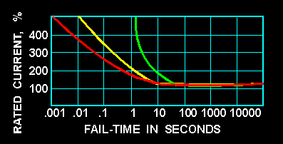

Here's yet another bit of fuel to add to the confusion fire.
A fuse does not "blow" instantaneously at its rated value.
For instance, a 10 amp fuse with 10 amps of current flowing through it might last for several minutes, maybe even an hour before it fails. As the current overload increases, the "fail-time" decreases. A 20 amp current draw might cause the fuse to blow in a second. A 40 amp overload might blow the fuse in 0.1 second.
I've attached a generic pic showing the fail-time vs. % overload for three different types of fuses. The green line might represent a "slo-blo" type where the red line would represent a "fast-blo" type.
Therefore, if the fuse is being used to protect the device, a lot of information is needed as to what current is "excessive" and then a fuse with the correct "fail-time" and current rating needs to be selected.
Is everyone confused now?
