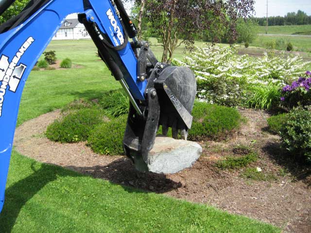

Yeah, it's kind of an "interesting but moot" point. It is what it is. One could imagine situations where one or the other configuration might have benefits over the other, but there is little sense in messing with the excellent, powerful Bradco factory design. :)
Dougster

I believe (hope? pray?) that is a note just copied over from an engineering drawing. Look at the price structure and model numbers scheme. I don't think they just throw those end fittings into the box for the end user to attach... not at that price... and not with an 8 to 10 week lead time. Couldn't get hold of the local distributor to confirm this, but I'll try again tomorrow.
In the meantime, that genuine Bradco cylinder cost is looking more and more attractive in the context of total installed cost. Sure wish I knew the pressure rating and/or cylinder thickness of that beast. I'm thinking that the Bradco cylinder may be more beefy and better suited to installation in a location that can see some pretty rough action at times. :cool:

Yeah, I am having a tough time getting local hydraulic parts dealers to take on my plight. I did find a dealer up in New Hampshire that would order the Prince Wizard to my exact specs for $211 plus shipping... but the killer is still that 8-week delivery time and the guy is less than thrilled about the nuisance of putting in my mini-order. :eek: I found some cylinders that could be modified for cheap bucks (to buy, not modify) on eBay... but none in my preferred 2.75" diameter. Meant to talk to a machine shop guy a couple towns over about doing the mods to make it fit, but haven't been able to get over there this week or last.
Meanwhile, it's looking more and more like buying the Bradco hydraulic cylinder kit (Keyword: "kit"... Part No. 16609) makes the most sense since I can get a small discount off the ~$500.00 list price and I'm being assured by the local dealers that the "kit" price includes those super-costly (supposedly super-hardened) 1-1/4" pins.

Best price on the kit was from Woodbury Tractor in Connecticut... but when I say "small discount"... I'm talking just enough to cover CT sales tax and shipping. It's gonna end up ~$500 give or take... but at least I'll get those 1-1/4" gold-plated pins! :D
And yes, the Prince Wizard 2-3/4" for $211.00 is the same as your alternative with those 1" pins. Same with the 3" and 2-1/2" eBay bargain cylinders: 1" pins. Not sure I trust a 1" pin with bushings given that Bradco seems to feel they need those 1-1/4" super-ultra-hardened pins... but that's a whole 'nother story. :eek:
