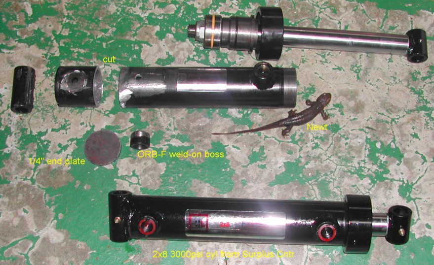

dfkrug said:
Dougster: Try Item# 9-7336 from Surplus Center. $99.95 + shipping. You will have to shorten it, but that is not bad. You can do the
cutting and take it to a welder and maybe get away for $100 for the welds. SC has other choices, too. 2.75" bore will limit your choices somewhat. I never find exactly the size of cyl I want. I either design around what I buy or modify it to suit.
The price is certainly right, but I was hoping to get a little closer than that. ;) Are base ends easy to change? I know they are on some... but on all? No problem on the rod end.
If it means going to a 3" cylinder, I've have to recheck clearances very, very carefully and get a relief valve for sure. On the other hand, 2.5" just doesn't have enough force. :( It would be a joke.
Anyway, thanks very much for checking! :)

12,300lb is not enough force? That's at the rod end for 2500psi press.
Tie-rod cyls are very easy to change....no welding of the cyl or
port bosses.
Welded cyl sshould generally be similar. The photo I posted shows the
cut to reduce length by 2". I needed different ends anyway.

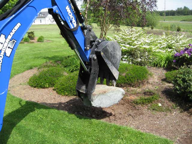

Dougster,
If I have my thumb extended and close my bucket I can push the thumb back, likewise if I extend the thumb into the bucket I can push the bucket back........and if I want to try to push the noodle with both simutaneously these just turn that mean ol noodle into spaghetti :D without either side gaining ground. I surmise that's what you're trying to emulate.

MadDogDriver said:
Dougster, If I have my thumb extended and close my bucket I can push the thumb back, likewise if I extend the thumb into the bucket I can push the bucket back........and if I want to try to push the noodle with both simutaneously these just turn that mean ol noodle into spaghetti :D without either side gaining ground. I surmise that's what you're trying to emulate.
Good photo... very similar in geometry to the Bradco! :)
I'm just trying to convert my fixed thumb to a hydraulic so that a) It will rattle less, b) No getting off the seat to set it up, and c) because hydraulic thumbs are the cat's meow! :cool:
I just don't want to lose excessive gripping force while doing so. Simple as that. :)

MadDogDriver said:
Dougster,
Based on your description, Woods must have designed for similar
net forces applied by the thumb and bkt, then added a relief
valve to each circuit so they would retract under opposing pressure.
Otherwise opposing pressure would have exceeded the pressure
limits of the cylinders. I find it a bit surprising that the thumb can
push the bkt back. I wonder what pressures they are seeing.....
They also may have INTENDED the user to be able to push either
back by the other so he could position his load. The problem I see
here is only if a relief in the bkt circuit is set lower than max press,
which limits your digging capability. A tradeoff.
Based on what I think Dougster is trying to do, I think he should
get a 2.75" cyl so he can maximize forces without needing a relief
valve.
