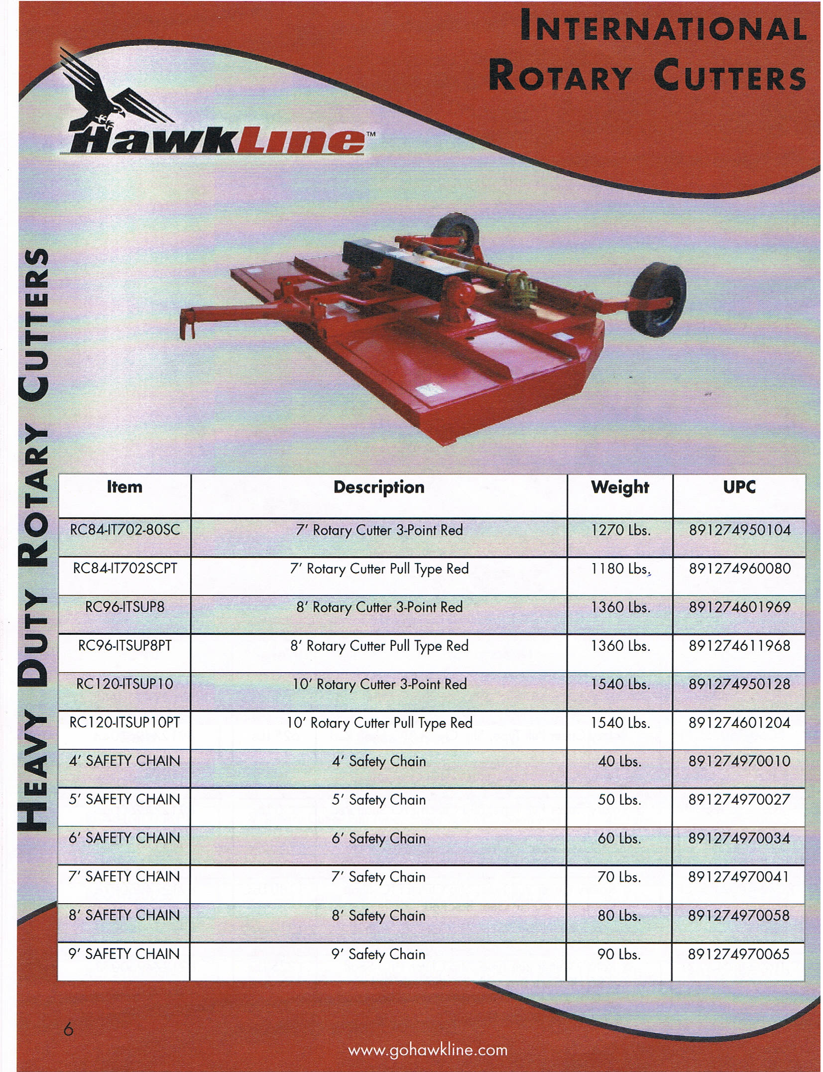

We sell dual spindle cutters and single spindle type of cutters. Only use dual spindle, if you need that extra cutting width. They have 3 gearboxes on them and also connections between the outboard and center drivebox to maintain. The single spindle 7 or 8 ft is a lot less expensive to maintain and cost less. Ken Sweet
