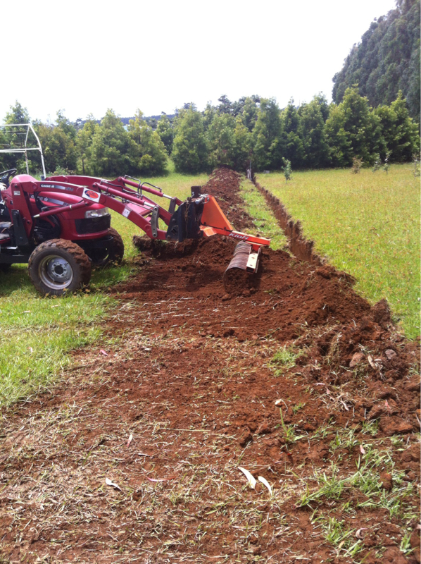

A number of us have adapted a 3 pt quick hitch to a quick attach plate. As you see in my pic, this makes mounting a rake very convenience. I suspect a 3 pt blade would mount as well (I don't have one).
David Sent from my iPad using TractorByNet
