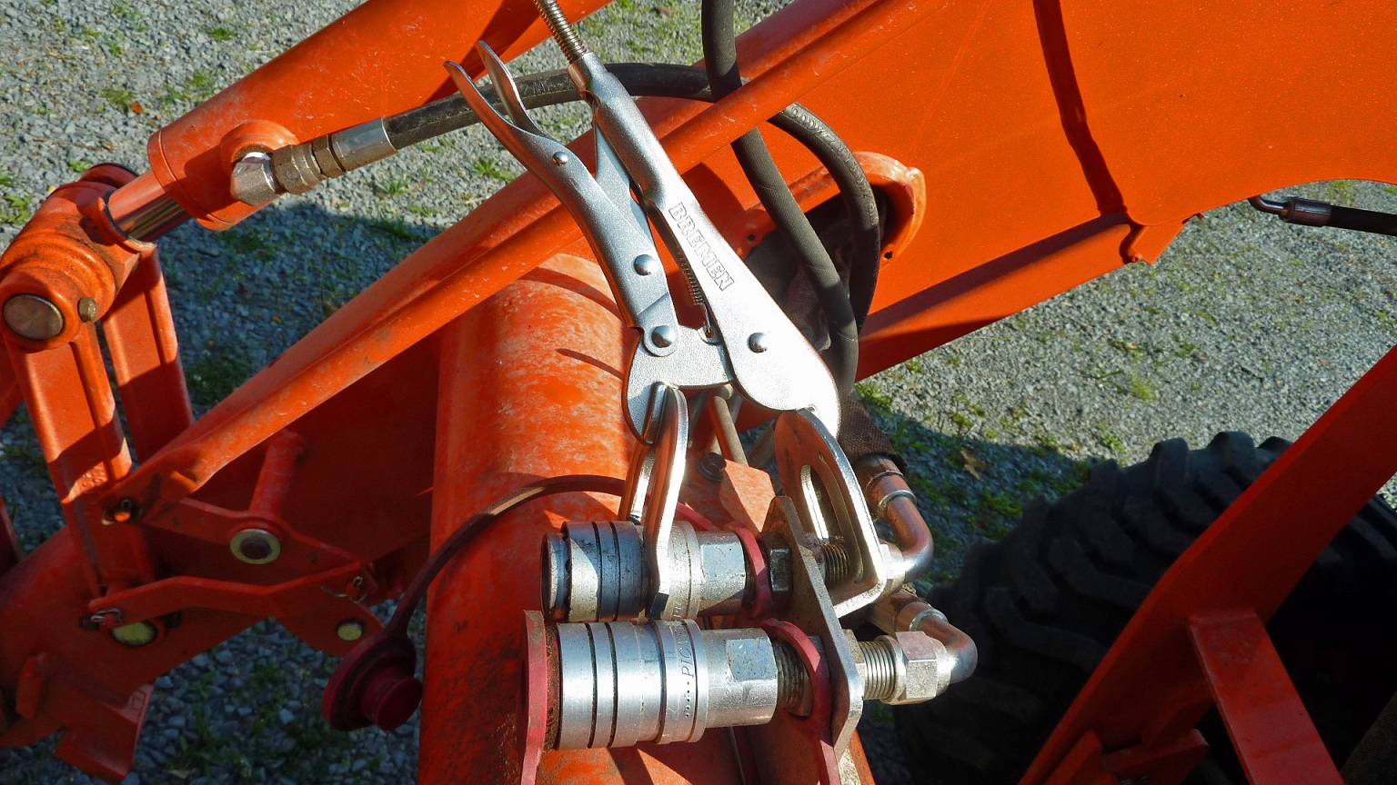

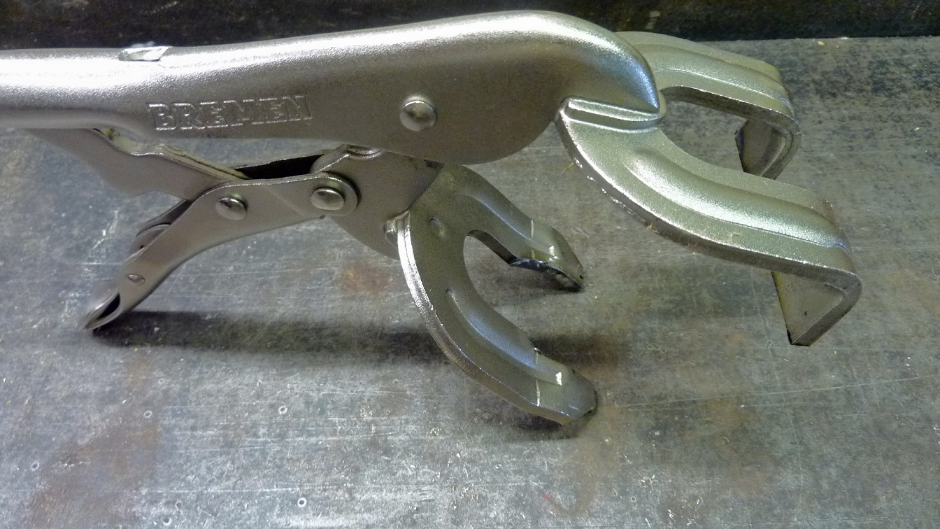

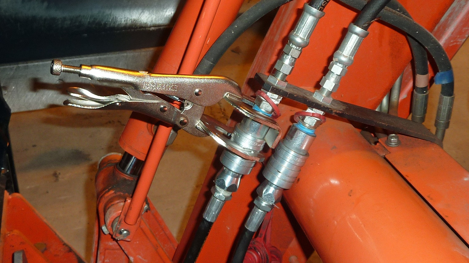

I'm not getting any younger and with some arthritis in my hands, I made up this tool for opening hydraulic couplers from a Vice Grip welding clamp:
It took about 10 minutes with a grinder to open the jaws to fit my 1 3/8" Pioneer couplers.
I'm sure this isn't anything new here but since the tool is on sale at Harbor Freight for $10 thru 8/19, I thought I'd post it again.
View attachment 709274 View attachment 709275 View attachment 709276

Great idea. I'll bet it was a HF grinder too!
I used my 6" cordless DeWalt grinder. It took a full battery to do the job. It would have taken longer but the Chinese aren't that good at hardening their tool steel.

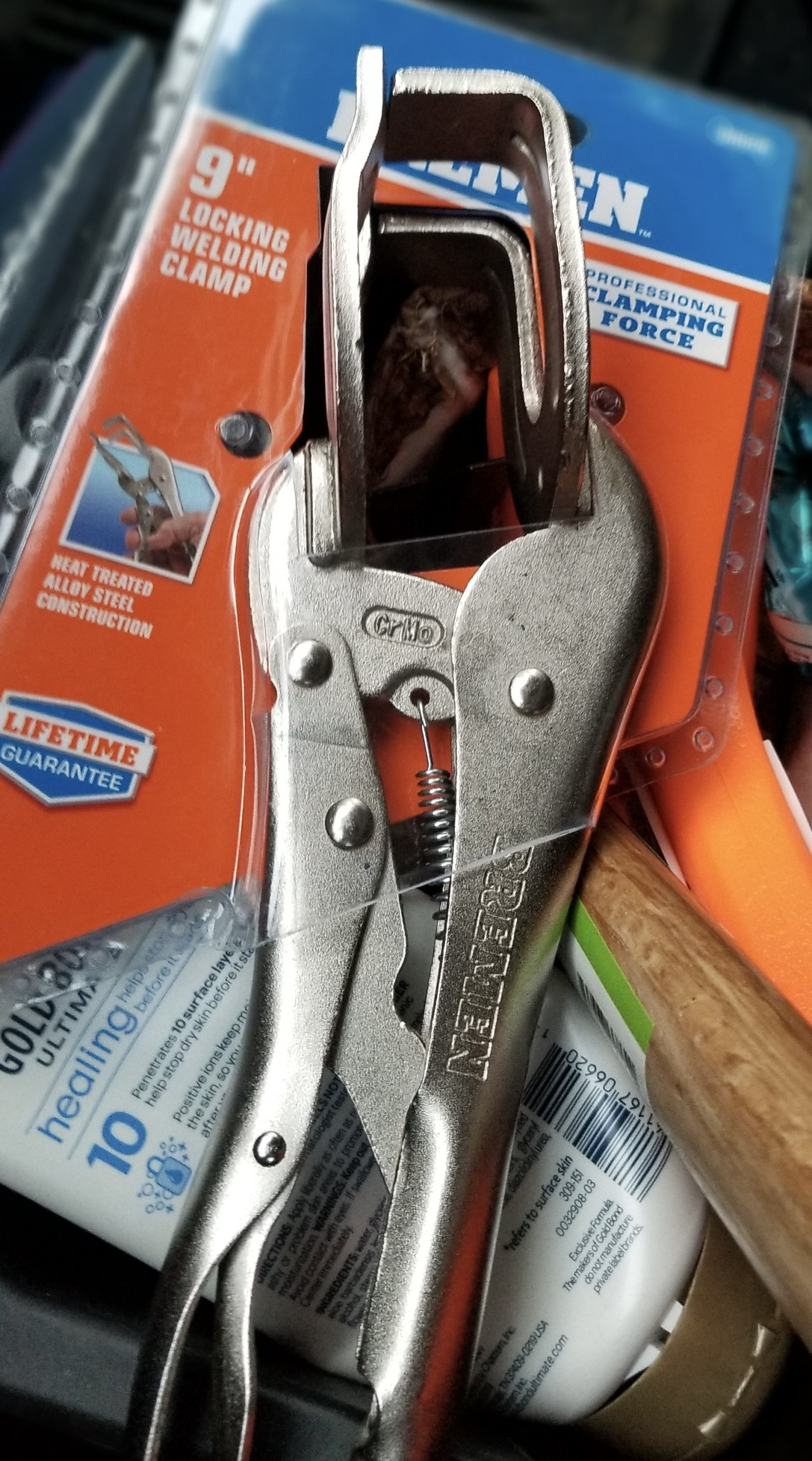

/ Simple Tool For Operating Hydraulic Couplers #10
