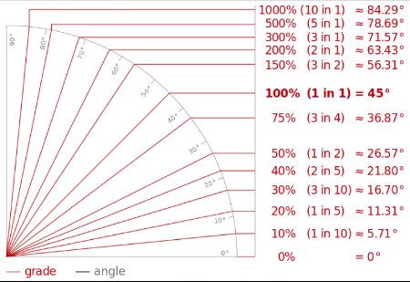

I am an experienced tractor operator and I use my machines to mow 3/1 slope which I mow on the sidehill and not up and down.
I am hoping you mean a "1/3 slope" not "3/1" (see chart below). If not, you have my respect, sir!
   / Sidehills with a cab vs without #22
Interesting chart. I don't understand the measurement. Like 1/3 of what? Why not just go by degrees?
   / Sidehills with a cab vs without #23
I believe that it is the same measurement of length whether it be inches feet miles millimeters or what ever 1 inch of fall in 3 inches of run, or 1 foot fall in 3 foot of run, 1 in 1 would be 45 degrees or 100% slope
   / Sidehills with a cab vs without #24
Is it a case of it being easier to determine slope with a level and ruler?
Are these the same measurements seen on the sides of steam engines?
   / Sidehills with a cab vs without #25
Yeah for us "not math geniuses" it can be confusing. This chart offers three different ways to "name" the same slope:
Degrees are just like on a protractor, or if you're a carpenter: "flat" is 0 degrees, "halfway up" is 45 degrees, and perpendicular to the ground is 90 degrees
1 in 10 means for every 10 feet you travel, the ground rises 1 foot. "1/3" or 1 in 3, means for every 3 feet it rises one foot. "3/1" means for every 1 foot you travel the ground rises 3 feet; steep!!!
Percent is just the "1 in 10" or whatever expressed as a percentage. 1 is 10 percent of 10.
Took me a while to figure this out, and I hope I have it right. :) Agree, why not just pick one system!

1/3 is rise over run, same as tangent of the angle...so arctan .33333, or 18.43 degrees (.322 radians). Roof pitches are done the same way. I prefer degrees over percent or pitch (ratio); just my personal visualization bias.

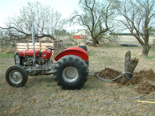

I'd get rear tires like the one on my 1964 MF135 diesel---18.4 x 16 (16" dia rims) and load them with whatever fluid is appropriate for your winter climate.
Good luck and be careful out there.
