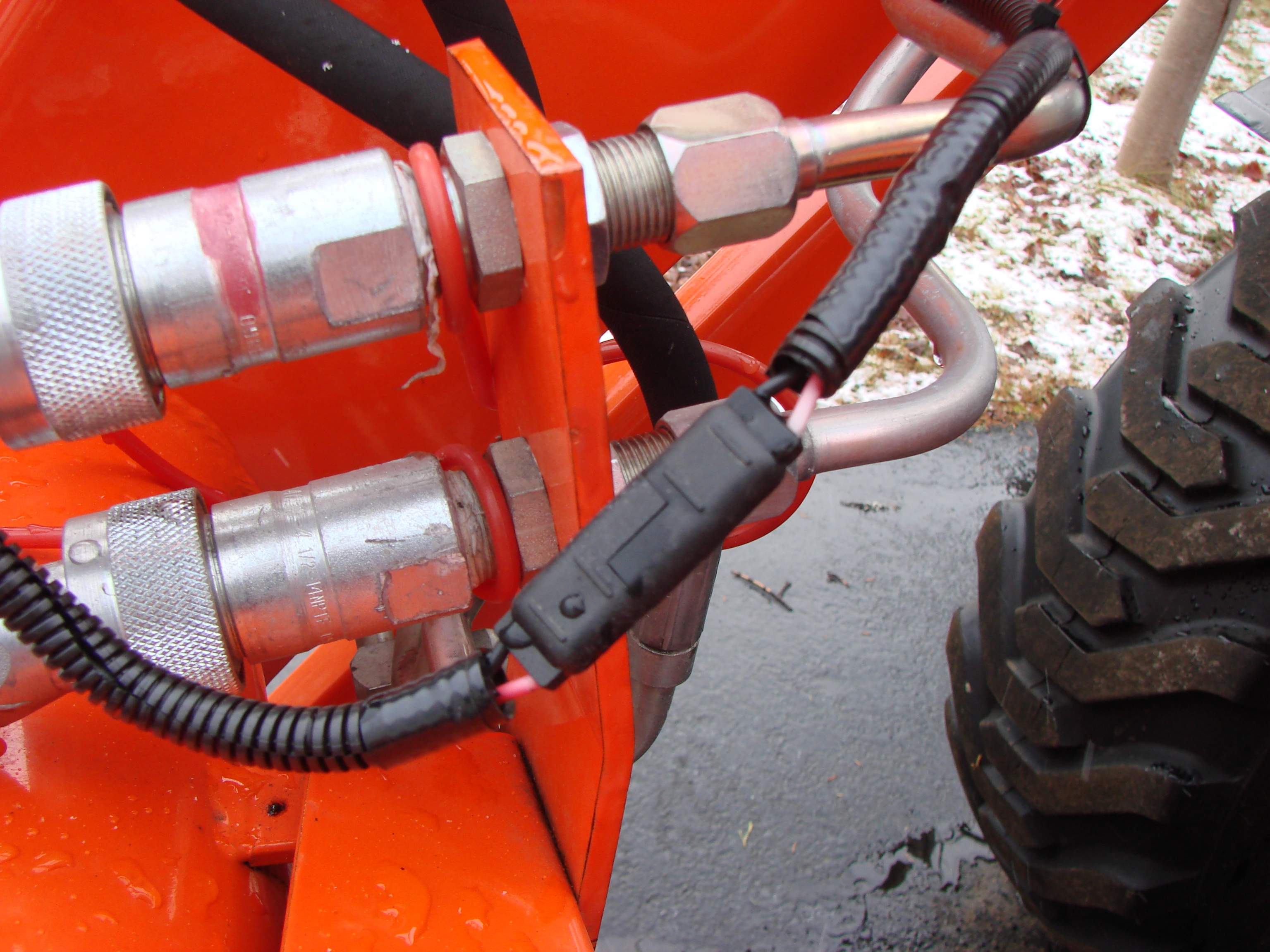

When I did the install I also put a pull connector at the quick release and one up by the FEL so if I need to disconnect it's still easy to do./QUOTE]
Paul,
Would you mind posting a few pics that highlight the wiring you did for these lights? Also, any additional info would be great such as are they always hot, did you add a switch, etc.
Thanks a ton!

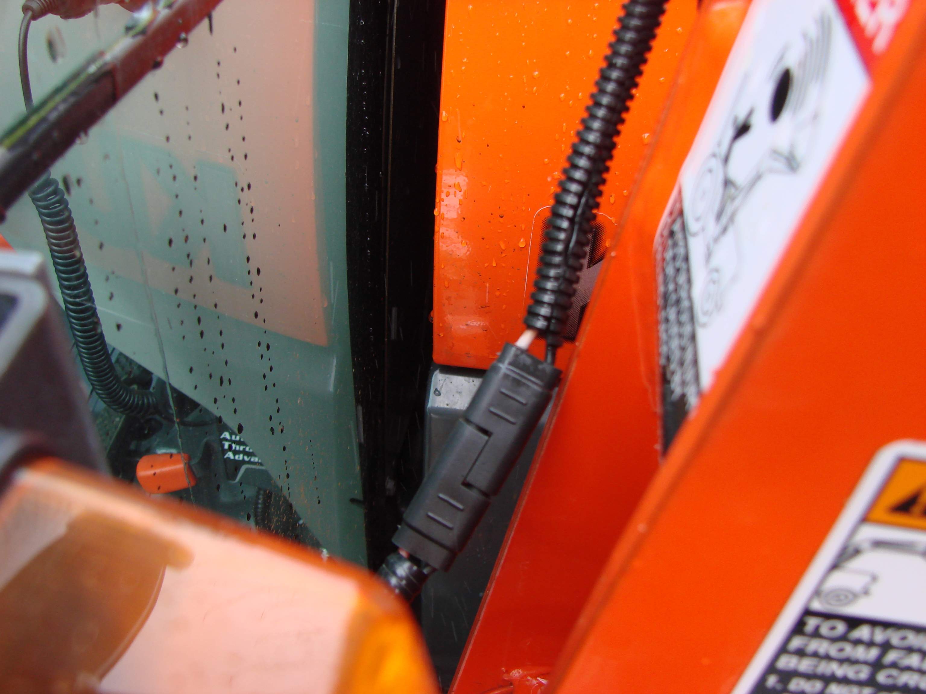

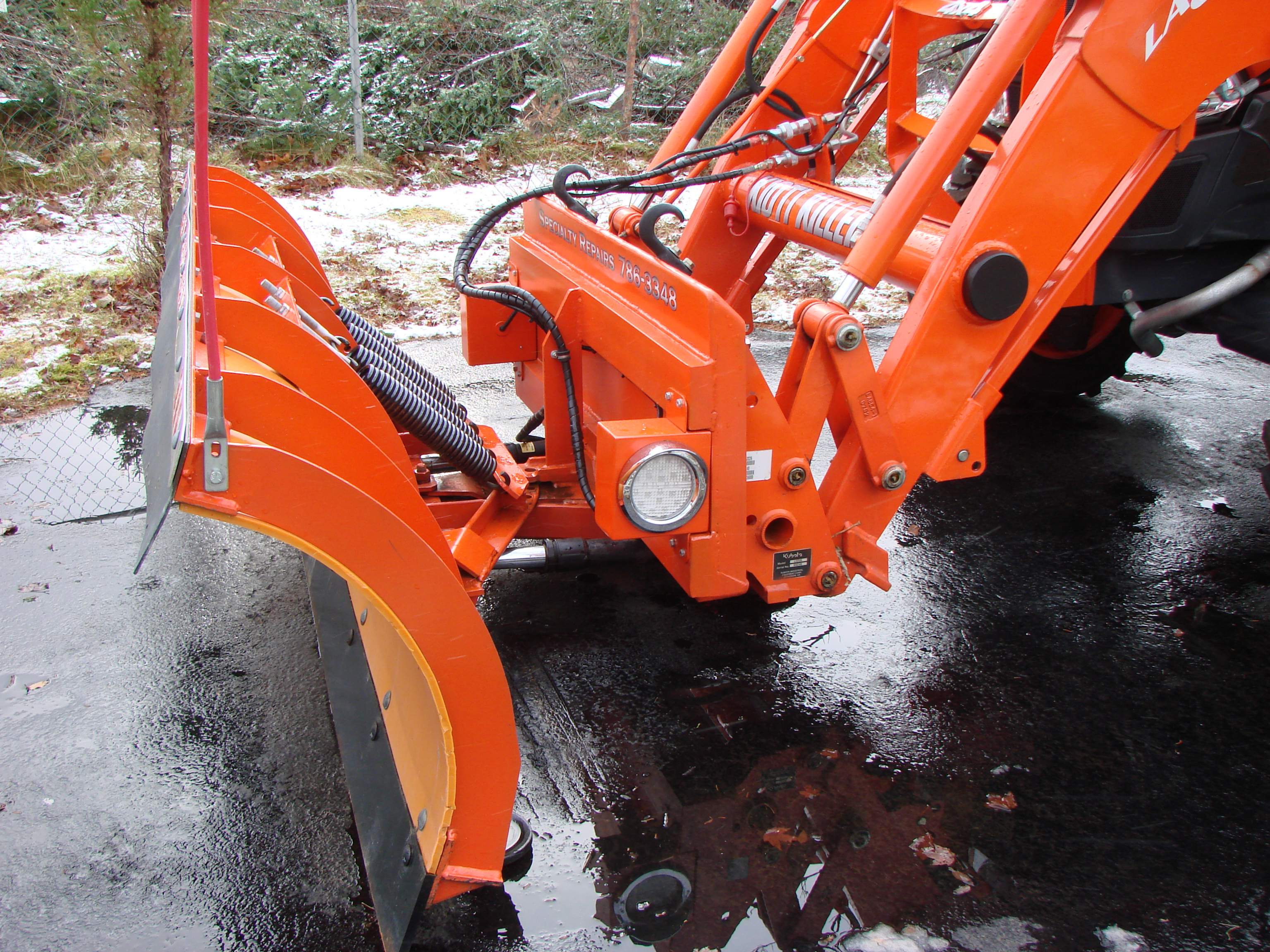

Not a problem my buddy. I just snapped a few pics for you. As you can see I put a two cavity connector down by the skid steer attachment and the other one is up on the right side of the FEL. If I need to disconnect these two items I simply just unplug the harness. The power source for the plow strobes are supplied via the running lights/signal light. I just ran the wiring right to the light. The LED's use so little power it's the perfect place to hook into and avoiding running the wiring to the inside of the cab. . Hope this helps and if you have any questions feel free to ask. Paul

4short, you could add the LED wips in place of those blade edge markers i see in your picture. I know its not practical but since youve got power already down to the snow blade it wouldnt be too much trouble to power the wips eather.

I thought about adding those whip lights but after looking into it I thought the extra wires would clutter the look of the blade. I may have to revisit it and see if I can conceal the wires. I think there a good idea.
