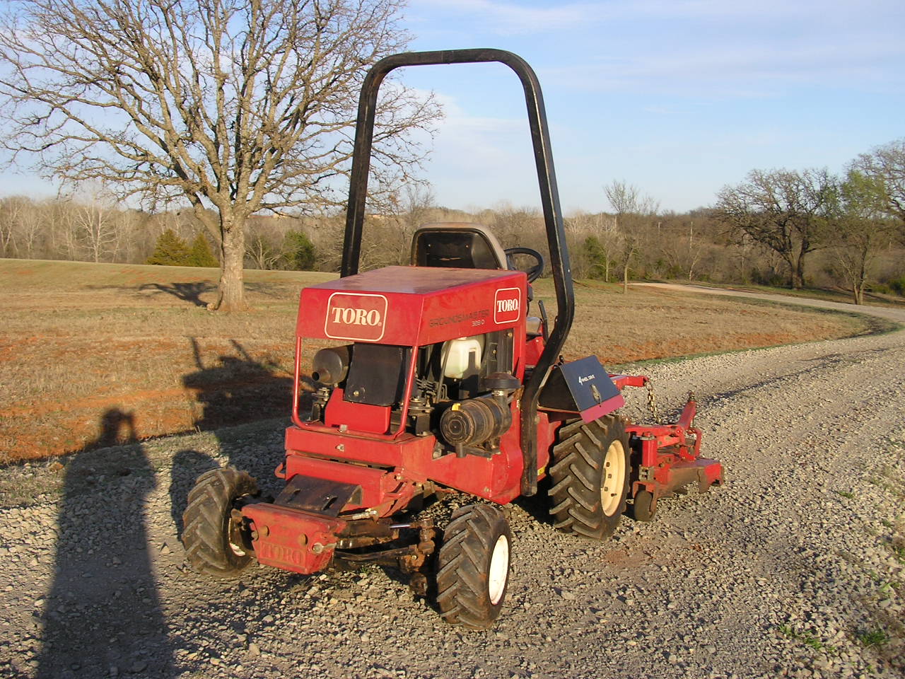

Mowed it today. After taking FEL off and slowly traversing it, tractor never felt "tippy". At the worst part it seemed the tractor may want have a slight tendency to slide rather than tip.
That is one thing I noticed after I sold my tractor that had ag tires, the R4 industrial tread tires would slip sideways on the same sidehills where the R1 ag tires kept going straight.
   / Side slope mowing tips wanted #33
I'm watching for some weights that I can add underneath the center eventually. Thanks for all the information. It's nice to actually know it can be done.
View attachment 467767View attachment 467768
With stock width, on 30* parts, I'd make sure to have the ROPS up (I've actually never folded mine down) and seat belt on.....it can't be far from the tipping point, I would guess.
I'd forgo the weight and spend that money on wheel spacers.
