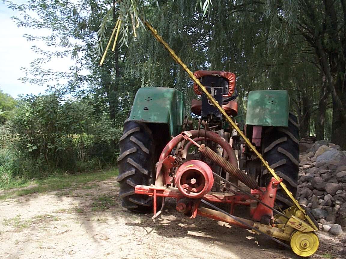

A sickle mower will not like cutting saplings. But I guess if you can get them cut and then keep them cut low it'll handle the job. A sickle mower that is belt driven is great for cutting road banks where the slope angle varies. That's what mine gets used for. Or cutting along a waterline of a pond/lake. My Flail trails behind me. But it leaves the best looking cut.

We used sickle bar mowers to cut hay back in the 60's-70's growing up on the farm. Lord help the one of us that used one to cut brush or small sapplings. That would get Dad's leather strop off the nail hook and warmed up on our backside.
Either an offset flail, or an offset rotary should do the trick.
The sickle bar style mower just isn't robust enough for that kind of steady use.

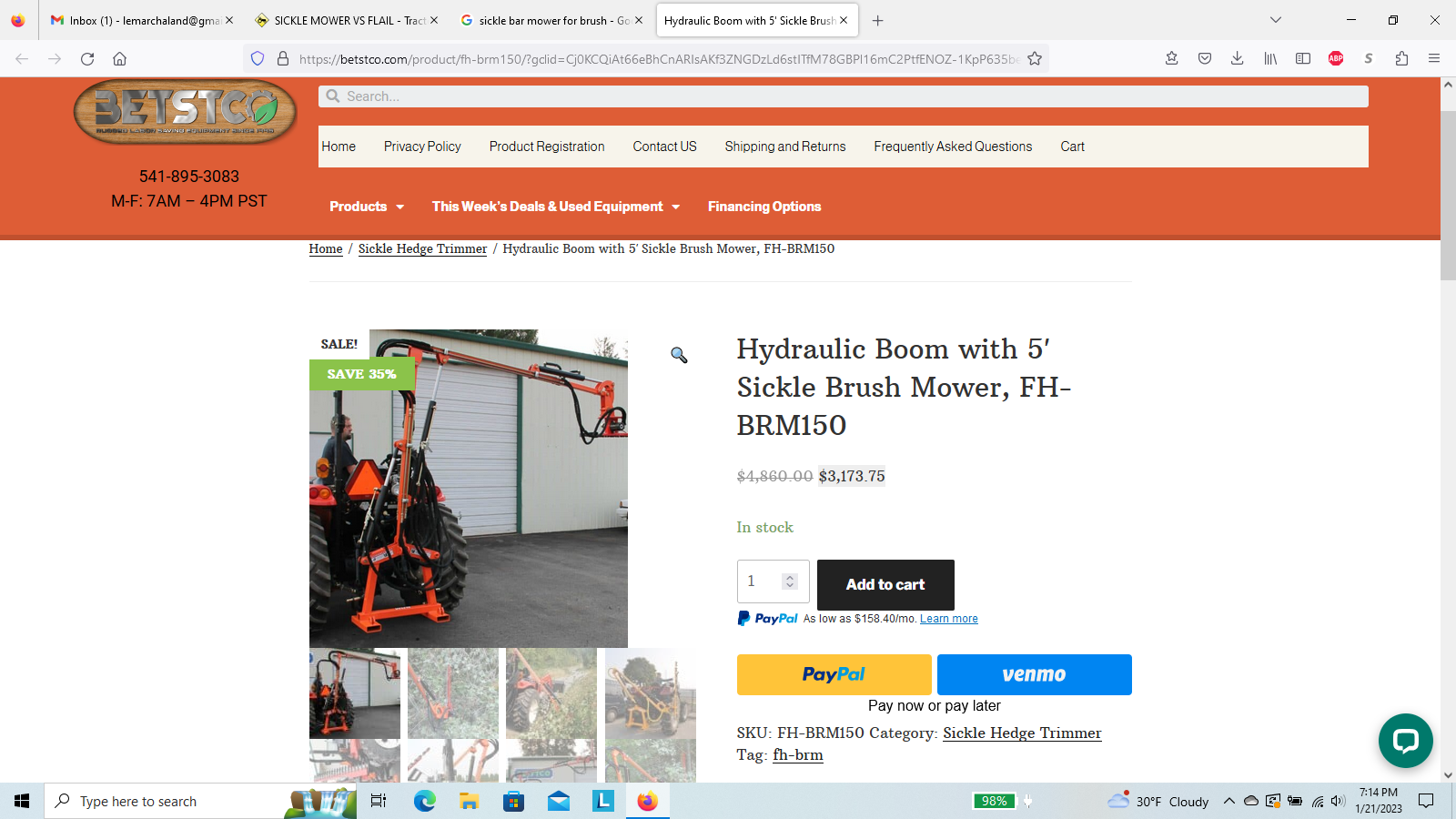

Depending on the size of the saplings I would not be afraid to use a sickle mower.
One inch and under green saplings and brush and briars the sickle would have no problem with
and it is much lighter then a flail.
Here is a suggestion it is chinese made;
We haven't used our sickle bar mowers for hay for many years, they do get used for fence line and roadside triming.
