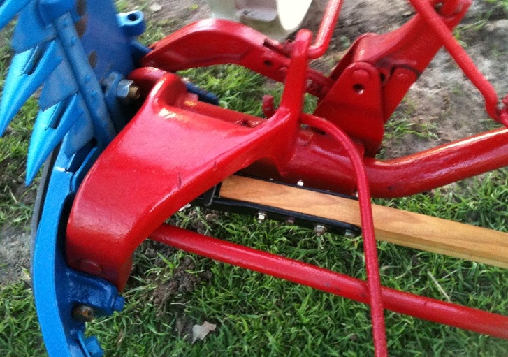

I bought an old belt-drive MF 31 sicklebar mower (not a pitman drive) at auction for $550 a few years ago and put about $200 in new parts into it. Rebuilt it several times. Still not perfect (clogs, narrow uncut strips, etc). Don't see any problem adding a hydraulic ram for the cutter bar. YOu can get the usual wear parts (sickle sections, etc) at Tractor Supply. Bearings might be a problem to locate and remove/install.
Good luck.
