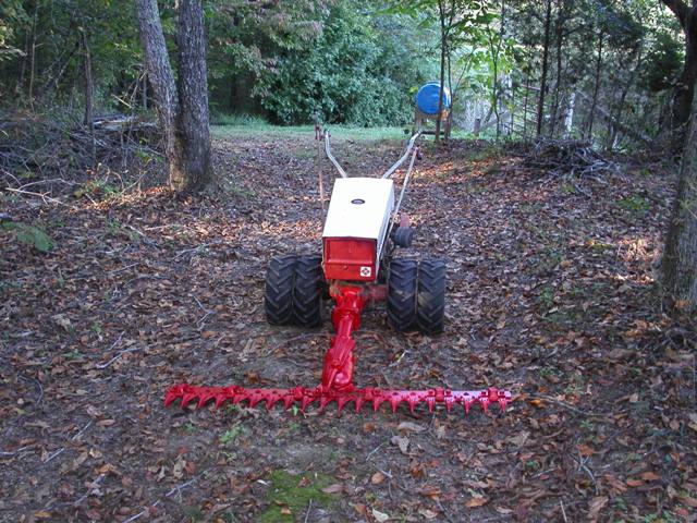

I got this handy little sickle for my Gravely. Great for fencerows!

Hey, where's the seat on that thing!!! :) Sorry, had to tease you about that. Sweet looking outfit!!!
