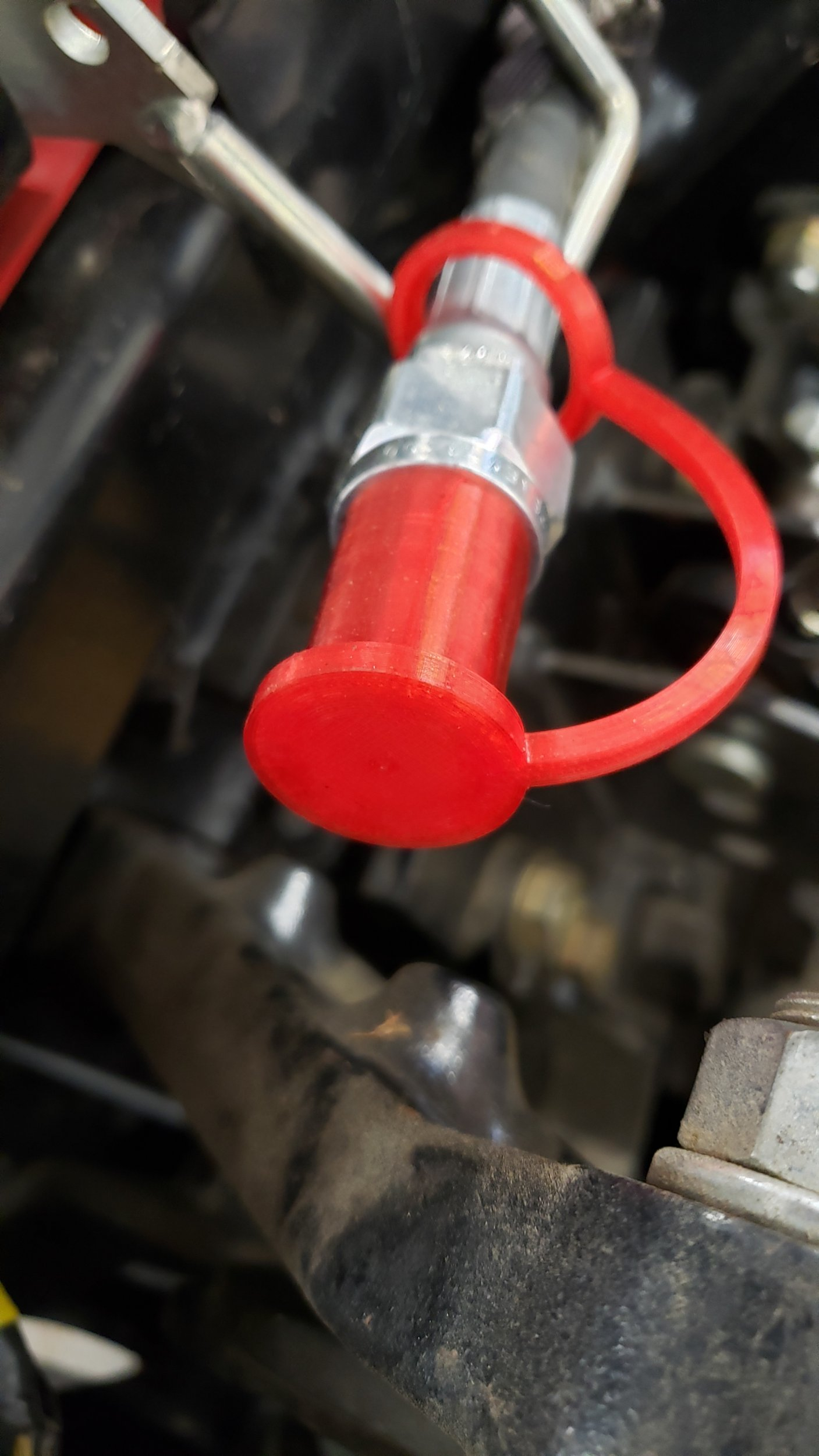

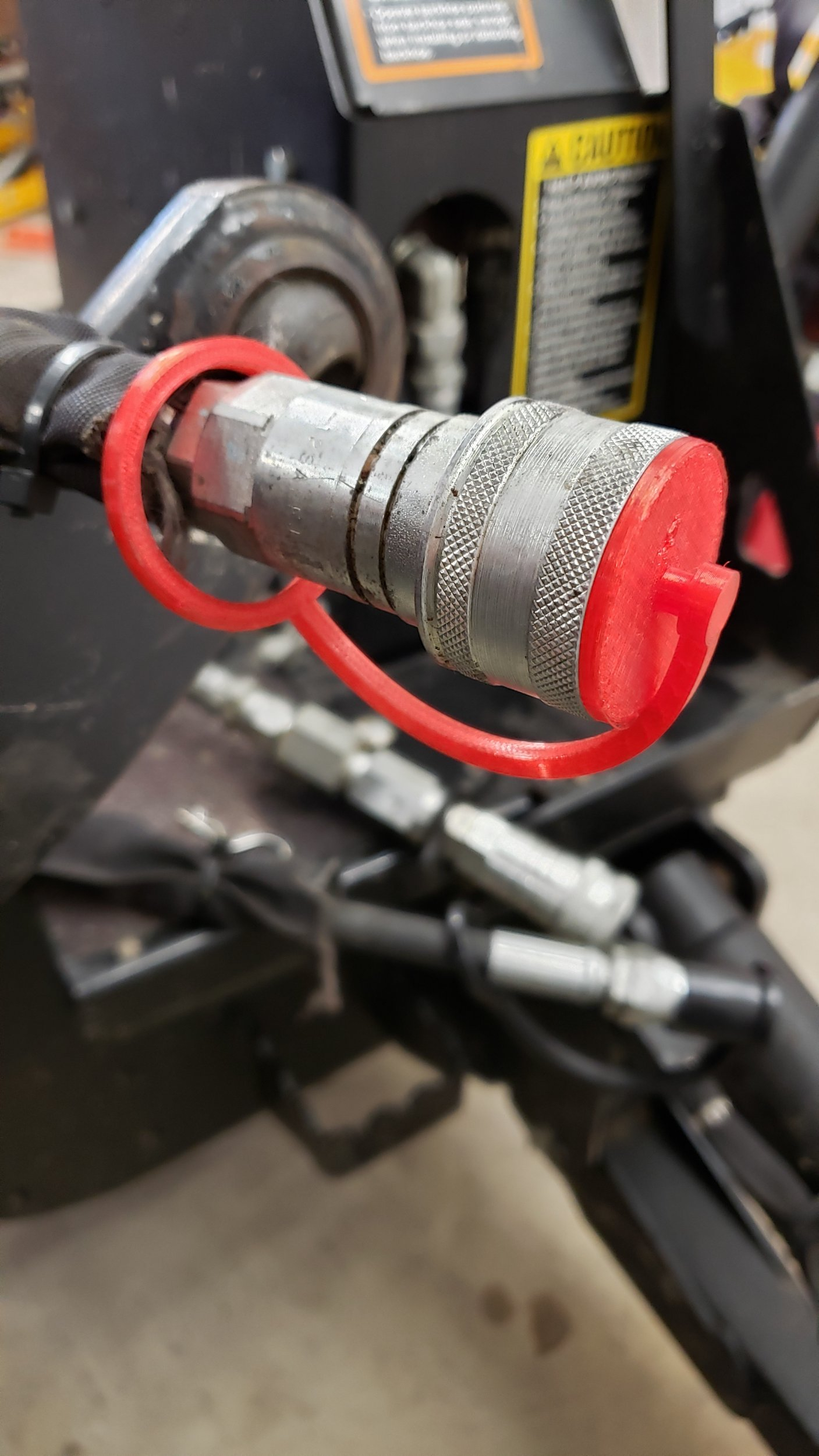

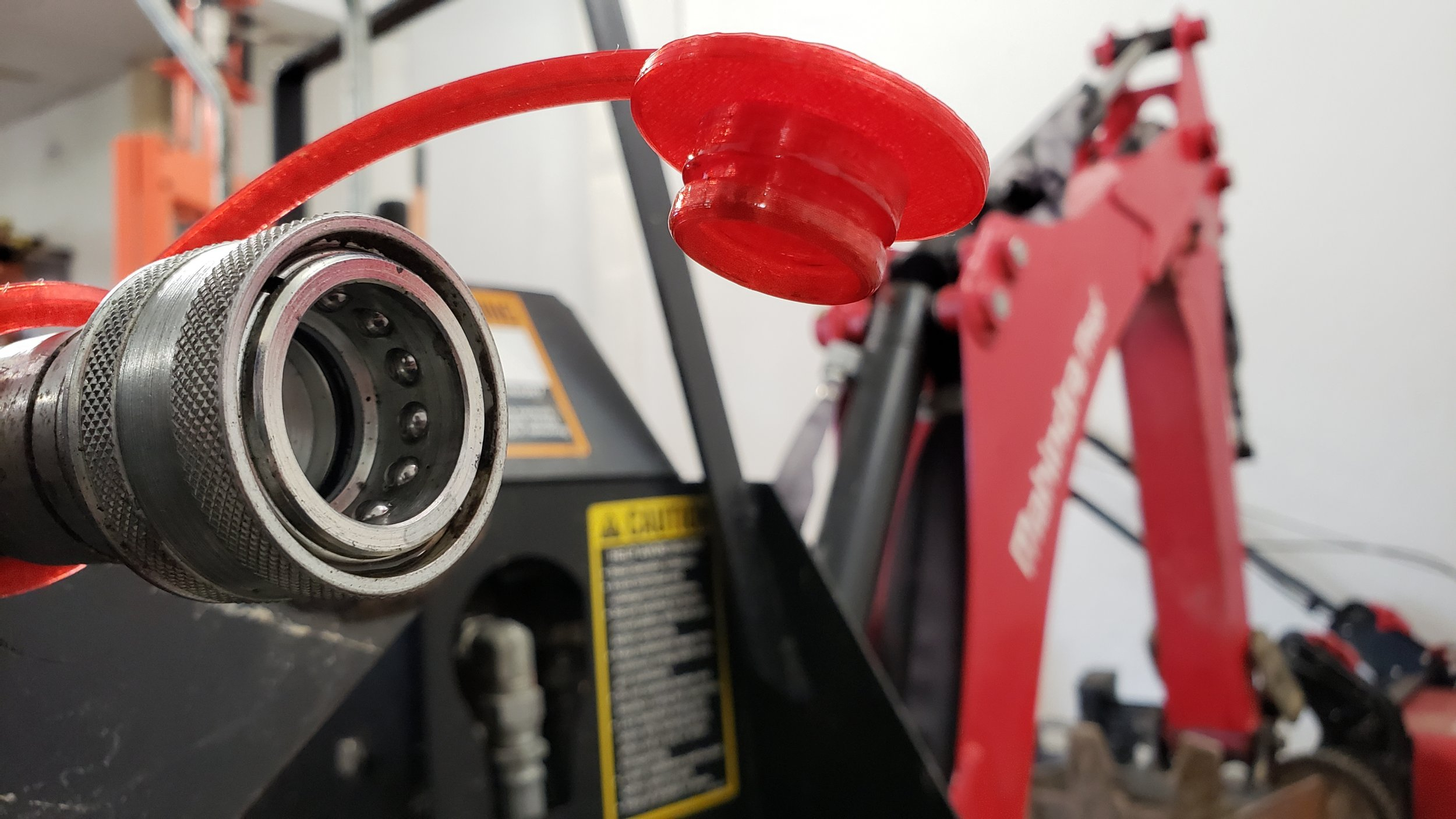

All of my dust covers were ripped or removed from my mahindra backhoe /3pt. and they are ALL different sizes, plus some of them appear to be like 13-14 bucks a piece for a 3 cent piece of rubber.
So I made my own. and they came out pretty decent. Thought some of you might get a kick out of this.
View attachment 696368View attachment 696367View attachment 696366
Can you share the .stl file or ID if it is on Thingiverse?
