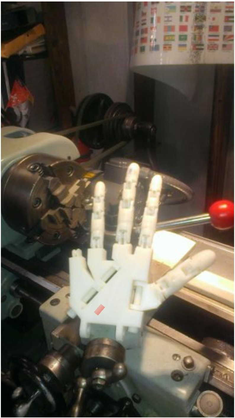

I got into 3D printing in 2013, with a bold and naive plan to build a 3D printed prosthetic hand for my dad and make it open source because bespoke prosthetics are incredibly expensive and not universally available. I quickly learned that 3D printing was not up to the task. Nobody then, and (my impression) nobody now, was interested in performing collaborative repeatable and qantifiable strength testing to come up with best practices to make functional parts. Everyone was content to print chess rooks and smash them in a vise saying "wow I got 3 good handle cranks out of that one before it exploded. Very strong part!" It's disappointing that little progress has been made on this front. I developed a test object and a testing procedure that I hoped could unify at least some small corner of the 3D printing community and get a few people going the same direction toward strong parts. There was zero interest.
Anyway, here's a sample of what my unending failures looked like; something suitable only for Mr. Glass:
So I abandoned 3D printing and went after CNC milling. The prosthetic hand project fizzled out after a few years, not because i lost interest but because my dad did. Well, maybe I did too a bit, but mainly because I could tell he wasn't crazy about it. He went without a hand for 40 years and was pretty used to it. But, I still wanted a CNC mill so eventually I saved up enough to get one. I'm quite happy with it and only rarely do I clear the pile of debris off my 3D printer and put it to work. Every time I do, I have to put my filaments in the oven overnight because they sit so long.
3D printing is fun and exciting, and the cost of admission has come down so far that I would encourage almost anyone to give it a shot. But with a realistic understanding of its limitations. I am glad to see that you found a practical thing to make. Sadly, ideas for things like that no longer come to me as the 3D printing thought process has all but left the building.

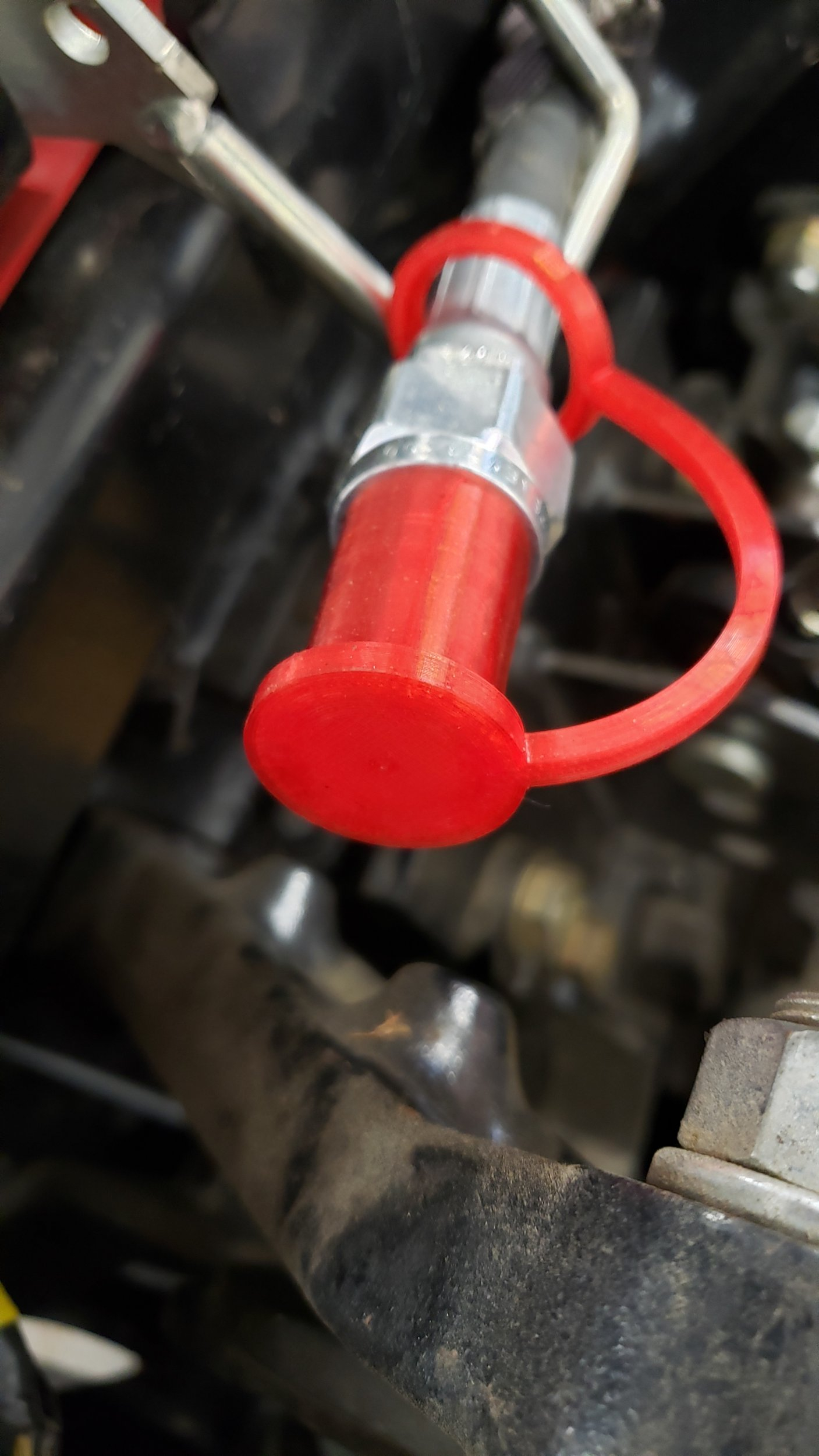

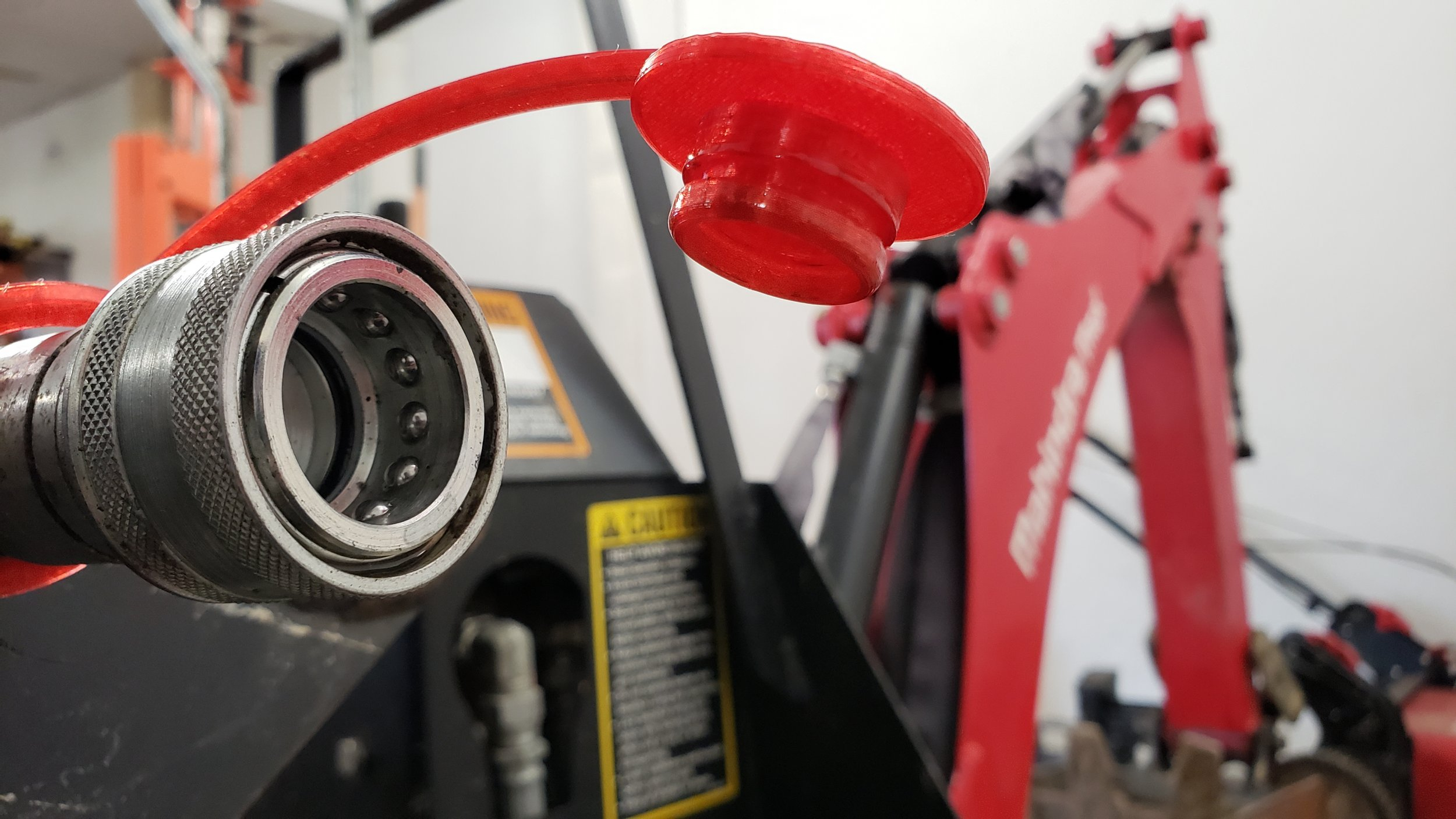

@LittleBill21, What filament did you use for the caps in the OP (5 pages ago!)? They look nice and flexible. My PLA prints are all brittle.

Awesome job. I love designing and printing replacement parts. Did you use a flexible filament? What type did you use? I have had great luck with TPU from Sain Smart. I'm amazed at how flexible yet strong the prints come out.

I bought a 3d printer out of interest, and for a specific project. Coming to find out I have a million uses for this thing.
All of my dust covers were ripped or removed from my mahindra backhoe /3pt. and they are ALL different sizes, plus some of them appear to be like 13-14 bucks a piece for a 3 cent piece of rubber.
So I made my own. and they came out pretty decent. Thought some of you might get a kick out of this.
View attachment 696368View attachment 696367View attachment 696366
Those look great! None of the ridges and artifacts that used to plague 3D printed stuff in the past.
