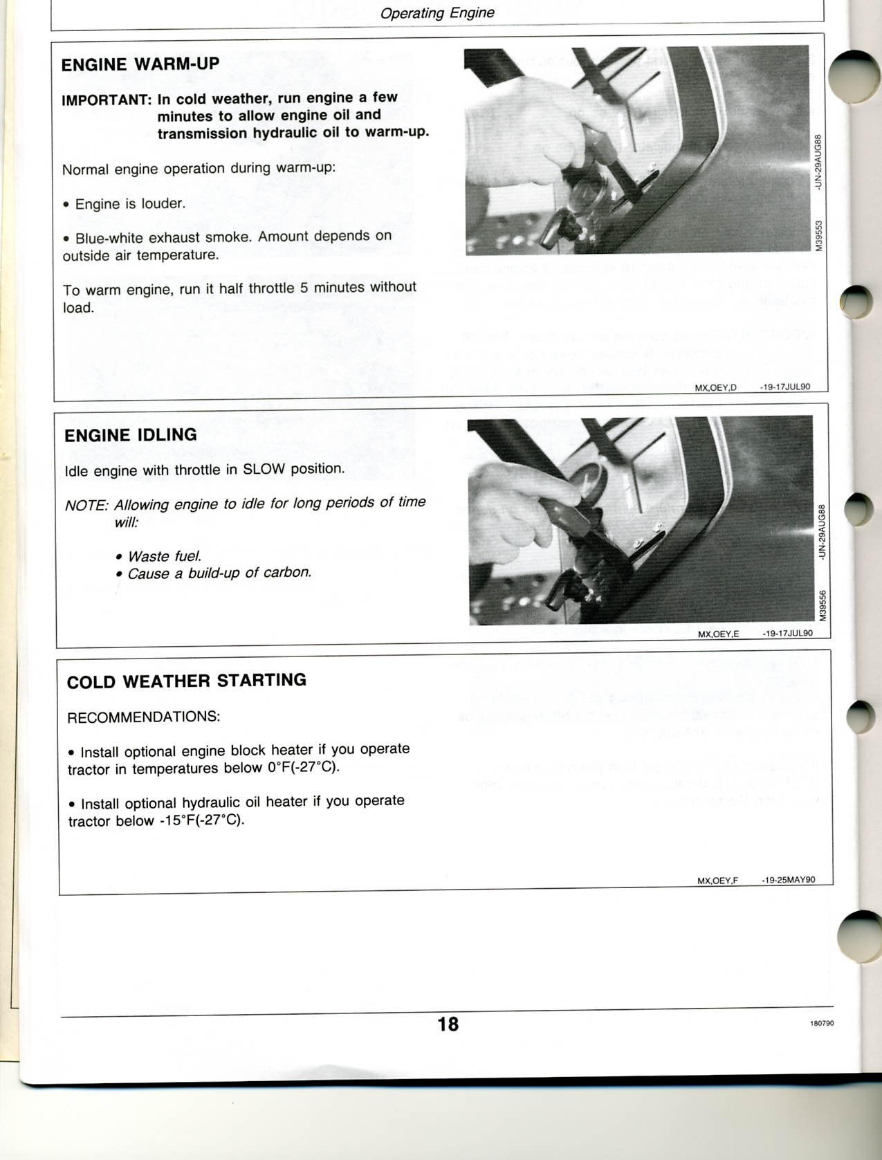

Another vote for 5 minutes. That's what I do. My manual also refers to carbon buildup.
