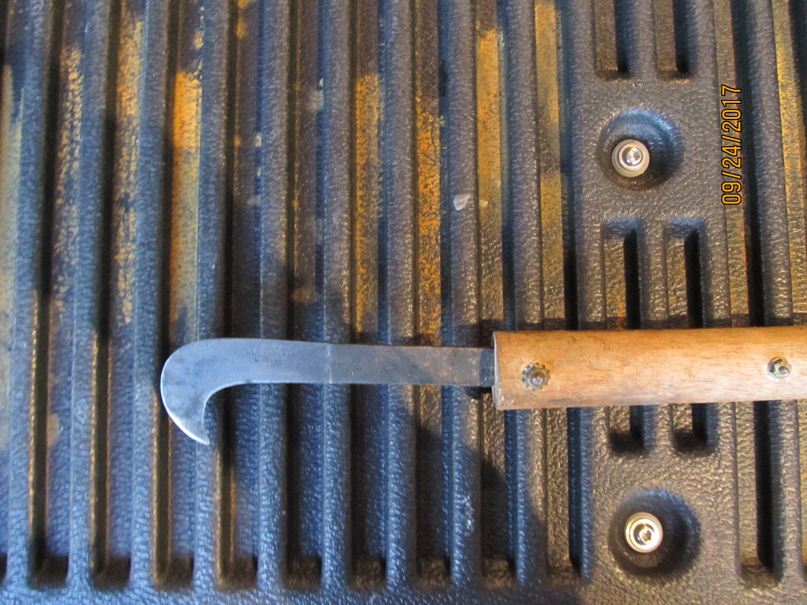

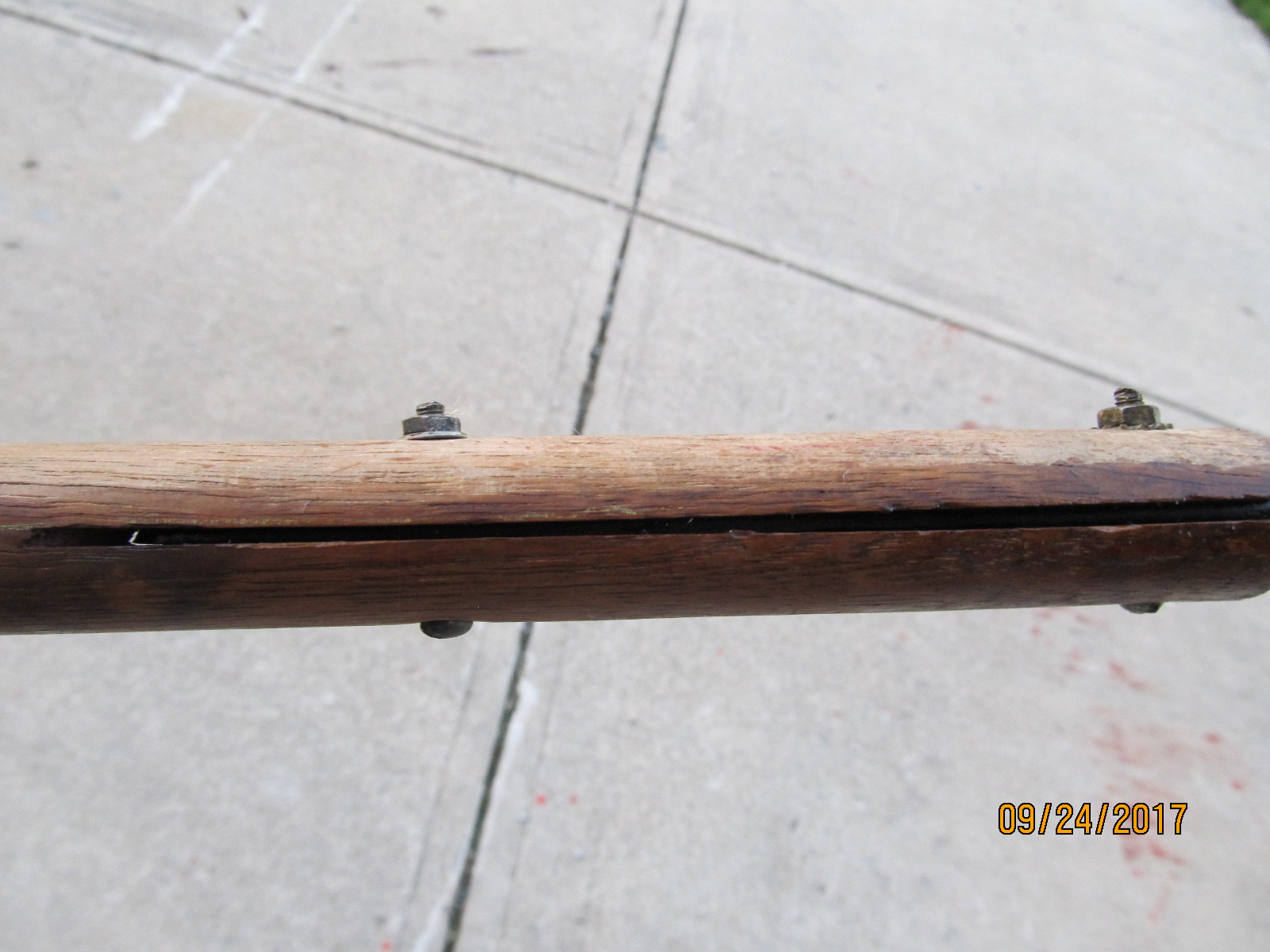

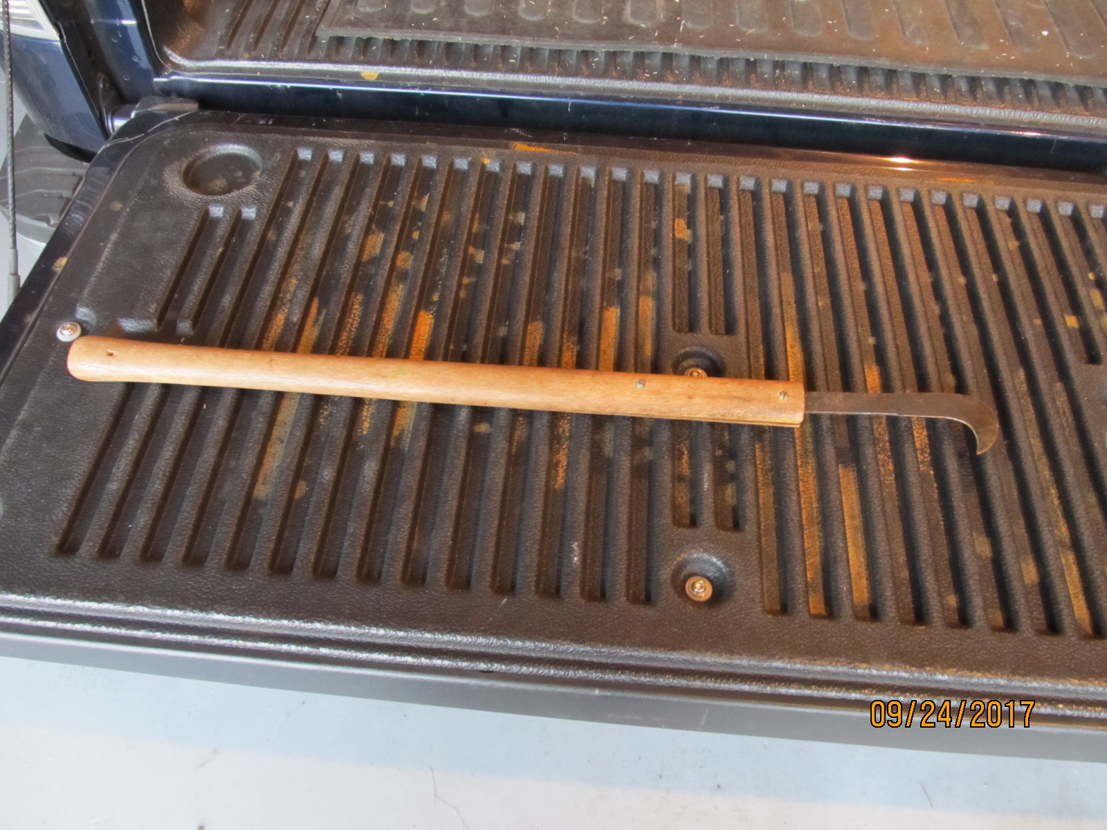

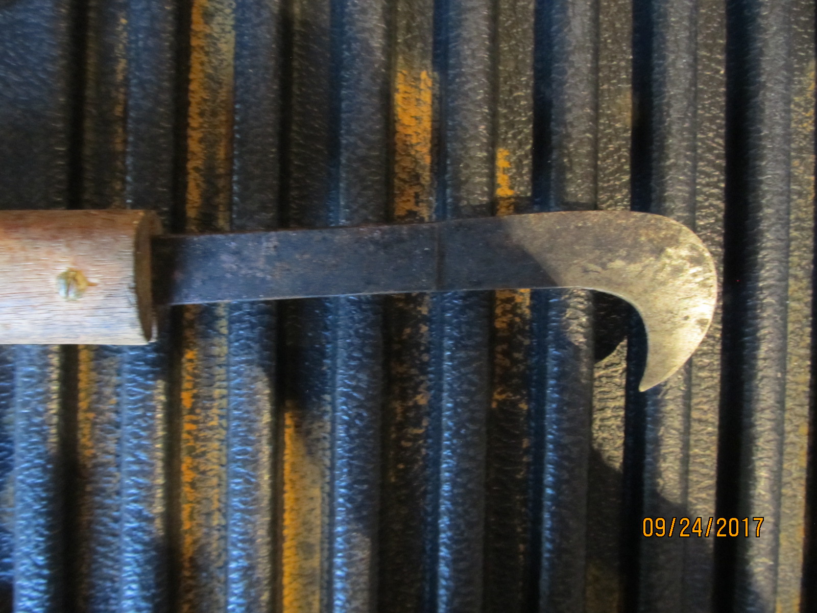

Here's an on-the-spot tool I put together about 25 years ago. The problem was getting wound-up grass and string, etc out of my 6 ft rototiller tines without cutting myself in the process or wasting all day. The sharp birdsbeak and the backslope of this tool blade allows me to hook onto wound up grass and rip it right off. What used to take forever now takes a few minutes.
It's a flat blade from Austria that I got as a surplus item from one of those knife catalogs. I think Smoky Mtn Knifeworks. The handle is the remainder of a broken maul handle and I cut a table saw kerf in it to accept the blade. I keep it razor sharp with a chainsaw file.
It does double duty as a weed cutter for marestail on the edges of farm fields. With a sharp edge, I can reach in and hook the stem and easily cut it off.

How do you sharpen the inside radius for cutting bailing twine, or do you ever need it to be sharp. I sure could have used one of those over the years.
