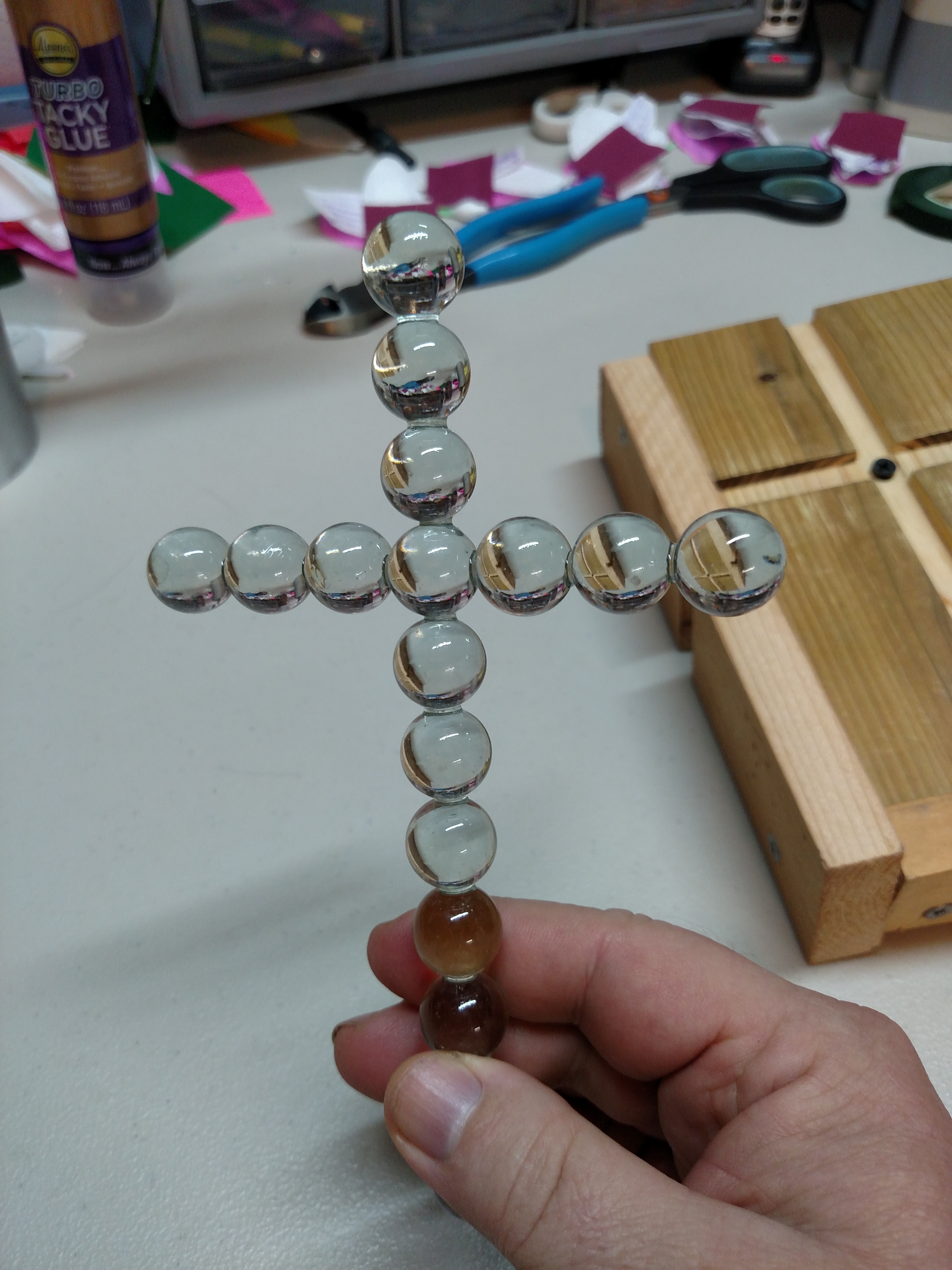

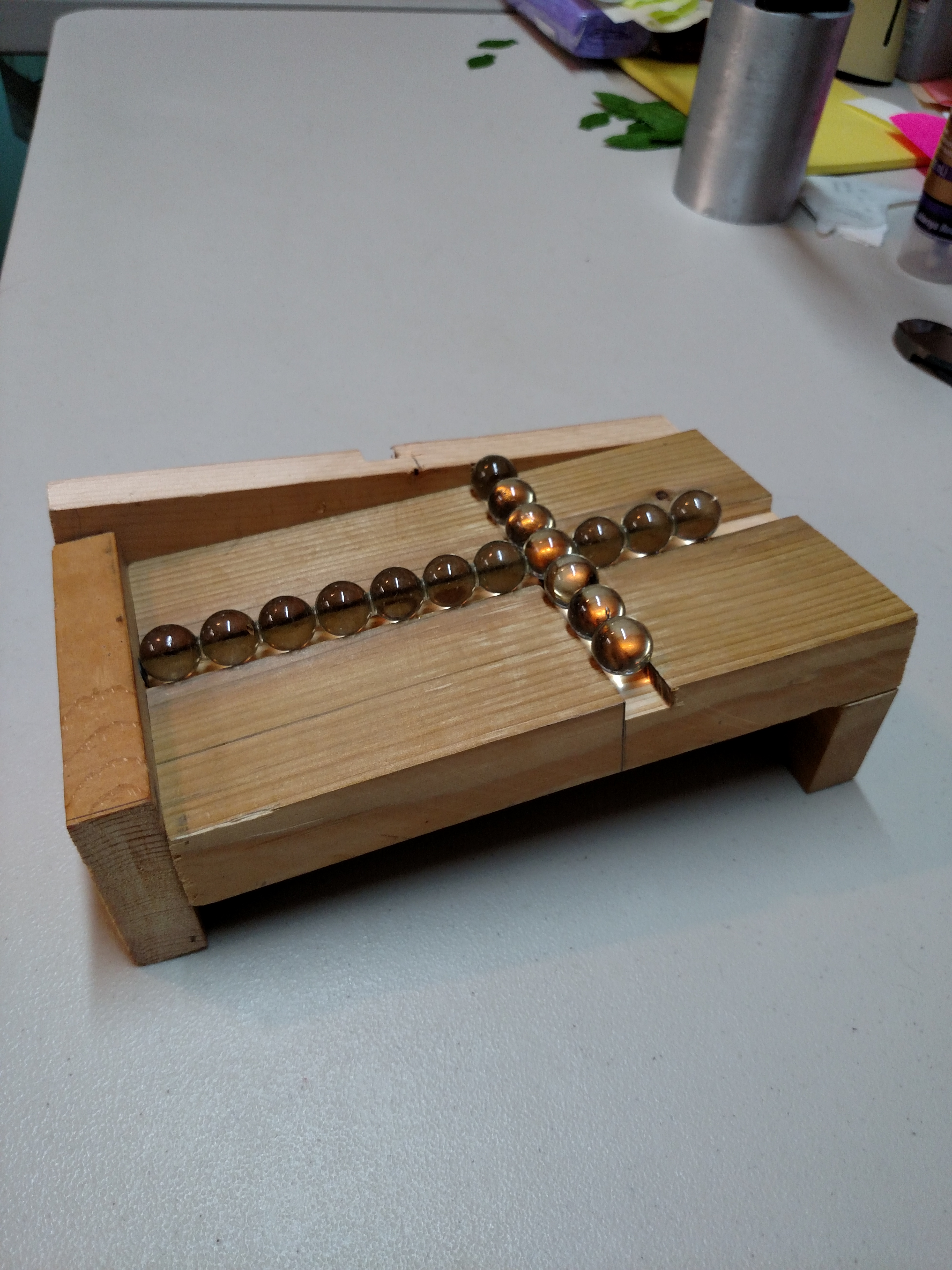

I guess you would call this a "construction tool" :)
My wife is making paper flower arrangements and one of her designs features a cross made of marbles epoxied together. She made a few the hard way of trying to line up the marbles on a table and asked me to come up with a better solution. This wooden jig is what I came up with.
I routed the grooves with a simple square bit on the router table, and installed screws where needed at the end and in the middle to adjust alignment and marble height.
Since the jig is tilted two directions from plumb at the same time one simply rolls down the first marble and applies a dab of epoxy. the cross arm is the same with the marble in the middle precisely positioned to intersect both lines of marbles. No fuss no muss, it makes the marbles automatically align in the right spot.

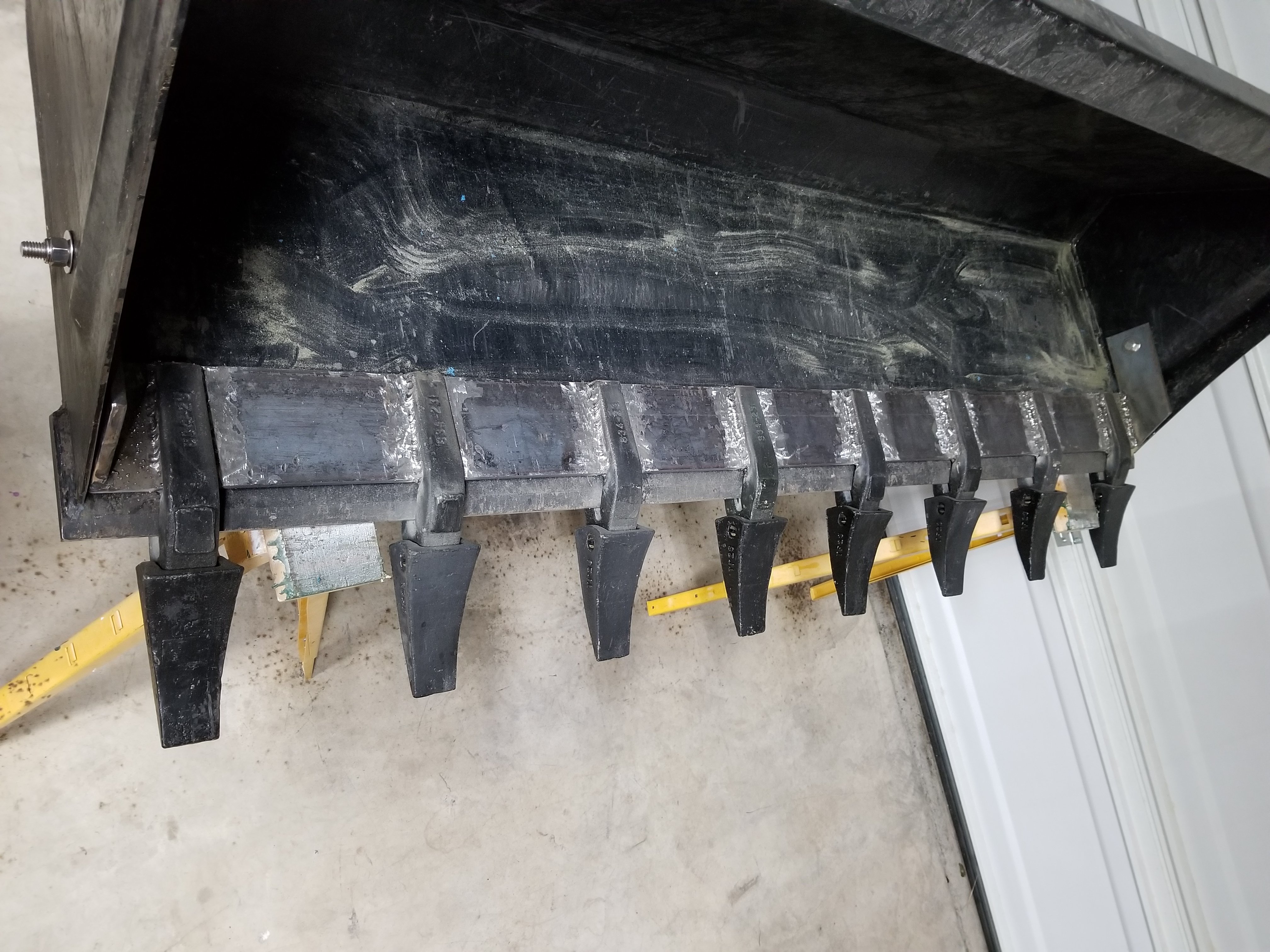

66" toothbar! Titan teeth on 1/2"x4" flat-stock. Time to tear up some property.

Pretty slick.. Looks good

It looks like it would do it!:thumbsup:

Maybe turn those bolts around so that the threads are to the inside of the bucket. Then you won't be tearing up something you are working beside. It will also make the bar easier to remove should you so desire, as the threads won't get gibbled as quick.
Nice job btw!

Yeah, that was temporary so I could cut off the excess threads flush to the nut easily then turn them around. Tomorrow, I am welding angle iron to the top and three 3/8" chain hooks. 😎

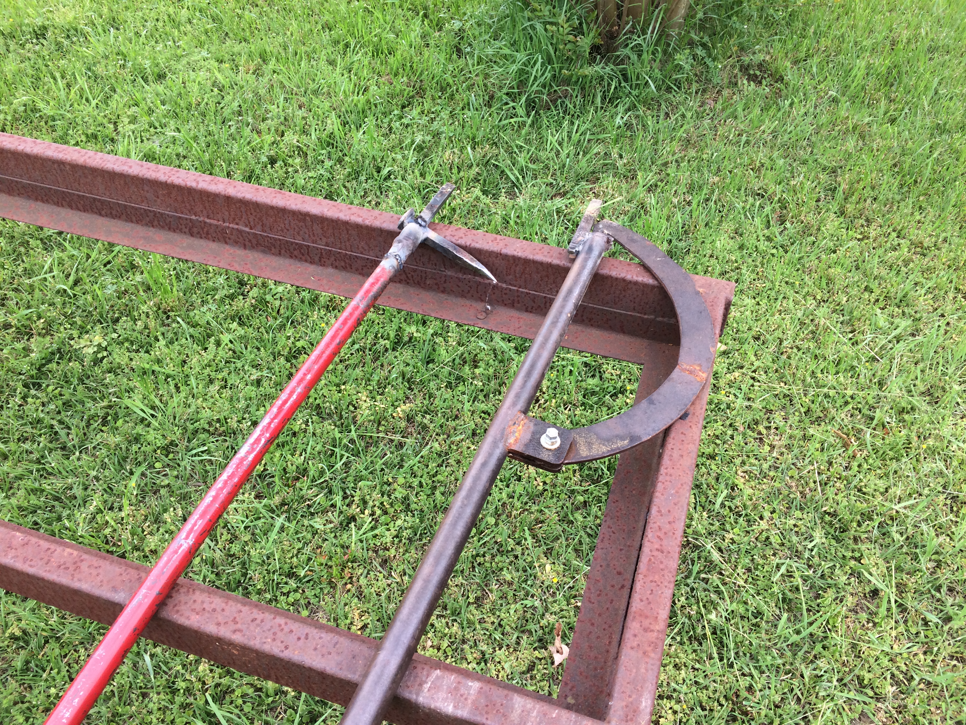

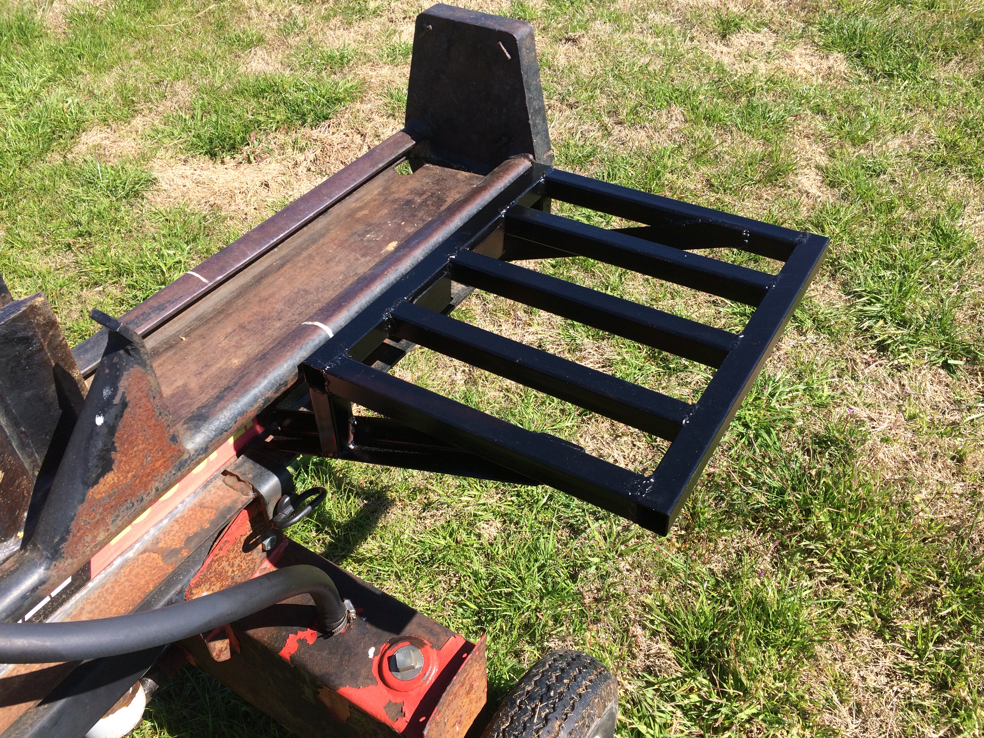

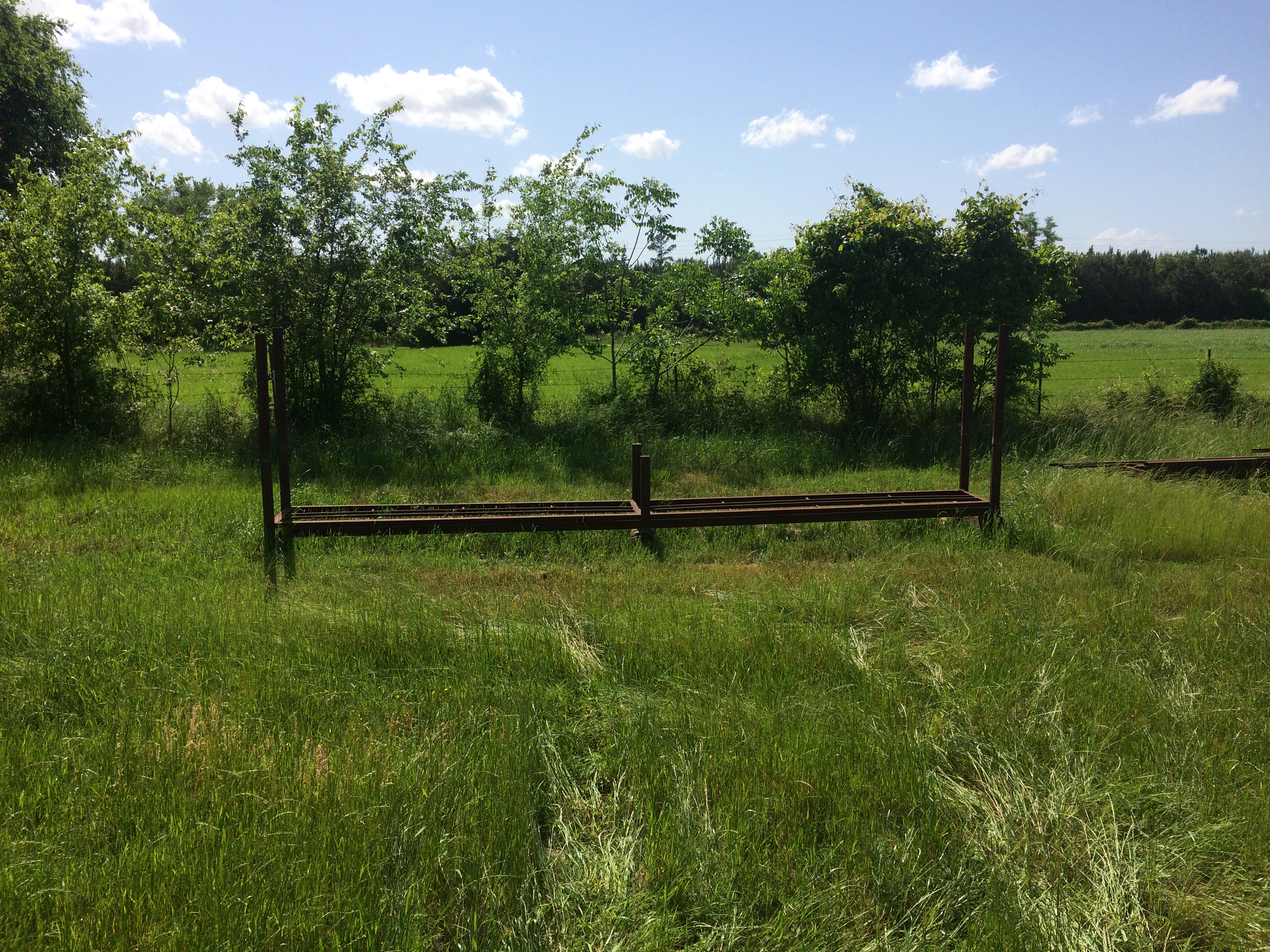

This is a great thread. I picked up some ideas from the posters. One thing i like is homemade tools. Working on general aviation airplanes it is almost a requirement to make special tools. Buying store bought is expensive as many things aviation is expensive. So I have amassed quite a number of aviation special tools.
Here are some I've made for working firewood. Removable table for log spliter. Modified cattle feeder into firewood rack. Hookaroon and can't hook for working logs and rounds.
