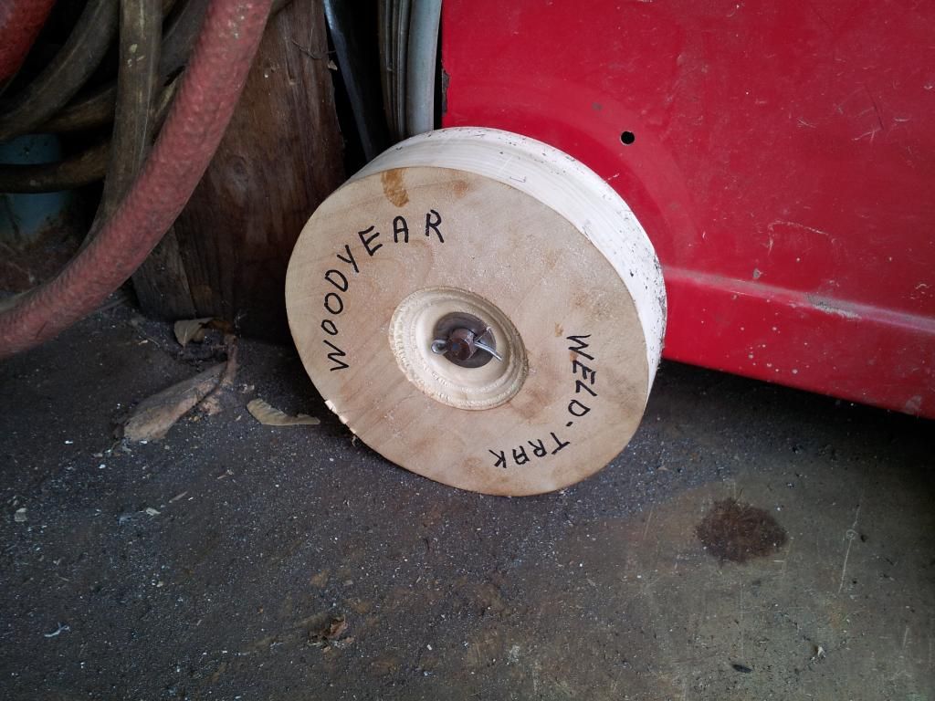

Not a tool... but for a tool... tired of busted losing their tread wheels on the stick welder at work. Few minutes in the wood shop with a scroll saw and lathe, and we have a new tire company... presenting... Woodyear Weld-Trak!

yeh ... and easy to "stud" come winter ..... :)
I bet that will split right through the center hole before long. Neat idea for a temporary fix though!
   / Show What Tool You Made* #355
Wrap a rubber band around that and your good to go.
   / Show What Tool You Made* #357
Laminate some plywood to get the desired thickness and solve the splitting problem
Yeah, that would work or ....... find a piece of pipe the right size and press it over the wooden wheel to make a steel tire. PVC pipe would probably work too, but it's kinda hard to find PVC that large.
Maple... good WV hardwood.... should be ok for the use it sees. No your run-of-the-mill pine, that would split!
