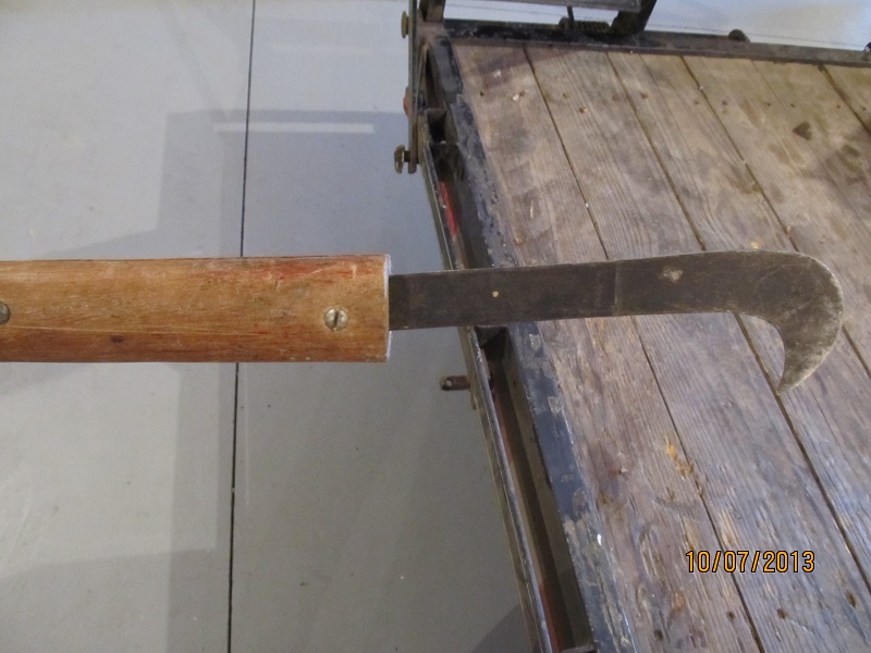

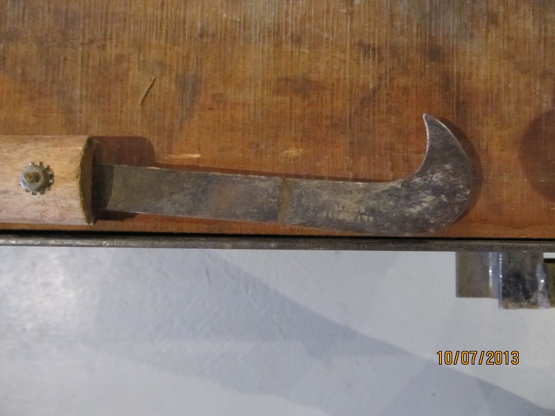

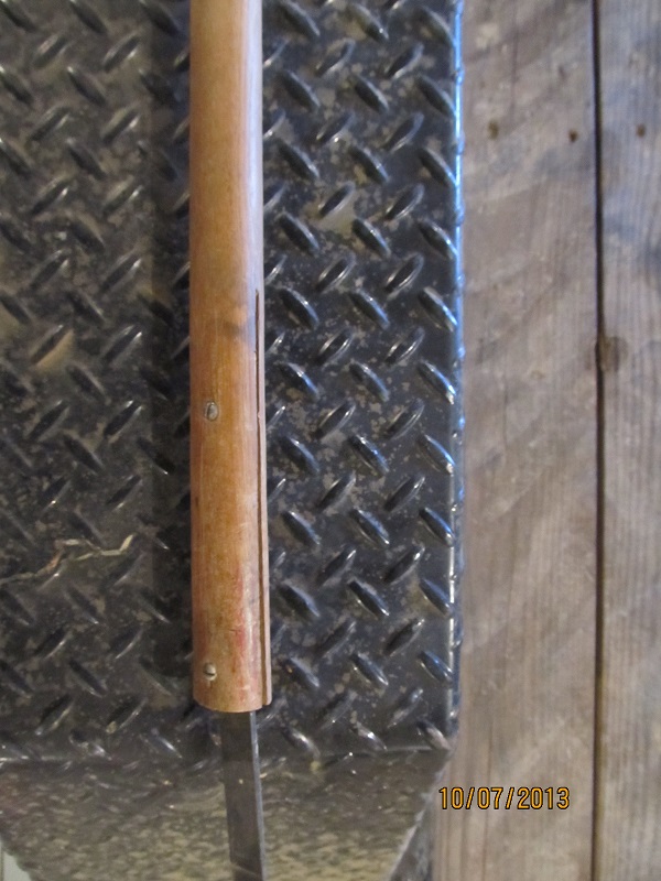

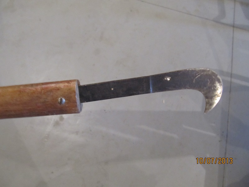

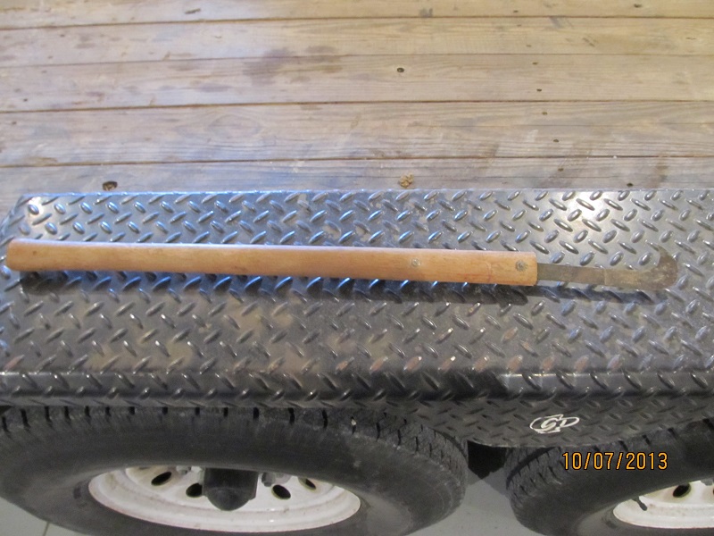

Choker Chain Grab Hook. Push it under the fallen log/tree, hook on to the choker chain, and then pull the choker chain under. A lot easier than pushing the pin end of the choker chain under and then trying to find it to grab it with your finger tips and pull it thru.
Its also a lot easier than what we used to do of driving a log hook into the end and lifting it to get choker under it. Gosh we were stupid back then, Strong but stupid.

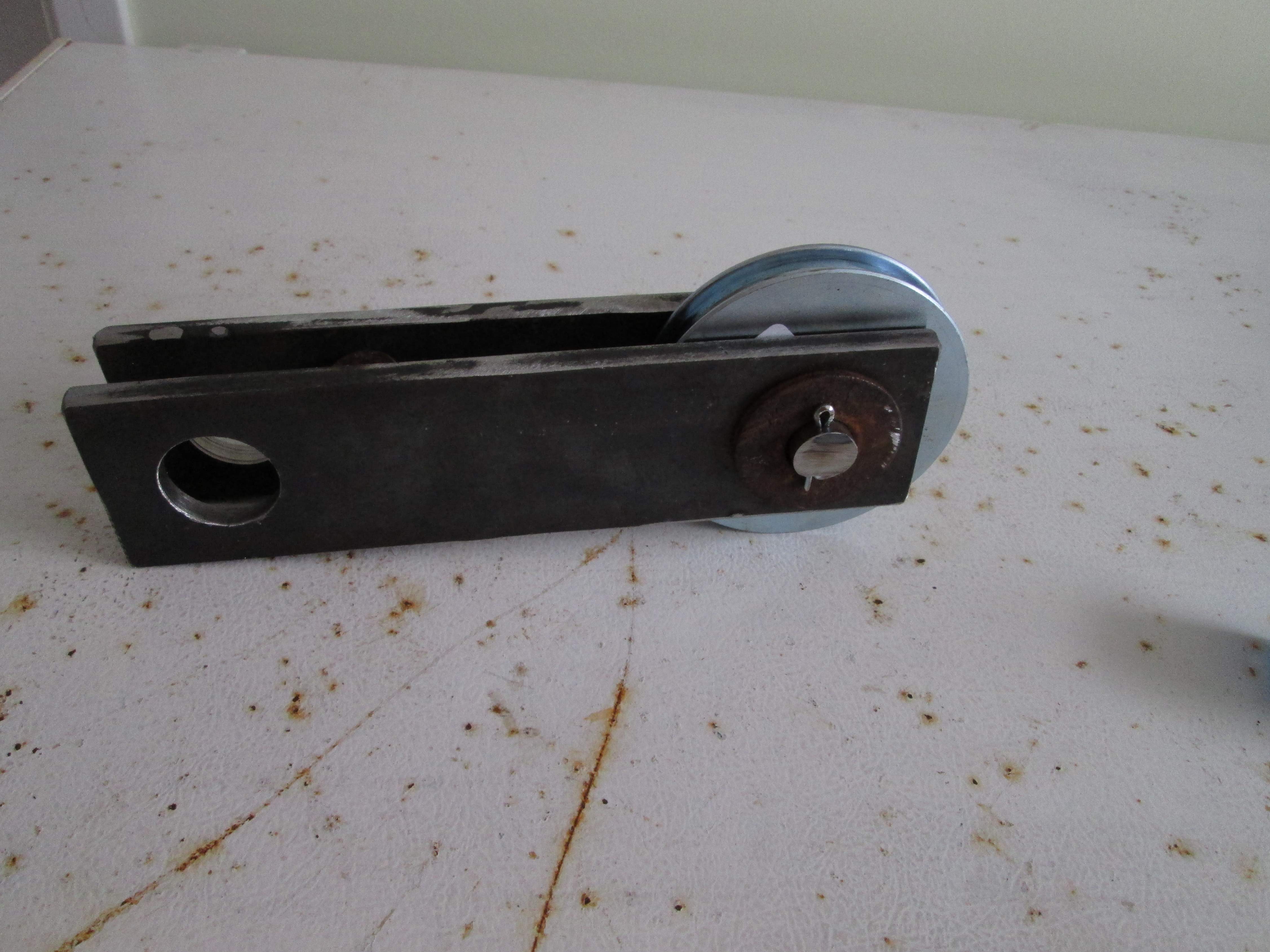

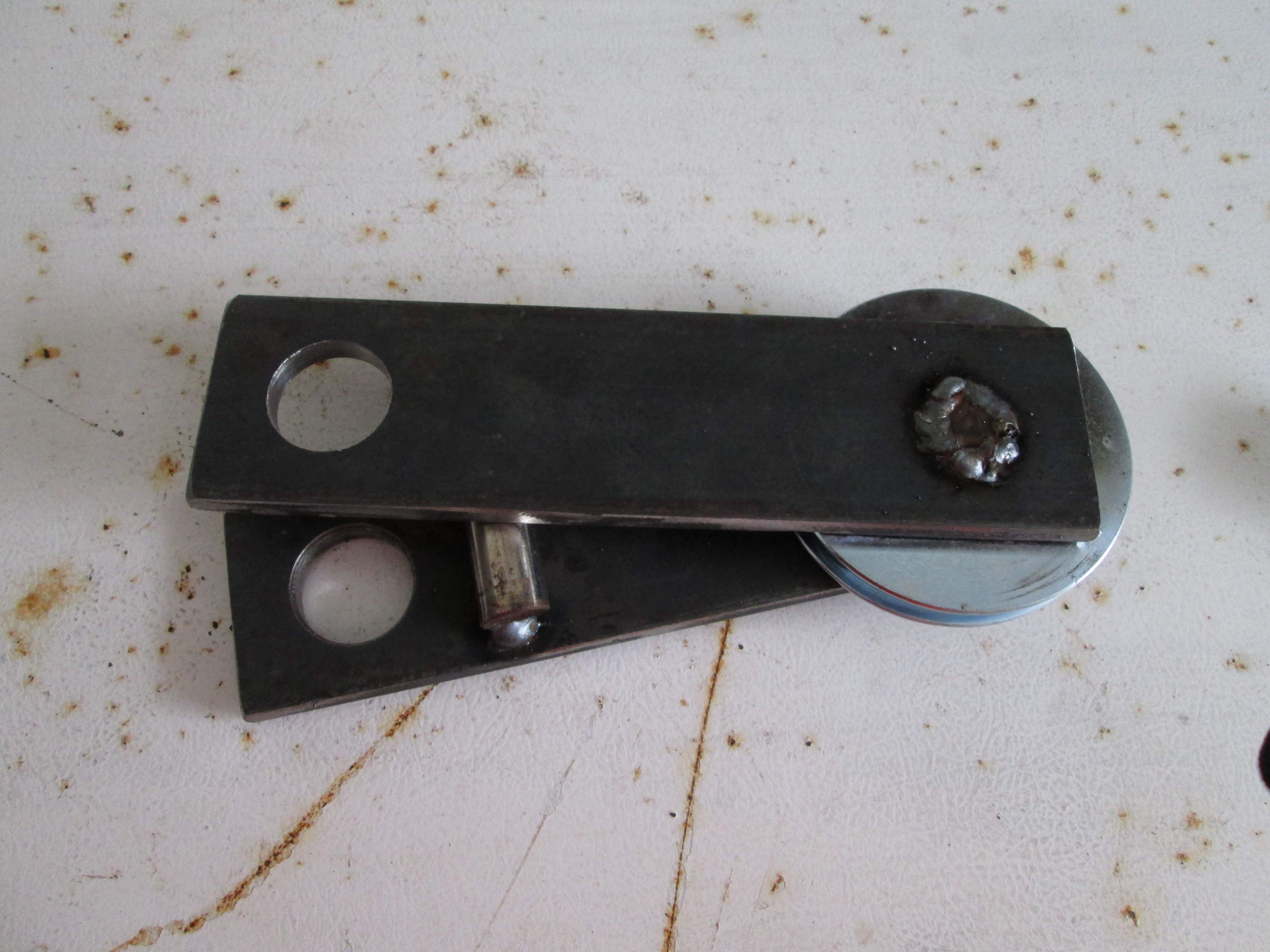

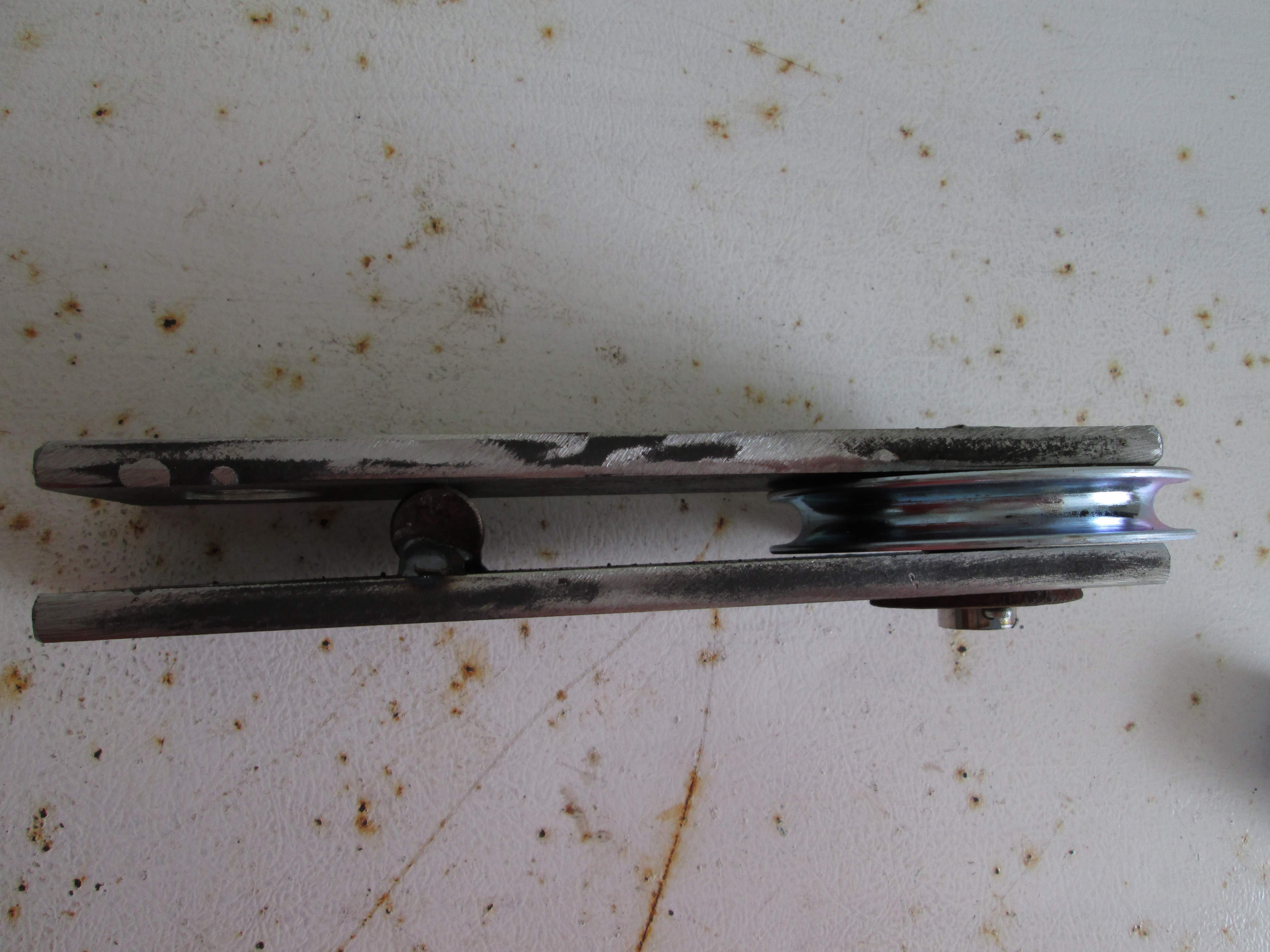

Was tired of my logging winch snatch block . It had a bent pin and most times hard to hold the cable, get the chain around a tree and get the pin in to hold it all.
Ebay 5" sheave $30 scrap flat bar and 3/4 axle (old washing machine agitator axle) and a couple hours and its done.
Now just rotate it open , drop the cable in, close it. Drop the chain through the hole wrap around the tree hook it up and done.
