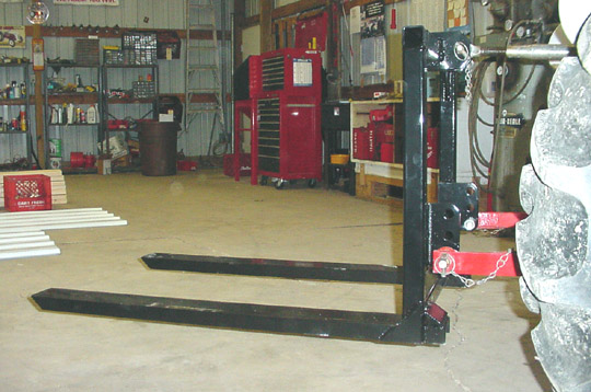

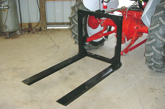

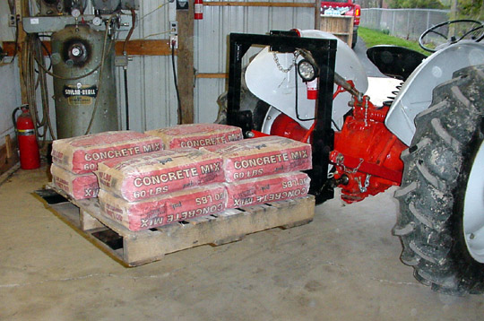

I have desing plans for this one. I call it a 3 point fork lift, but it could be modified for many tasks. Philip.

Philip,
That looks very professional. Would you please post or E-mail the design plans for your 3-point forklift?
/ Show me your 3pt carry-all
That's nice Philip, looks like it's built stout. I was thinking about using 1.5" sq tube, but realistically for what I have planned for it, 2x2x1/4 angle will probably suffice.

Here are the plans. Philip.

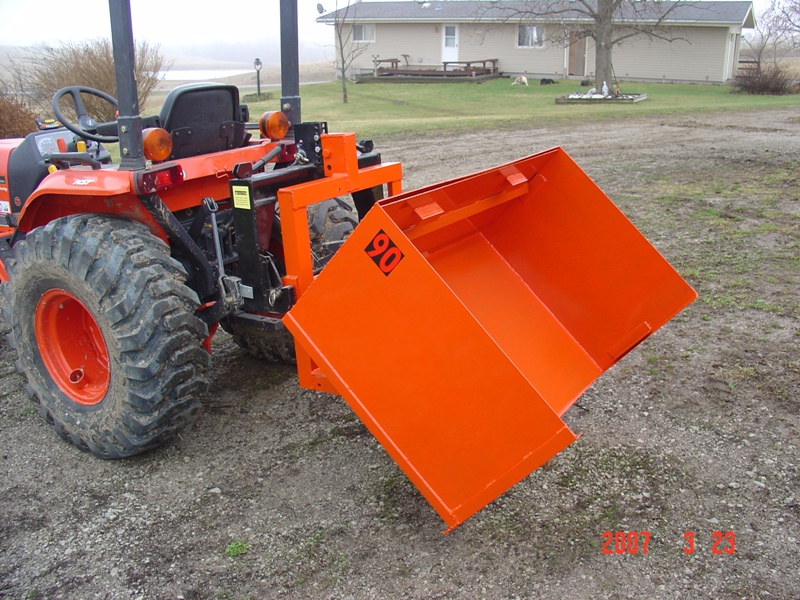

I tend to call mine a Tote Box rather than a Carry-all. I haul wood with it and the wife uses it to work her flower beds. I've attached a couple pics and my plans. The best part of it was building it myself. Good for the Soul. :)

/ Show me your 3pt carry-all #10
Ovrszd.
How much front weight to off set rear load?

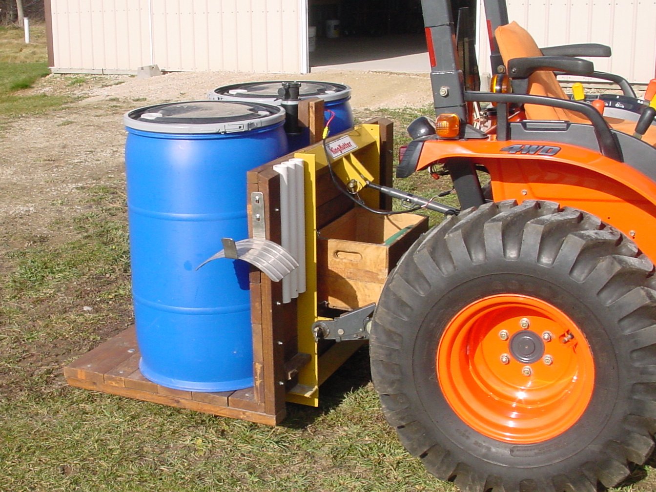

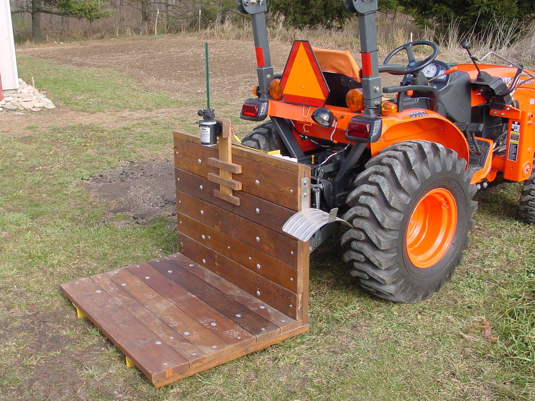

I use mine mainly to carry water out to the newer trees. The planking is just wide enough for two 55 gallon drums. I'm guessing a full load weighs about 1000 pounds including all carry-all material. A 12 volt pump works nicely for watering and that is mounted on the top rear of the carry-all.
/ Show me your 3pt carry-all #16

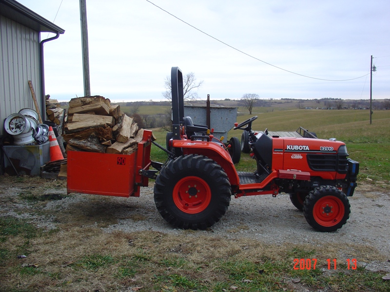

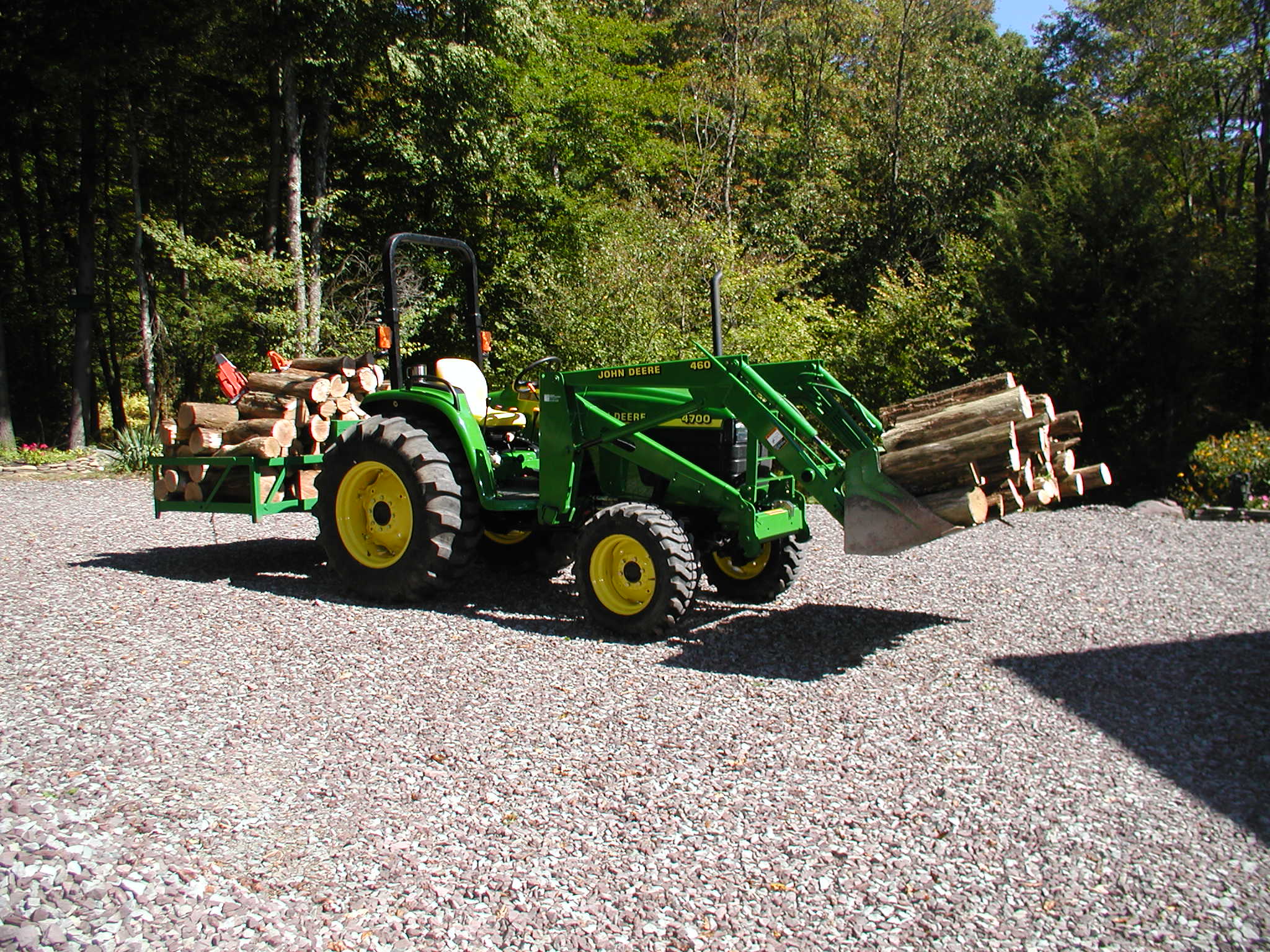

Did not build a dump in it, but I find lots of uses for it. This is a load of wood for the OWB.

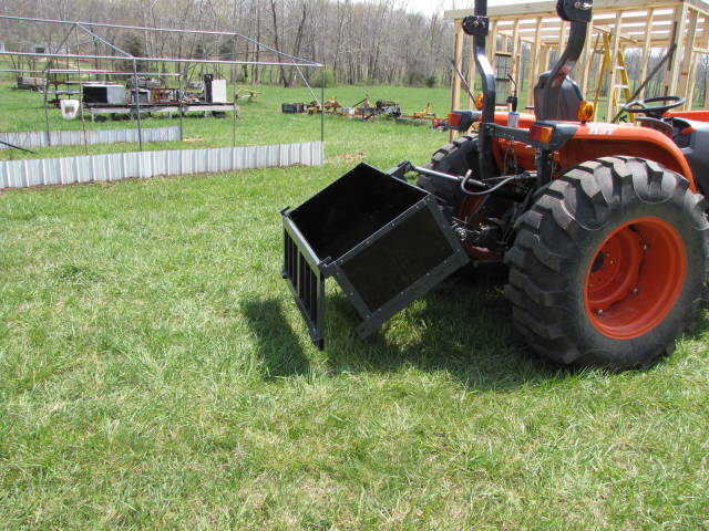

Here is what I made if you don't need it real big. I use it as a carry-all, and weight box. I use gravel for weight and when full it's more then enough.
