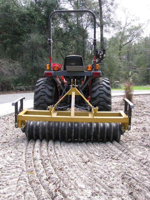

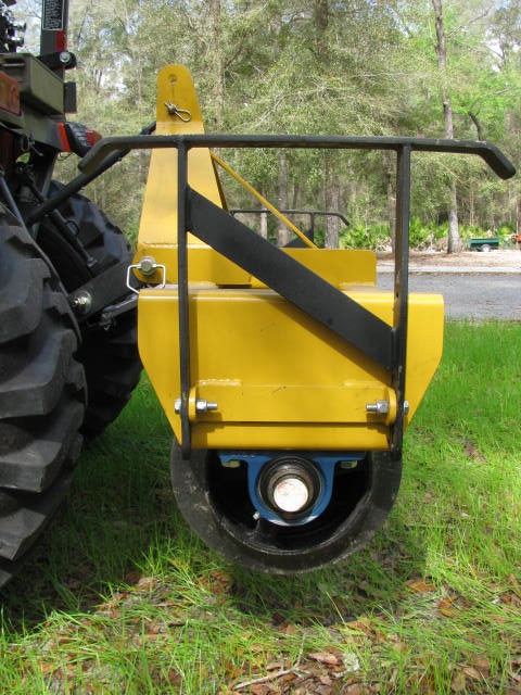

Grappling logs out of a jumbled pile will require a lot of ballast on the Three Point Hitch. I use a Three Point Hitch mounted, 860 pound Cultipacker for everyday counterbalance with just an FEL and HD bucket, because a Cultipacker is compact weight. In critical situations the mounted Cultipacker can be lowered to the ground and rolled along, unitized with the tractor. "On the ground" is the lowest practical center of gravity for any ballast implement.
You need minimum 1,100 pounds of grapple counterbalance on the Three Point Hitch with any one of the five heaviest Grand Ls.
