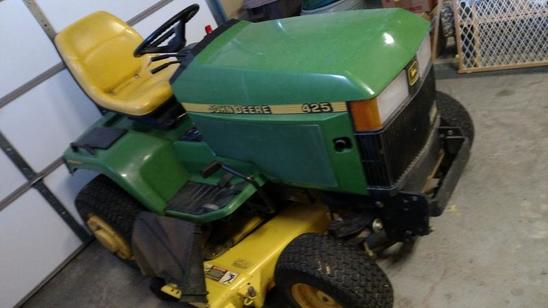

Here's the picture.

Go get it ASAP. They are great little garden tractors. Of course, I would try to get it for less, but I would buy that in a heartbeat, even if I couldn,t talk her down on the price.
/ Should I buy this 425? #4
I would also buy that in a second. If it hasn't been done already, you might want to replace the plastic cam gear with the newer metal one. Tractor should last another 20 years.
/ Should I buy this 425? #5
Would also buy it in a heartbeat/second. Even tho I have one already.
Half the price it should be.. IMO.
Looks to be the AWS all-wheel-steer which will do near the performance of zero steer, and so many other things that the z-steer will not do well.
Would help to know the serial number.. can id the year made. Only the early ones had the plastic cam..
Some baking soda will clean up the spilled battery acid, and new battery may be good along with fixing a spindle on the deck.
Don't think you can go wrong with that purchase. Just don't let someone else beat you to it.

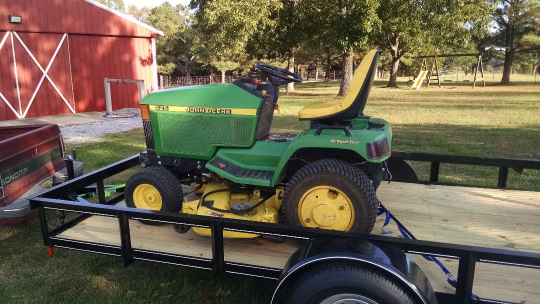

I got it yesterday. The lady lives about 0.5 mile away, I could've driven it home :)
Couple of pleasant surprises too. She found the manual to the mower and the deck. The mower had the purchase date. She'd originally told me they bought it in '94 but she was unsure, but the manual stated, 12-27-99. If my research is right, that means it should have the metal cam gear. I still plan to call the dealer and see if they can get me the serial number.
Also, the spindle was wobbly because the nut was loose. It was only finger tight. I haven't had a chance to tighten it or put the belt back on, but hoping to Saturday. I did manage to grease every zerk I could find. Probably hit 10 and I'm not sure I got them all, but they were all pretty thirsty.
Front and back lights work! Really excited about it.
A little beefier than the 120.

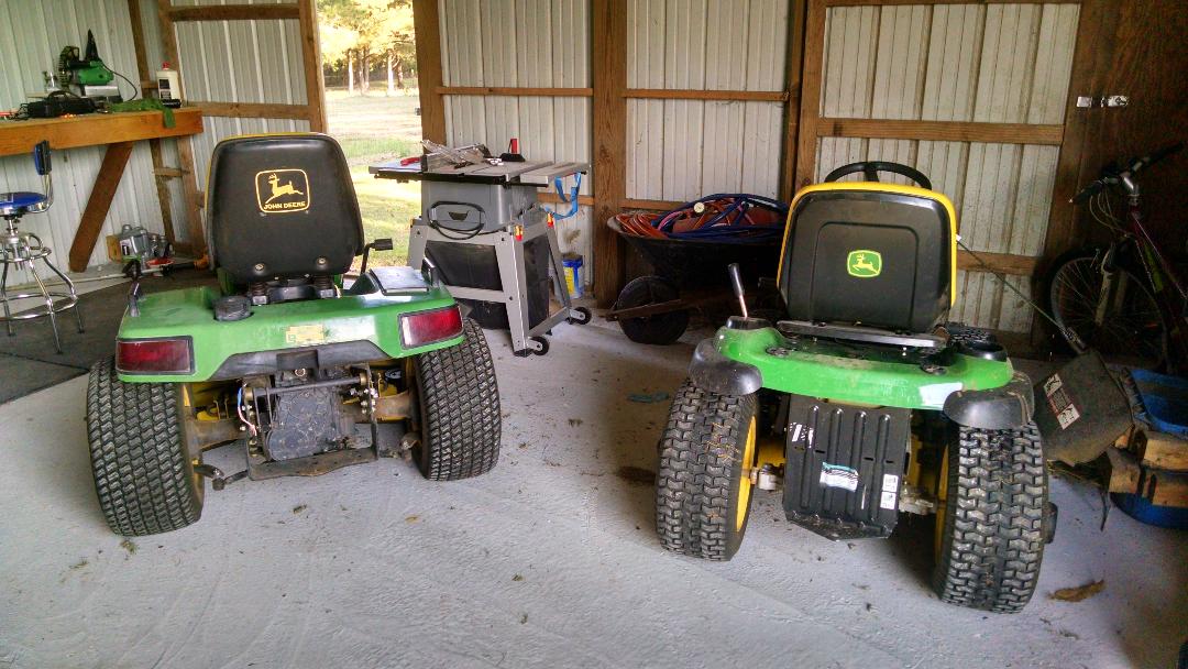

Wow, that tractor looks great.
Is that a horse hitching post in front of the barn?
Also, what are you using on the floor with the pictures of the tractor inside?

Yes, it's a hitching post. Previous owners had horses as well as stalls in the barn. I removed all the stalls and poured concrete. Nothing on the floor. I need to put down a sealant but it's way down on my project list.
