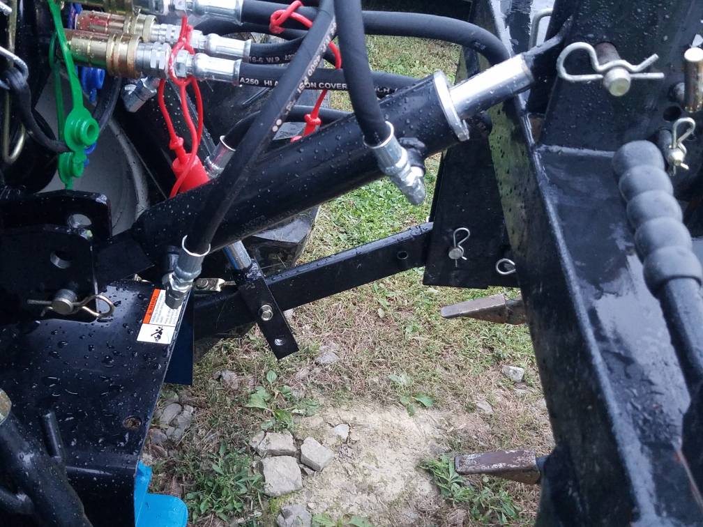

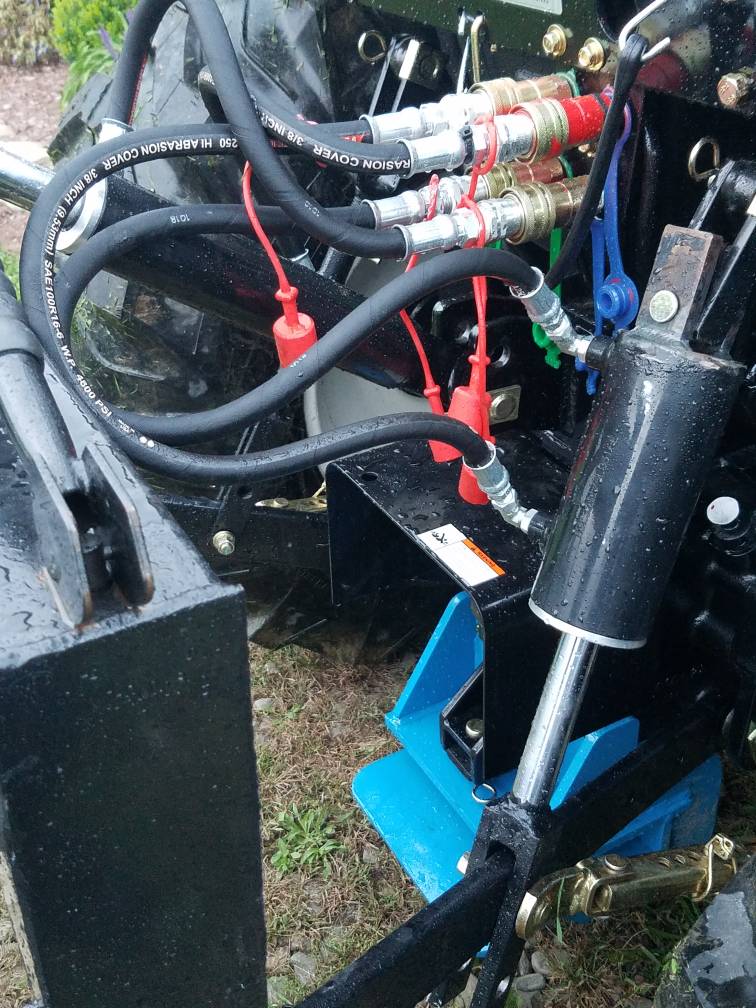

Hello I'm looking for a short hydraulic top link, the one i currently have is
cat. 1, 2" bore, 8" stroke,,, retracted it is 20" extended it is 28",,,, i've seen a couple that are 18" retracted but dont think will find much shorter than that and have 8" stroke, maybe i don't need 8" stroke but problem i'm having is not getting enough angle with my box blade to use the front blade

On some cylinders (like the inexpensive one from Agri Supply)...when retracted it is 20" but there is about 3.5" of rod exposed...it is rather simple to cut and re-attach the end making the retracted length about 17" and still retain the 8" stroke...

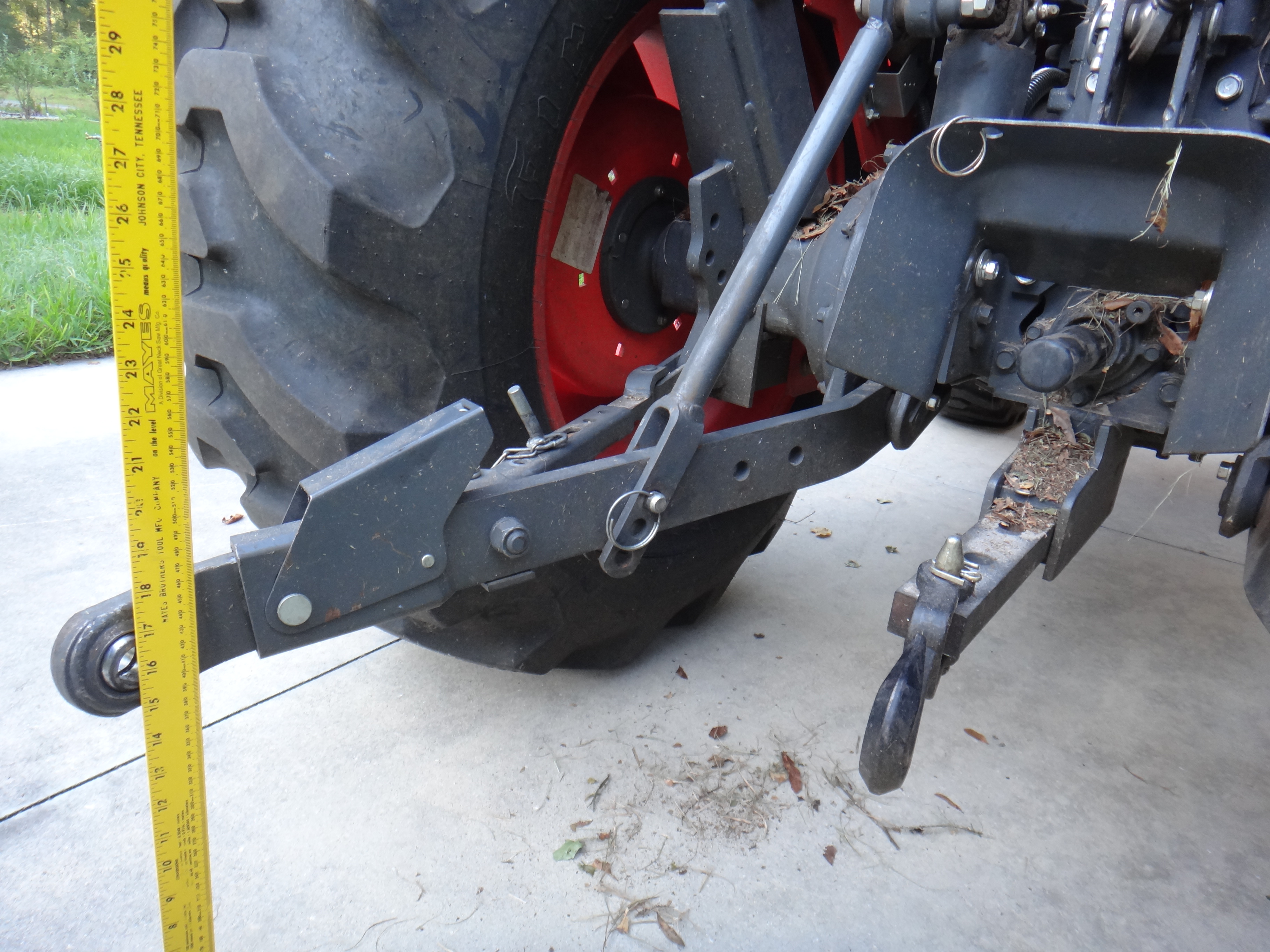

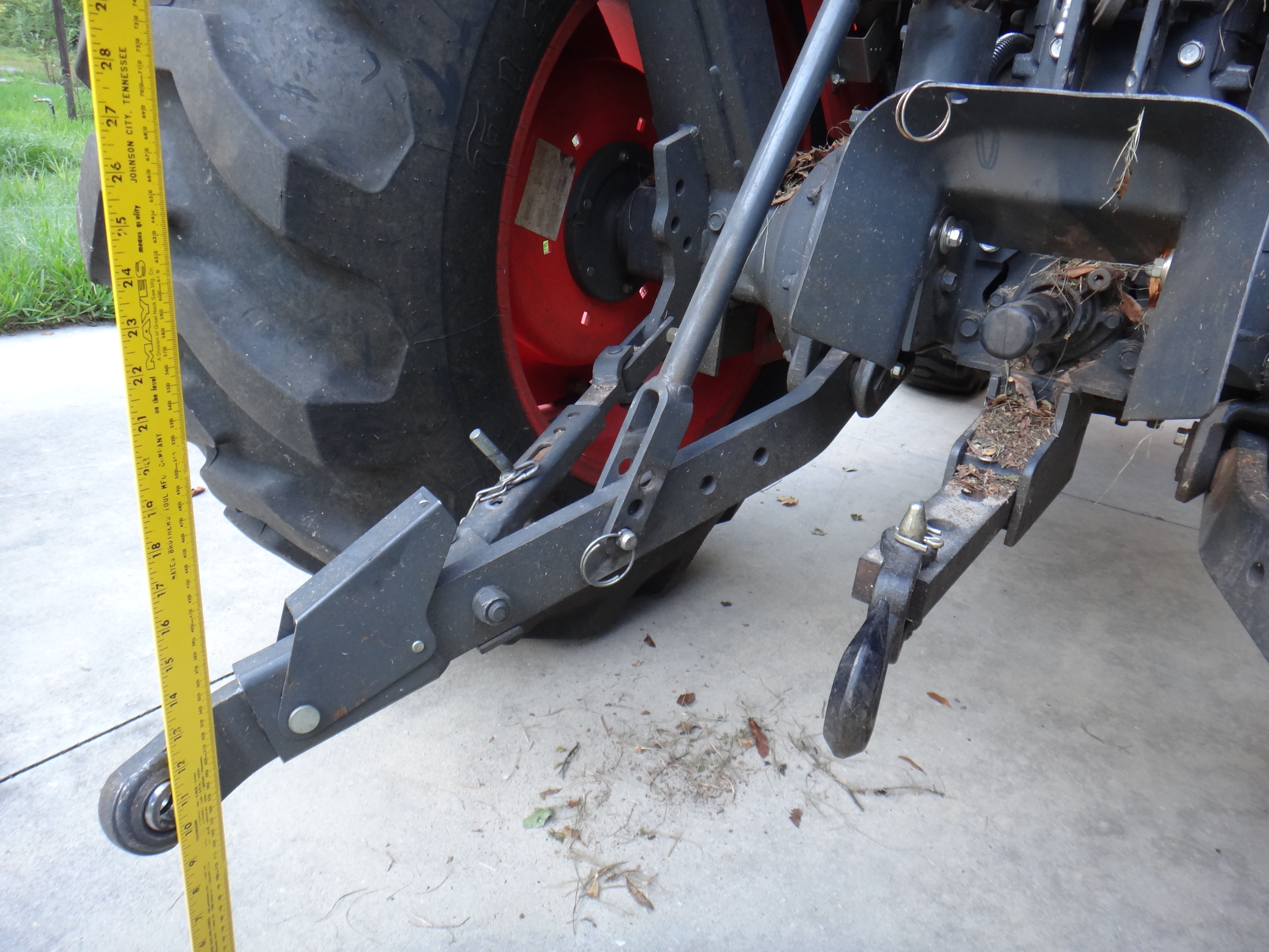

Change the pin adjustment which couples the right and left Lifting Rod stirrups to the right and left Lower Links, from the top pin position to the lower pin position.
The front of the box blade will settle at least 3", probably 4" lower.
Offering different Lower Link lift heights is the function of this pin adjustment.
LOWER HOLE = LOWER IMPLEMENT
HIGHER HOLE = HIGHER IMPLEMENT​
This is also the best way to introduce tilt to a Box Blade that does not have T&T from Fit Rite integrated into the Three Point Hitch.

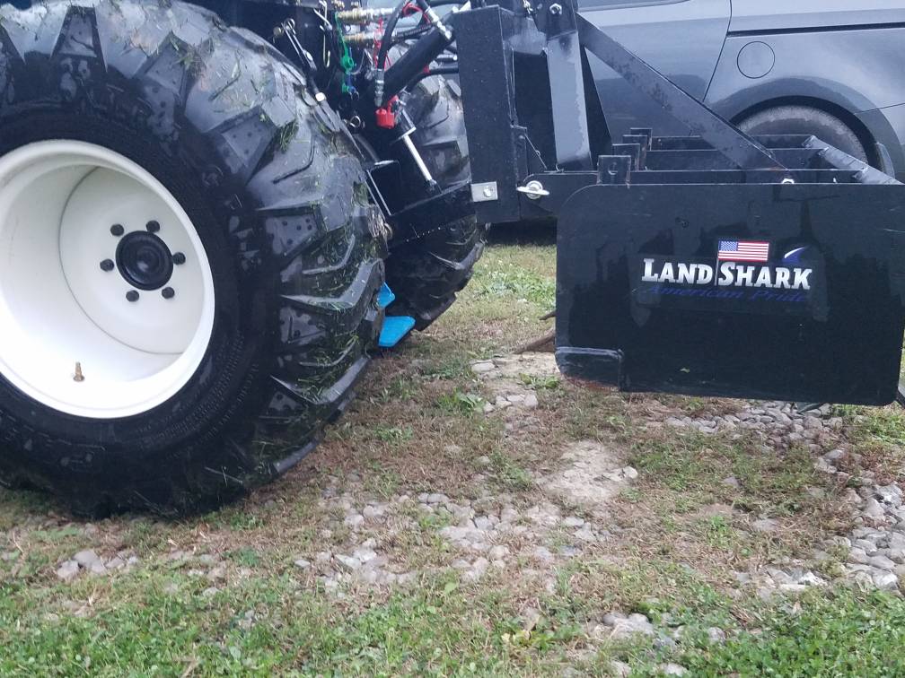

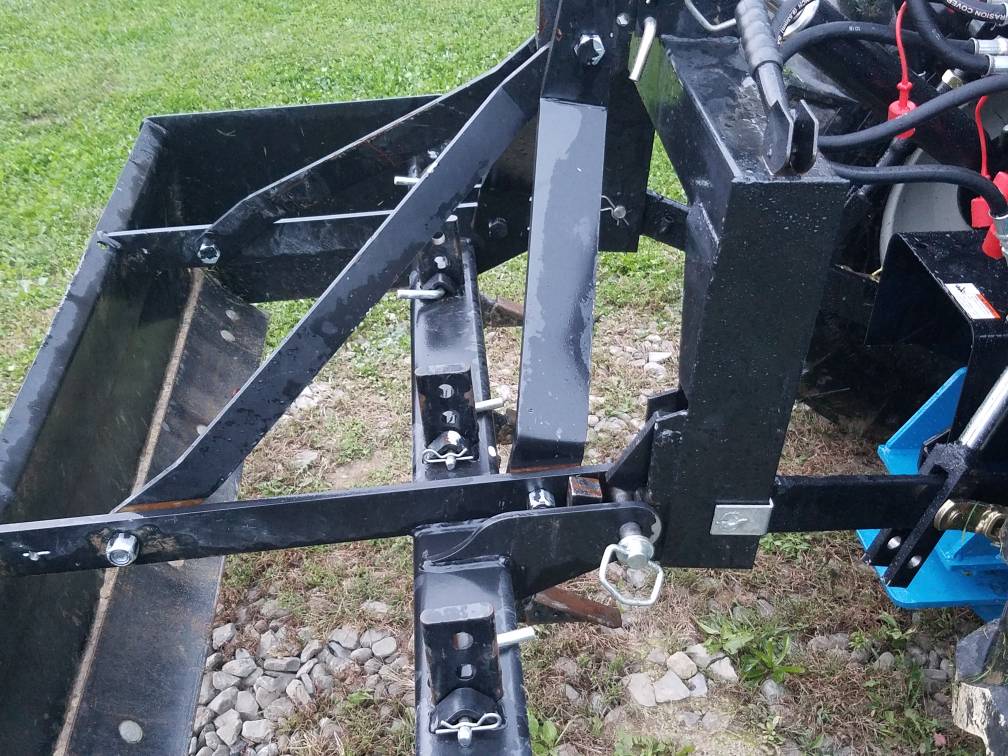

Sorry for all the pics but here's my set up, i've tried moving tractor end of top link in either hole, current hole is best i believe, i may buy shorter top link and still cut it shorter, just seems like i can't get enough pitch forward, and have way more than i would ever need going back(extending), i started drilling holes in box blade to move diagonal suports back further to create down pitch, but started thinking i shouldn't have to do that20180924_185955.jpeg20180924_185925.jpeg20180924_185901.jpeg20180924_185933.jpeg20180924_190113.jpeg

Photo #4 shows pin in lower hole on left stirrup, top hole on right stirrup. Pinning both sides in lower hole may resolve your problem, coordinating with lengthening screw adjustment in center of right LIFTING ROD after moving right stirrup pin to lower hole.
/ Shortest hydraulic top link #9
It's the box blade, not the tractor. Move top hookup back so it is straight up and down with the box blade. You can go back even back past center. The blade looks like it might have the holes there to do just that.
Are you saying top hook on the quick hitch, move that back, if so i think it may hit the box blade frame, i had to extend/weld it out further because i was having that problem with most of my implements
/ Shortest hydraulic top link #12
No the box blade, the top hookup is leaning fwd. Move the kickers back.
Ok i think that is ehat i started to do i was going to drill new holes so the diagonal supports would be mounted back almost to the rear plate

After seeing the pictures and now knowing that we are not talking about the 2538 Mahindra that you have listed, but an LS tractor, you need a 17"-23" unit.
That is what I provide for the LS (R & XR) models. No complaints as of yet.

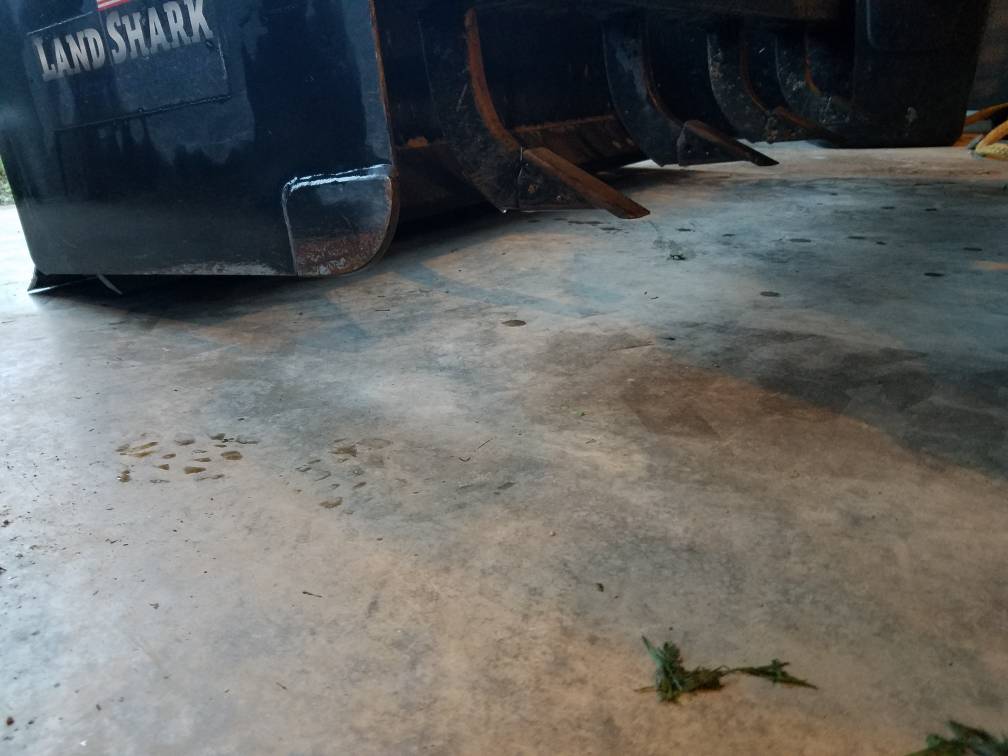

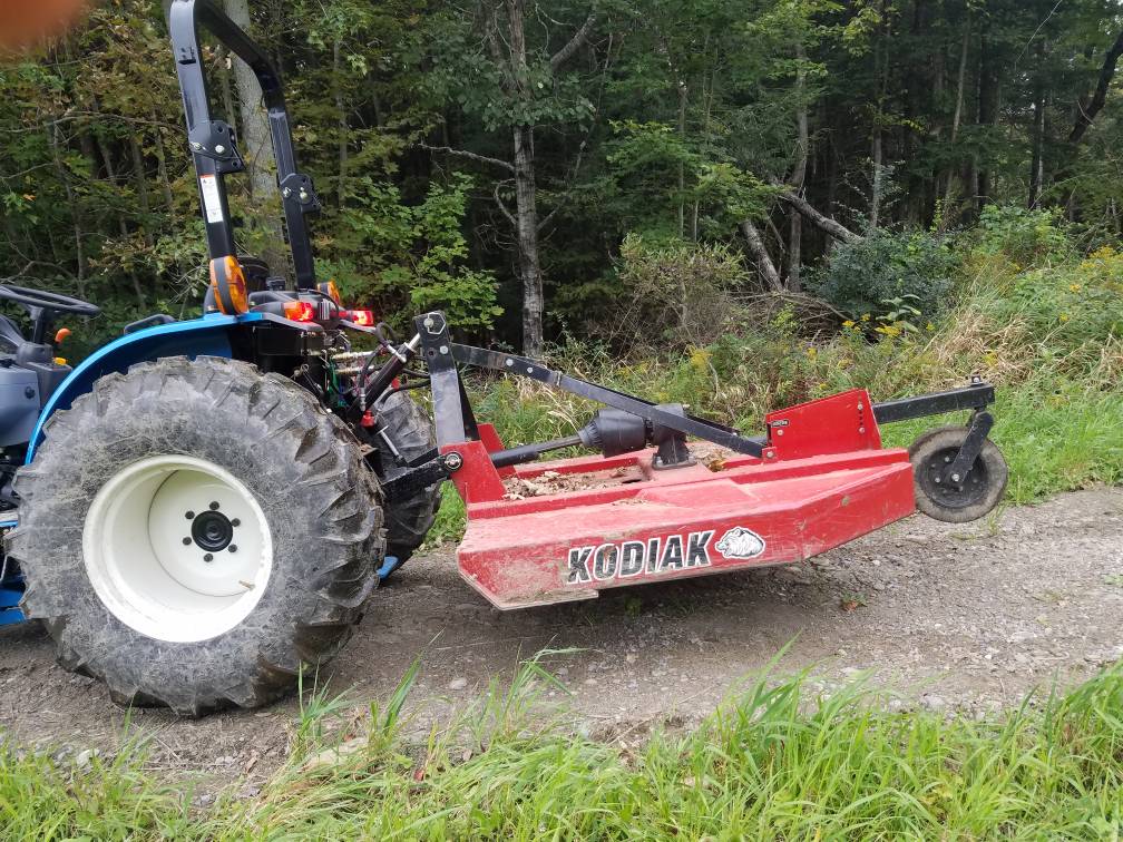

Heres another pic with brush hog on and no quick hitch, seems like i remember the back wheel being higher up with my other tractors, could that also be because top link is to long
/ Shortest hydraulic top link #19
Most likely.

Looks like you could get a couple of inches by cutting both ends of the cylinder a bit. You still have room to do this if you can get a good weld on the cylinder ends.
