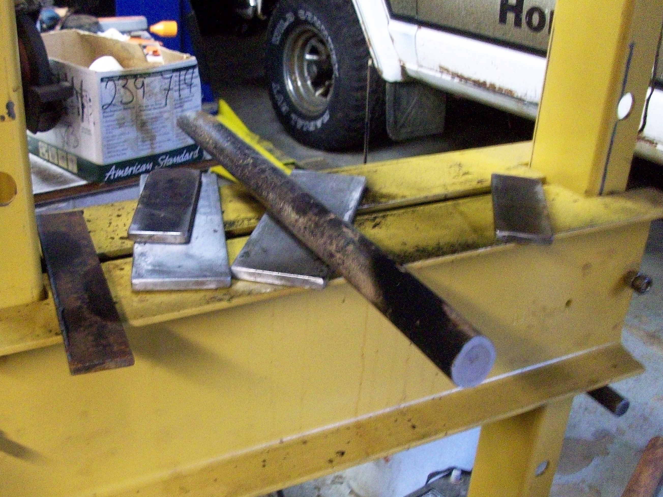

I copied much of the design of the HF 20 ton press and built my own using side pieces identical to the HF 20 ton and some I beam i had laying around.
While back, bent one of my grapples 1 3/8" round tines. so i decided to try and straighten it with the press and some heat from an oxy/acetylene
anyway ended up snapping the tine
no damage to the press, - My guess is the HF 20 ton will work for you

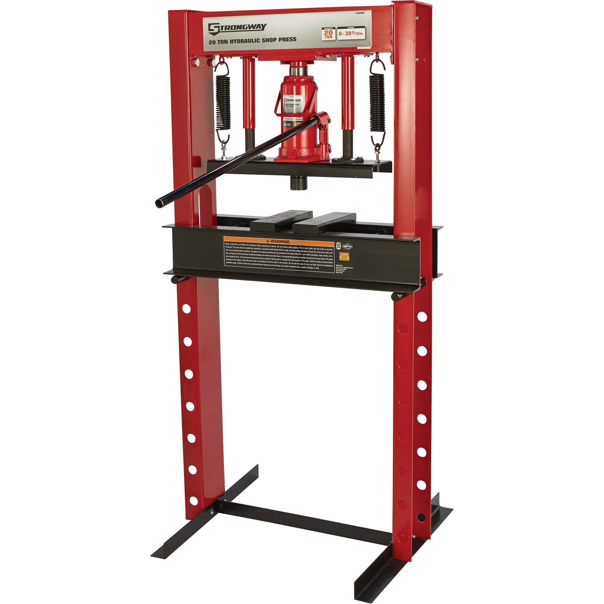

The style of my first picture is a death trap when it comes to press design. This design is also fixing to be outlawed in the shop's for the company I work for.
The support tubes next to the springs are a week link. Which I can attest to since I killed ours with a torch after it tried to kill me. :eek: Thankfully when the arms bent and it spit the shaft out, it went the opposite direction And tried putting the shaft through the wall instead. It dented the siding and shook the building when it hit the wall. Not to mention the bang, which got everyone inside the building into the shop to find out what happened :eek:
Second pic shows what we switched too. Granted it's $100 more, but money well spent. Actually getting spoiled since it's air over hydraulic. Nicest feature is you can stand off to the side if you have something being really stubborn. :thumbsup:
Good post.
/ Shop press #20
How did the guide tubes fail?
My HF 20T press has served me well, tho I do not have the air-over-hyd setup. I bought it over 10y ago for
less than $200, and I have maxxed it out numerous times. It is orange and the guides are nothing like
in your left photo. Sometimes I wish I bought the 35T or 50T unit.
I do like my standalone 20T jack with air control, also from HF, so it makes sense that air control
on the press is a good thing.
