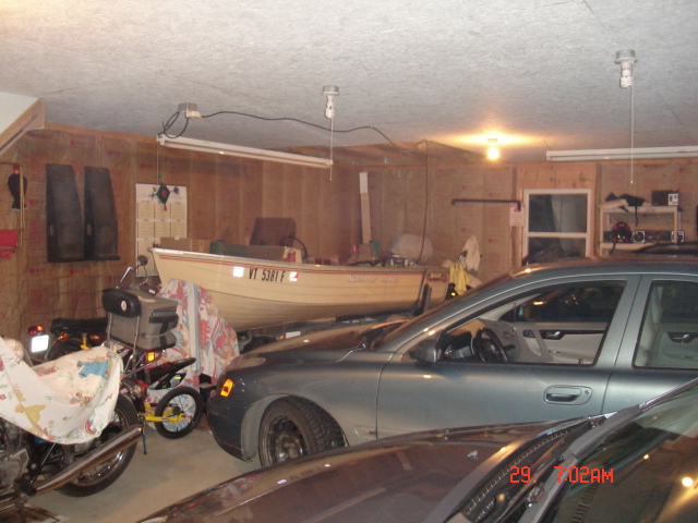

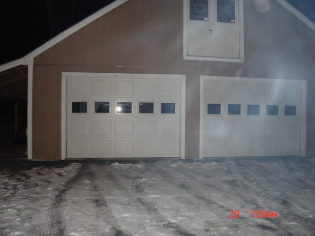

My garage is 32 x 32, with an 8' ceiling. I did buy a 35-55,000 BTU "Mr. Heater" from Northern a few years ago, and it'll do the job, but it sounds a bit like an old Lear on climb-out: really noisy!
I began insulating, completing the ceiling first; made a huge difference. Completed walls, and then began applying inexpensive 7/16" Home Despot plywood, priming it white first. That made another big improvement, both with heat retention and light reflection. Started walls this fall, but have only finished one so far. With the addition of the insulation & plywood, 55,000 BTU seems quite adequate to bring temp up quickly (10-20 mins) when I need it.
Although I always keep the garage vented, adjusting as needed, the small direct-fire Mr. Heater will quickly build up humidity in the garage, something I've learned to avoid- it'll cause things to rust from the inside out.
I always considered the heater to be temporary, and even though my conception of that word can run into years sometimes..:D, I plan to eventually mount a propane blower heater on the ceiling, something like a "Hot Dawg."
My only concern is that it be relatively quiet-- anyone have experience with this type of heater? Any recommendations?
