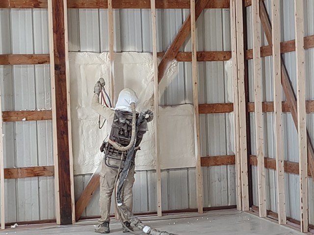

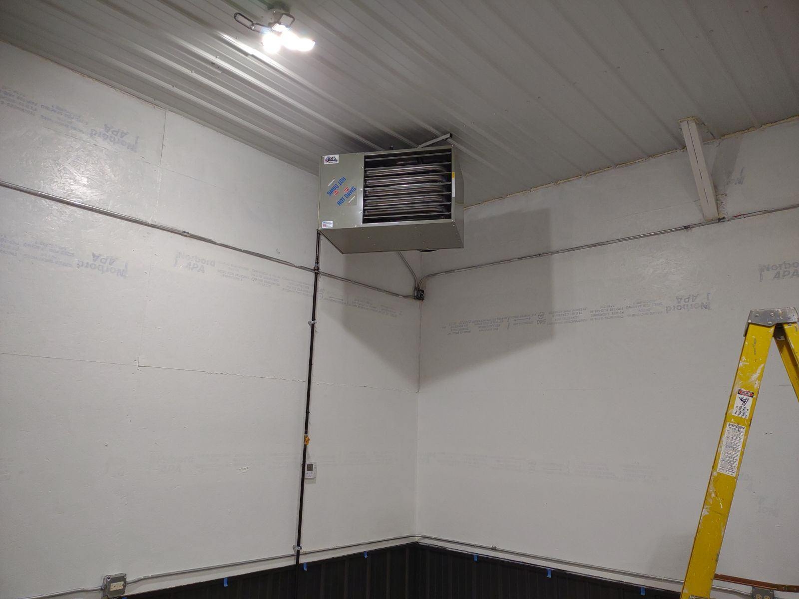

I put the foam board down and around the exterior "rat guard"/footing and with the spray "closed cell" insulation,
Also do these run off like a propane grill tank or would i need to get one of the larger permanent tanks?
I don't have a pic of the foam board / concrete, but I drew up something to show what I did. The heater (100k btu) is tee'd into the 500 gal tank, that the house uses. He said it "would be fine"... He machine trenched the ~40 feet to connect it - used a cool tracked trencher. This part could've been a DIY, but I left it to professionals (it took him 45 mins to run the line - $400).

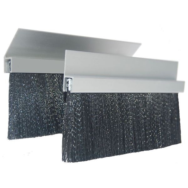

I don’t believe the type of 12x12 door the OP intends to install has been mentioned. With my corrugated rollup door I found brush seals to be very helpful with air loss and keeping critters out. $180 for my 8x12 door. Simple to install. Good people to work with too.
I will look into these. Thanks
