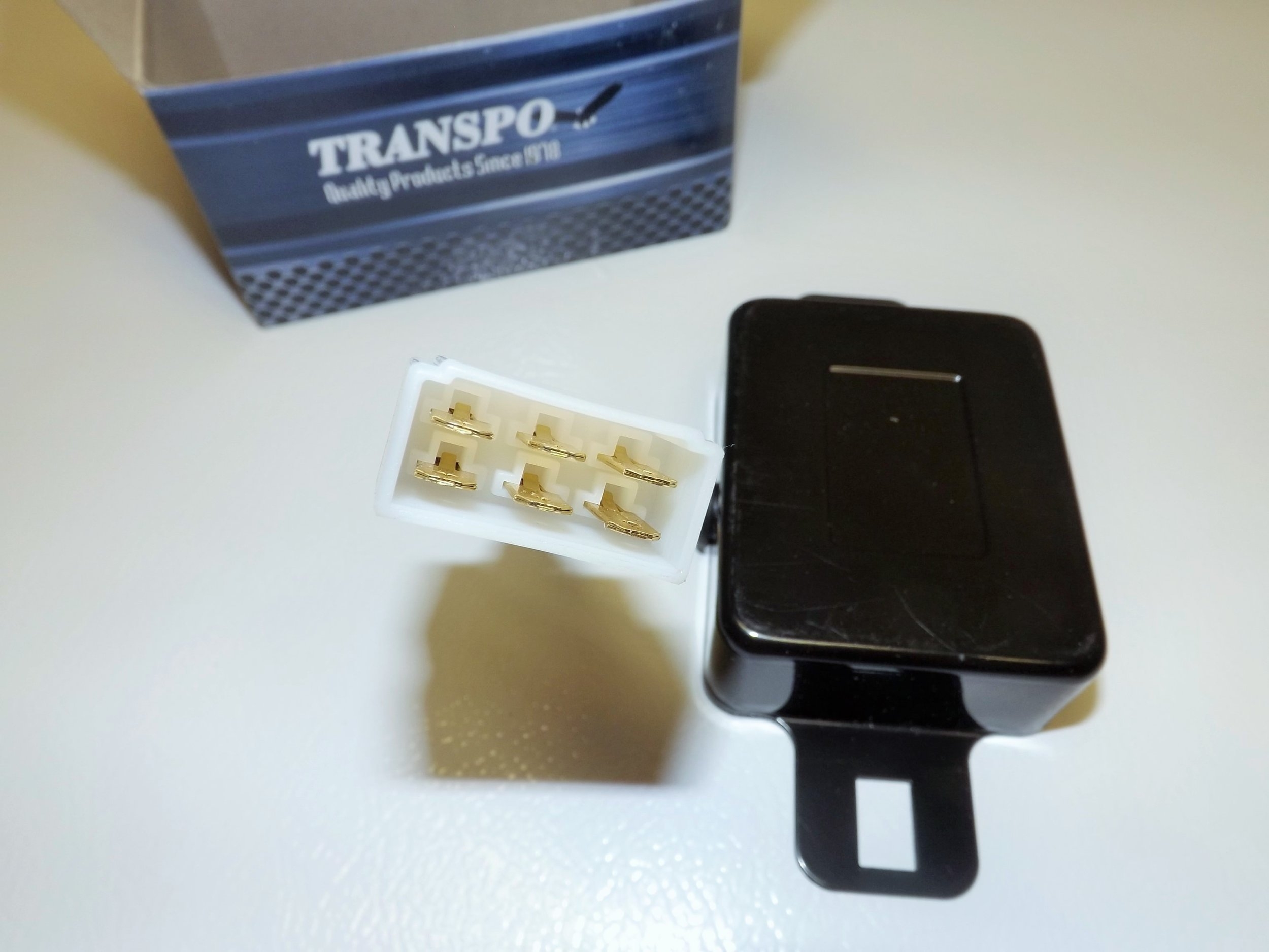

before looking at the battery or the alternator, look to see if the tractor has a voltage regulator (VR). The old Japan tractors typically have these VR devices. The old style normall found is big an bulky. The new replacements are all solidstate and about 1/2 the cost too.
I have a few of the manuals, see the attached for the SD2443. The electrical could be very close as it's an SDxx43 machine too.
Inside the old VR, you will find old school bulky components.
The new solid state reliable devices have 70 less parts and are better.

I replaced my 1980 Ford 1900 v regulator with a solid state one for a Datsun z car. Worked fine for years afterwards.
Here's the wiring diagrams for those regulators and electrics on the cars. You should be able to figure it out with this easily.
   / Shibaura SD2243D charging system #7
the s700 parts book has partial wiring diagram. I can supply a regulator.
