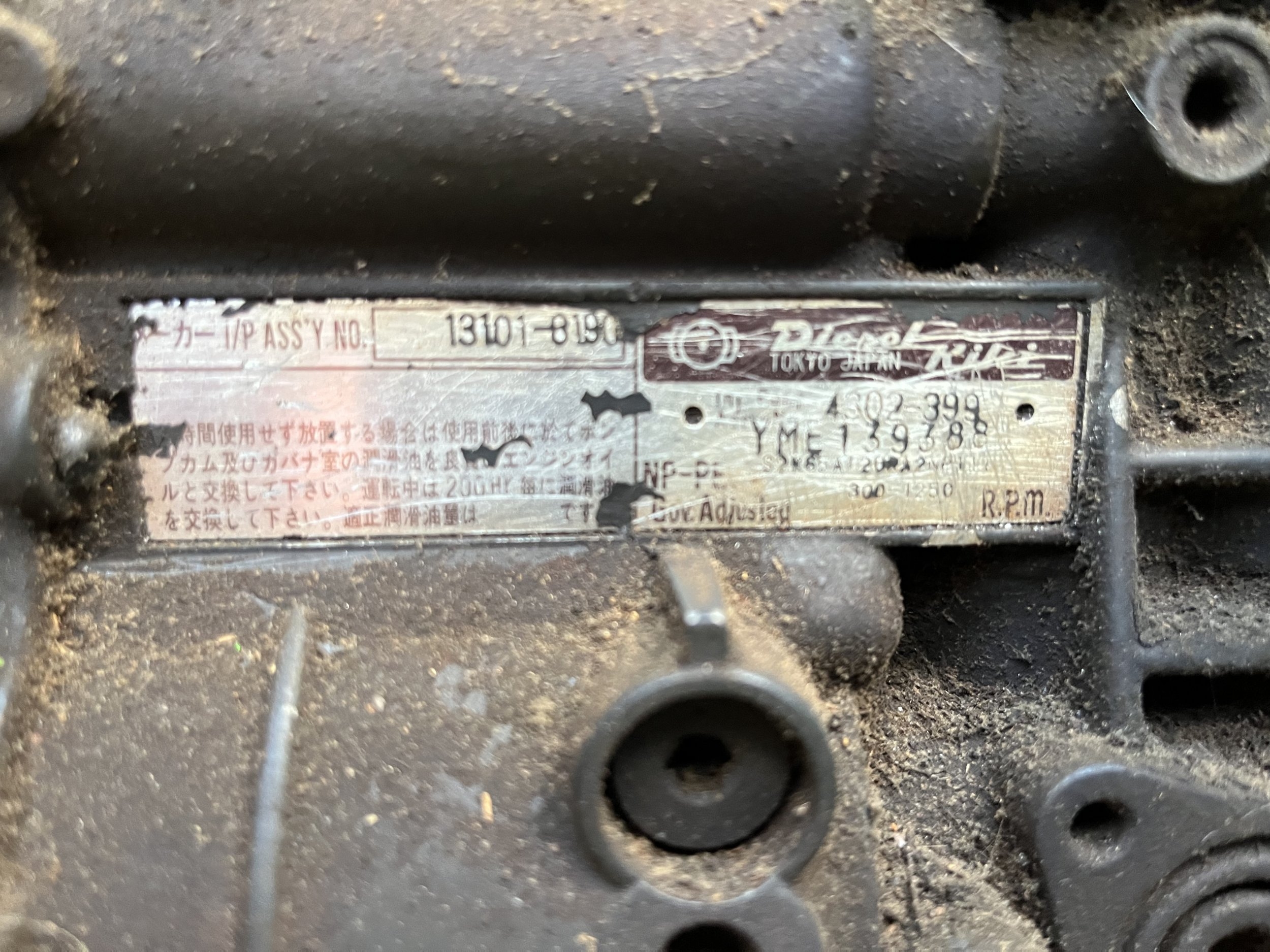

Is the process the same for this pump?

/ Shibaura SD 1800 injector pump issue #6
No..
That’s a KIKI PES PUMP..
DO NOT SCRAPE THE NAME PLATE.. EVER..
