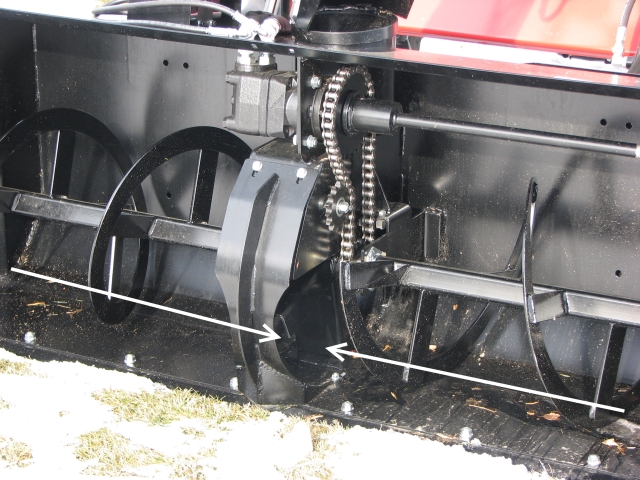

Cost will be significant considering its hydraulic drive (think 7-10K if I was to guess) but even more concerning is the fan section. The fan appears to be almost entirely enclosed and the augers feed into small ports on each side. To me, thats a recipe for extreme clogging in anything other than dry snow.
It would be a nightmare to unclog if it packed up with all those chains and sprockets in the centre, plus all the guarding.
Also the augers have to feed all the snow into the fan and you cant rely on a "ramming effect" to keep the fan full like you can on a conventional blower.
Using the tractors hyd as a resivoir is also a bad idea without external cooling. That's blower would be high flow at 100% duty. It should have an external pto powered powerpack with its own tank.
I think there is a reason that you dont see too many blowers with that style fan. id like to see it in deep, wet, heavy snow, not a few inches of light stuff.

I would say both sides together would have as much or more of an opening than a 2 stage. The 1,100 RPM fan speed would help the clogging issue even on wet stuff i would think.....

The snow is getting pushed into that narrow cavity from augers on both sides, its not so much the total opening size, its the two small openings vs. a single, large, open fan of the same total diameter.
Hydro or not, small tractors have a limited oil reserve. This blower isnt like running a splitter off the aux hydraulics, its much higher flow and will generate considerable heat in the small resivoir. Minimum GPM for that model is 14 GPM. The rule of thumb for hyd resivoir sizing is 3:1, so @14GPM you should have 42gallons of tank. I dont know what the capacity of the 3037 is however, and you can cheat that 3:1 ratio a bit. Still, I wouldnt go with it without a external resivoir and a closed, self contained system. Would you even get 1000RPM under any real load @ 14gpm? I dont know and they dont publish much info on the Sheyenne website.

i would bet that in the video showing the hookup to the kubota tractor shows
there is a pto powered pump system on the 3ph, seeing the large filter mounted up on
the boom near the hydraulic couplers.
/ Sheyenne Concentric Axis Snow Blower??
Yes, They are PTO pump powered. Tractor only pumps 12 GPM including power steering.

I too was wondering where a CUT would get that kind of hyd volume. A PTO pump on the back is a pain.
Nice blower though. Nice that people are trying to come up with new ideas.
If debris or a stone got into that thing at those speeds, it would become a bad day in a hurry.
