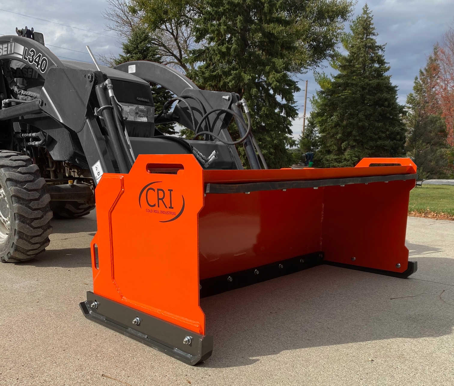

I am also considering the 6' CRI.
I currently have a rear mount 72" blower. I use my bucket as oftent as the blower. I have close to three acers that I keep clear, most of it is turf.
I'm giving strong consideration to adding a 72" snow pusher.
I've not been able to find much info on CRI but I really like the looks of their tool. Any feedback or advice would be very much appreciated. Thanks!
View attachment 1057040CRI snow pusher
I am also considering the 6' CRI now that it is all Poly blade and shoes. I have a Kioti CK3520 with a backhoe....so I think I have plenty of weight. Some of these comments seem to think that a compact tractor won't push appropriately and so I'm now a bit apprehensive. I look forward to the pics.

So here’s the thing. It’s not that a compact tractor can’t utilize a pusher. It’s that people buy too large of pusher for the size of a tractor they have. I had a guy a couple weeks ago, come in for a pusher. We have 4, 5, 6 and 7 foot pushers. The customer had a Mahindra 1626 tractor. I recommended the 5 foot pusher telling the customer that that was the best overall choice for the types of snow we are prone to get here. Instead, he chose the 6 foot pusher even with me recommending the five. I said well if you’re gonna go with a 6 foot then you’re gonna need plenty of ballast outback. He said he had enough cause his industrial tires were filled with beet juice. I said that’s not enough. He told me his tractor has done everything he’s ever asked of it so he insisted on getting the 6 foot. Well, only a few days later we had a 14 inch snowstorm that in some parts reached 20 inches. It depended if you were near the coastline or up in the northern regions. near the coastline we had an 11 inch dump with 3 inches of sleet. It made the snow very heavy. Well, the 6 foot pusher on this guy‘s tractor, couldn’t move the snow.
He waited till the snow had finished and then went out. He called us and said how disappointed he was with the pusher and should’ve gotten a plow blade instead. Not being the type of person to say I told you so, I recommended that he get a Weight box. The plow he wanted cost $2400. The pusher cost $1599 and a weight box would’ve added another $599. Because he was so disillusioned with the pusher, we took it in return and sold himThe 6 foot plow blade he wanted.
I’m not here to figure out people. But I am here to give them the best advice I can based on my experiences and the array of customer’s experiences as well.
I suggested that he get front wheel chains, knowing that the plow blade was gonna push his front end around. He negated on that advice as well.
I sell pushers based on the all-around type of snow we get in this region. If we had gotten 6 inches of fluffy type snow, his 6 foot pusher would’ve done fine but much too often we get snow that has a lot of moisture in it and even 8 inches of wet snow would stop that pusher cold without that tractor having additional rear end ballast. So that’s basically the story on pushers
The weight of snow that it can collect on the front has to be surmounted by the weight of the tractor itself in order for the pusher to be successful.
