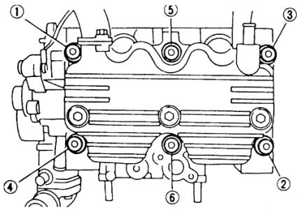

Could anyone tell me the torque sequence for the headbolts for a Shenniu SN254 tractor? A diagram would be greatly appreciated. I was thinking of re-torqueing these as I am checking the valve lash. I have read that it is important to check the torque on these bolts.

Which engine?
//greg//

The model that is listed in the operators book says it is a model 295T. It is a two cylinder. Made by Hubei engine works. 95mm bore and 115mm stroke.
/ Shenniu tractor headbolt torque? #4
Something like this
//greg//
That type of diagram is exactly what I am looking for. But that appears to be for a different engine than what I have.
/ Shenniu tractor headbolt torque? #6
Coming up with a perfect diagram for a odd ball tractor may be tough. What Greg gave you gives you the jist of how to do it. You may have to wing it a little. Remember, its a Chinese tractor, not a 747. Take your time, keep things clean, use educated guesses, and you will be fine.

/ Shenniu tractor headbolt torque? #7
A two cylinder is a two cylinder. Six head bolts. Even though the diagram is not an exact match to your head, the torque sequence is the same

/ Shenniu tractor headbolt torque? #11
95 foot lbs. There are 10 headbolts. Do it in 3 stages.
