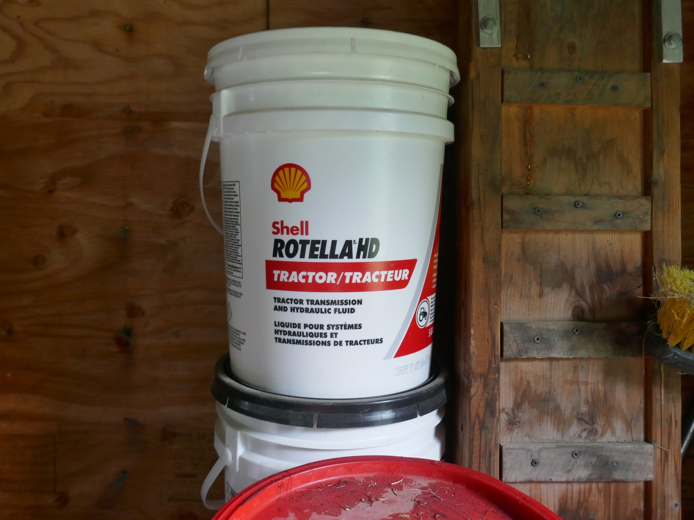

I've been using the Rotella T6 for my engine oil in my Kioti DK6010HSE. I'm at my 400hrs and need to replace all the hydraulic fluid now. The manual recommends the following
Daedong: UTF55 or equivalent fluid oil
Equivalent options include:
Shell: Donax-TD
ExxonMobil: Mobilfluid 424 or Exxon Hydraul 560
BP: Tractran UTH
Would the Shell Rotella HD be a viable replacement for these?

I did find this advertisement from rotella, which seems to say it may work just fine. But i always followed the mfg required fluids while mine was under warranty, than just kept using it after warranty.
   / Shell Rotella HD for Kioti DK6010SE?
I wouldnt think so, as the rotella is an engine oil. Im not positive, but i would assume as an engine oil its going to have different additives from a true hydraulic oil. Also viscosity issues. Ive been using Donax myself for hydraulic oils.
But im no expert. I guess you could ask your dealership mechanic?
The Rotella HD is hydraulic fluid. It was previously called Donax TD. That alone mostly answers my question since that is the name the manual references. I just wasn't sure if it just a rebrand or if something has changed with the formulation.

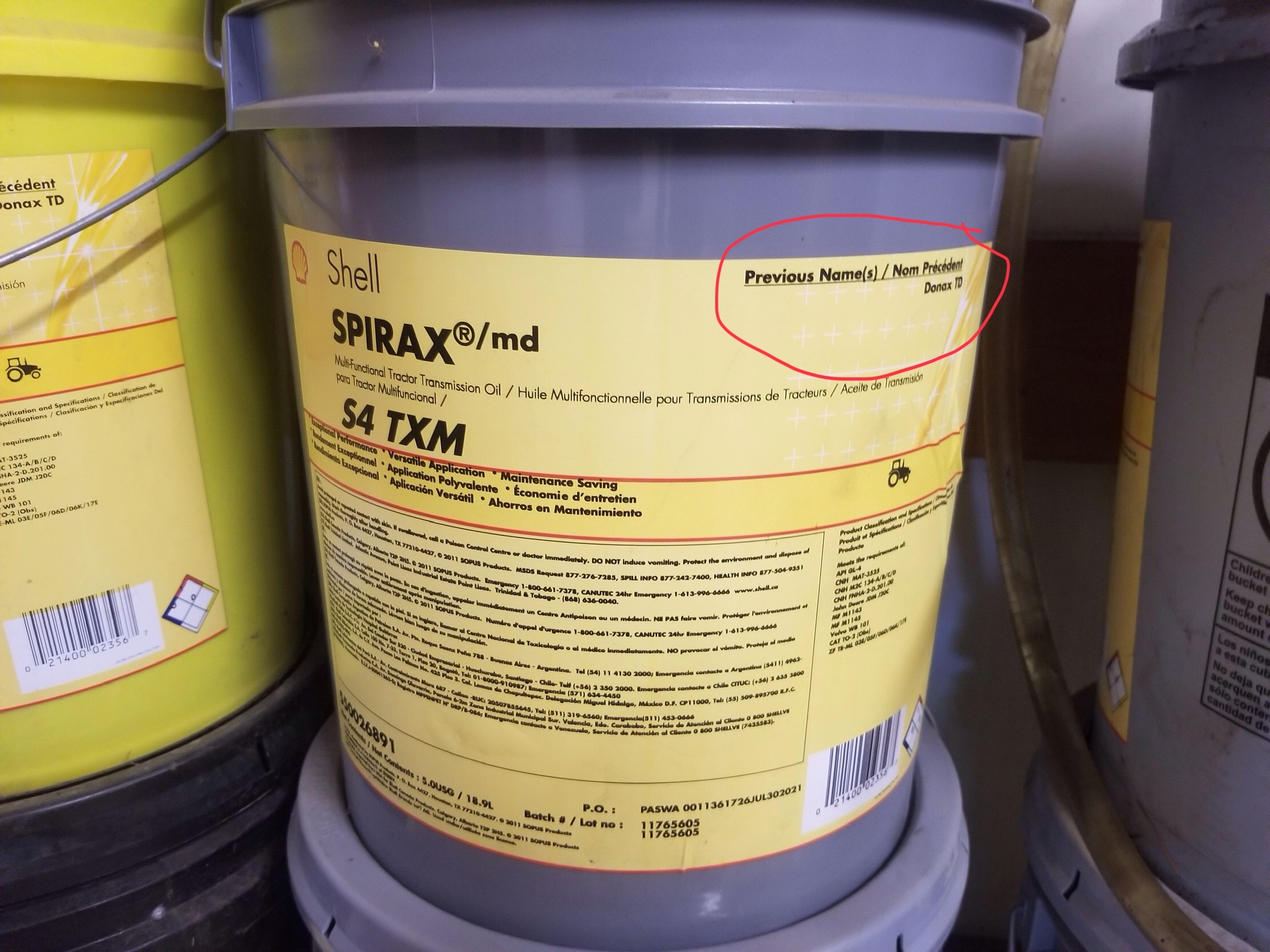

   / Shell Rotella HD for Kioti DK6010SE? #4
Donax-TD is still sold, i just purchased 10 gallons of it.
Edit… i goofed up, its now called spirax s4
But says donax on can.
