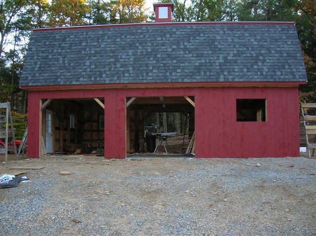

Hey bearhawk, very nice barn. Has the project been completed yet? If you don't I was curious what you paid for the barn? What are your plans for the second floor? I am looking sometime in the future to build a garage/ workshop about the same size in dimensions. I to live up here in nh and in need of another garage. I have a 24 x 28 garage already but the two trucks and some lawn and snowthrowing euip. pretty much takes up all that space. I have a 12 x 16 shed in the back and have my tractor and loader in there but I think I am pushing the design limits of the floor just alittle. Any way, very nice looking barn. Your town is going to love increasing your property tax. LOL. Russ
It's mostly done, I haven't finished the wiring yet.
I built it with the help of my BIL, or my BIL actually built it and I slowed him down a little.
Costs in big round numbers in 05
Floating Slab 4000
Rough Cut Hemlock Framing 3000
Ship Lap Pine Siding 3000
Roof Trusses 3600
It gets a little fuzzy after that, Sheathing, Roofing, Second Floor T&G, Custom VMatch Doors, maybe 5 weeks of BIL time
Second floor is some Hay storage and just regular storage.
If you are in NH you already know what the Property Taxes did.

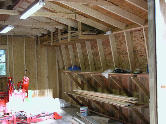

   / Shed Help Needed
#12

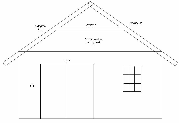

So how would you all go about spanning 16 feet? Should I prebuild trusses using 2x8x16 for the celing joist and 2x6x12 for the rafters? I could joint them together with gussets in order to make the cutting easier (no birds mouth). Or should I place the cross support up higher and use a shorter board? I I would like to do this in the middle of the shed and have the storage at either end.
   / Shed Help Needed #13
You are going to need the angled cross bracing in the roof truss areas if you use 2X4's. If I recall maximum unsupported span for a 2X4 is about 6'-7' depending on the application. You are going to have 7/16 or 1/2 sheething, roofing felt and shingles up on top I assume. That is a lot of weight and a long span unsupported 2X4 will sag under the weight, not to mention any additional load from snow/ice if you get such. To go unsupported over the span from wall to peak on a 16' shed, you will need 2X6's.
Also as mentioned, that center vertical does nothing unless it is to a load bearing cross beam or wall beneath it. They are not used in typical roof trusses as they would just transfer a bend force to the joice. The strength comes from the 2 rafters meeting at the peak of the roof like the peak of a large triangle. Downward weight forces them to spread at the bottom and the cross joices(in tension) hold the bottom ends and the top of the walls together. Angled braces between joices and rafters transfer the load to the joice more as a compression and tension load and do not apply as much bending force to the joices.

Ok here is my revised drawing. I would us 2x6x12s as the rafters and 2x4x8 as the collar ties. For the ridge board, I guess I would use a 2x8x16. The roof pitch pitcured is a 35 degree slope. Keeping the rafters at 12' long would give me about 1.5' overhang which sounds good.
As for storage, I could always add ceiling joists later or try another design.
I am trying to build this thing using precut lumber dimensions in order to reduce cutting and waste.

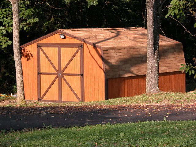

I built this 16' x 20' in '02 and cost me a little over a grand. Wood has skyrocketed since then (Iraq and the housing boom). Most of the base was there (from my old, smaller shed). The base is 6" x 6" perimeter with cross members at 8'. As you can see it has a gambrel roof. The roof is 1/2" OSB. For the base I filler inside the 6"x"6's with gravel and covered them with OSB. Each door is a 4x8 sheet T1-11 with a 2x4 perimeter frame. These were sized to accommodate the BX-22 without having to fold the ROPS. The roof dimensions were sized for 4' and 8' dimensions to use full sheets (no sense wasting wood).
It has stood the seasons w/o any problems.
paul
