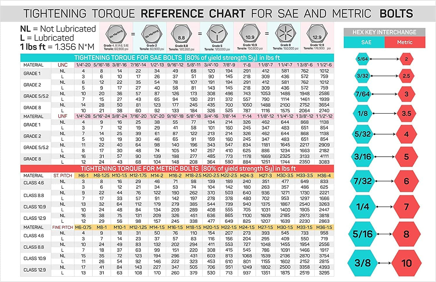

Leaving this here for reference.

ASTM A307 (structural) is nearly identical in strength to SAE Grade 2 (mechanical). The top is clean with no marks. This is the cheap grade you can buy at nearly any hardware store.
