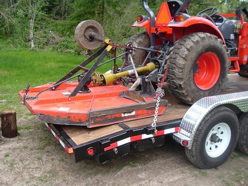

Kioti CK30, 30 HP, the PTO is solidly engaged with a lever. Ahead of the HST there is an engine clutch with a pedal. I idle the engine, disengage engine clutch, throw PTO lever to ON, slowly engage the clutch (slowly turing PTO), and then increase RPMS to PTO540. Blades spinning full speed and the HST allows variable speed and direction without clutching or slowing blades.
I love my slip clutch.

Your system works like a 2 stage clutch setup.. in that you can clutch engine and pto by hitting the clutch, or just stop drivetrain momentum by using HST pedals.
