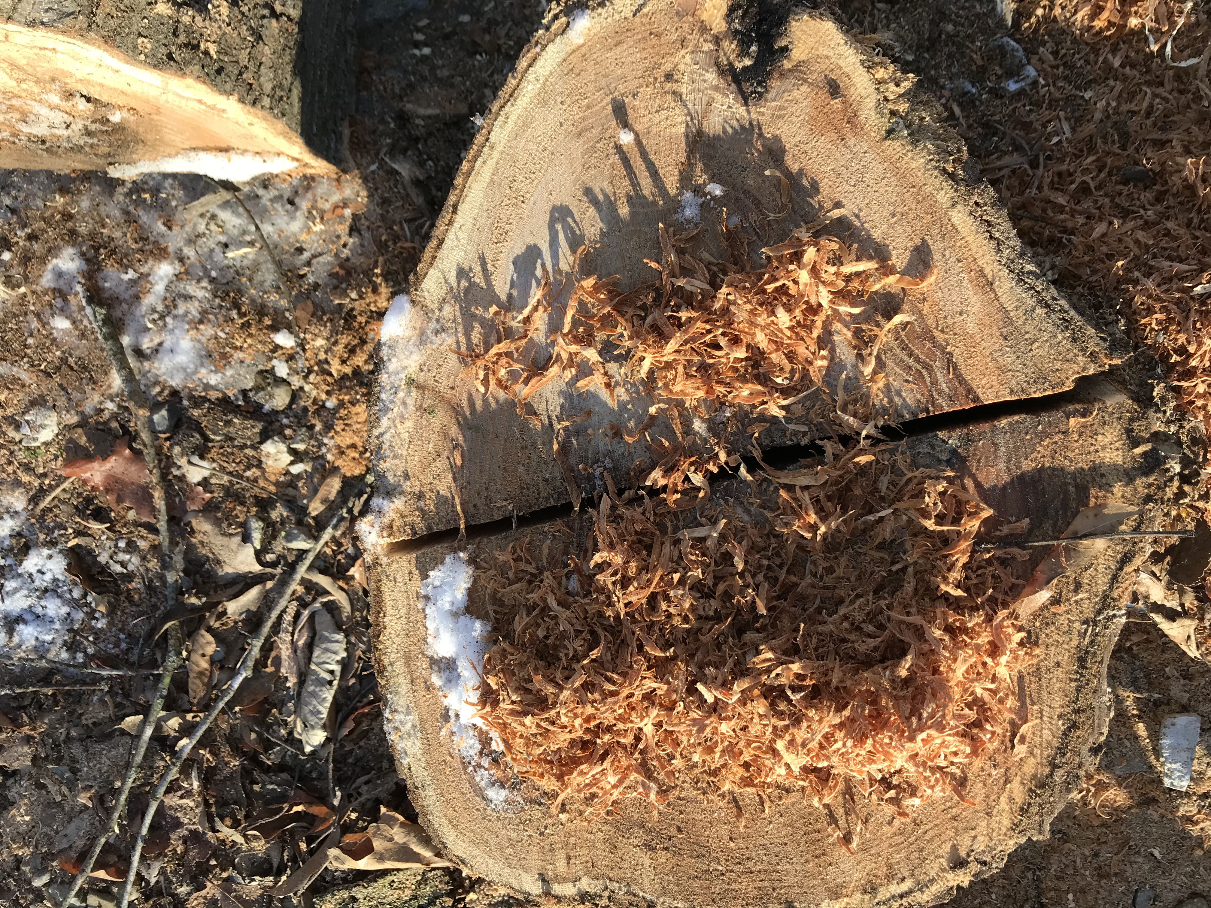

Much better today, I came at it from the side. Seems obvious now what I was doing wrong but what’s the saying, the only stupid question is the unasked one. I was doing this several months ago correctly and like Ford850 said, the saw did plug up once in a while. The MS261 seems like a heck of a saw for its size and weight, pretty happy with it.

Cutting against the grain as you are doing is tough on a chain and the saw. Yu need to have some good HP to do it.
A skip tooth chain will help a lot when making cuts such as this. You aren't taking as many bites of the log

Just to be clear my last picture is not how I made my cut, I just have the round oriented that way to show the chips. I made the cut going through the side, the bark side. In the pic I have cut about 90% of the way through it and flipped it so the saw would not hit the dirt. Doing it the correct way is actually really fast and easy on the saw as long as the chips do not plug up. I have noticed the newer MS261 vs my older MS250 seems to have a touch more room under the cover to clear chips better.
