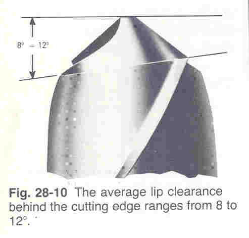

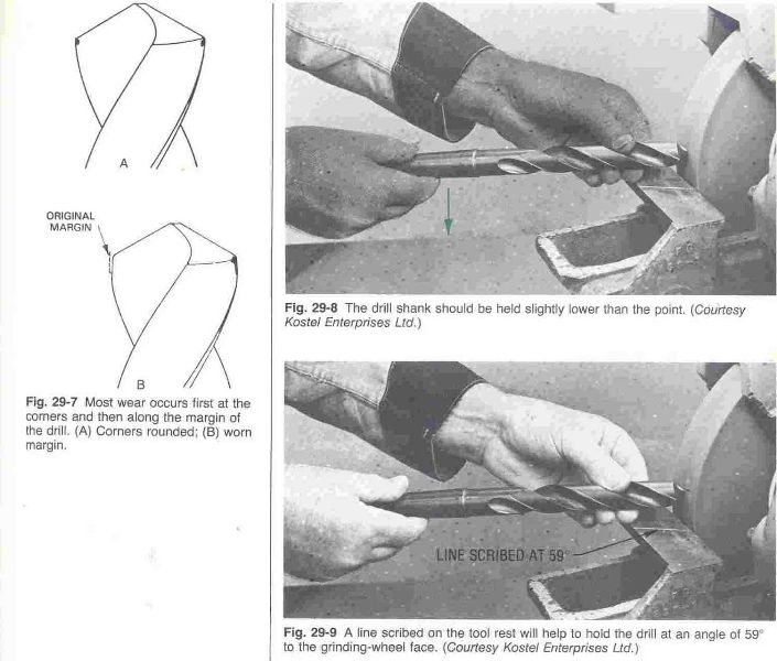

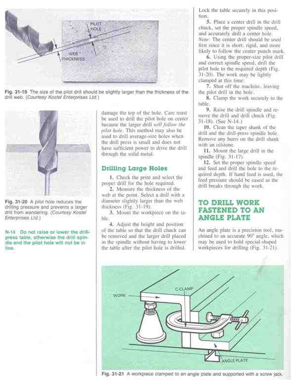

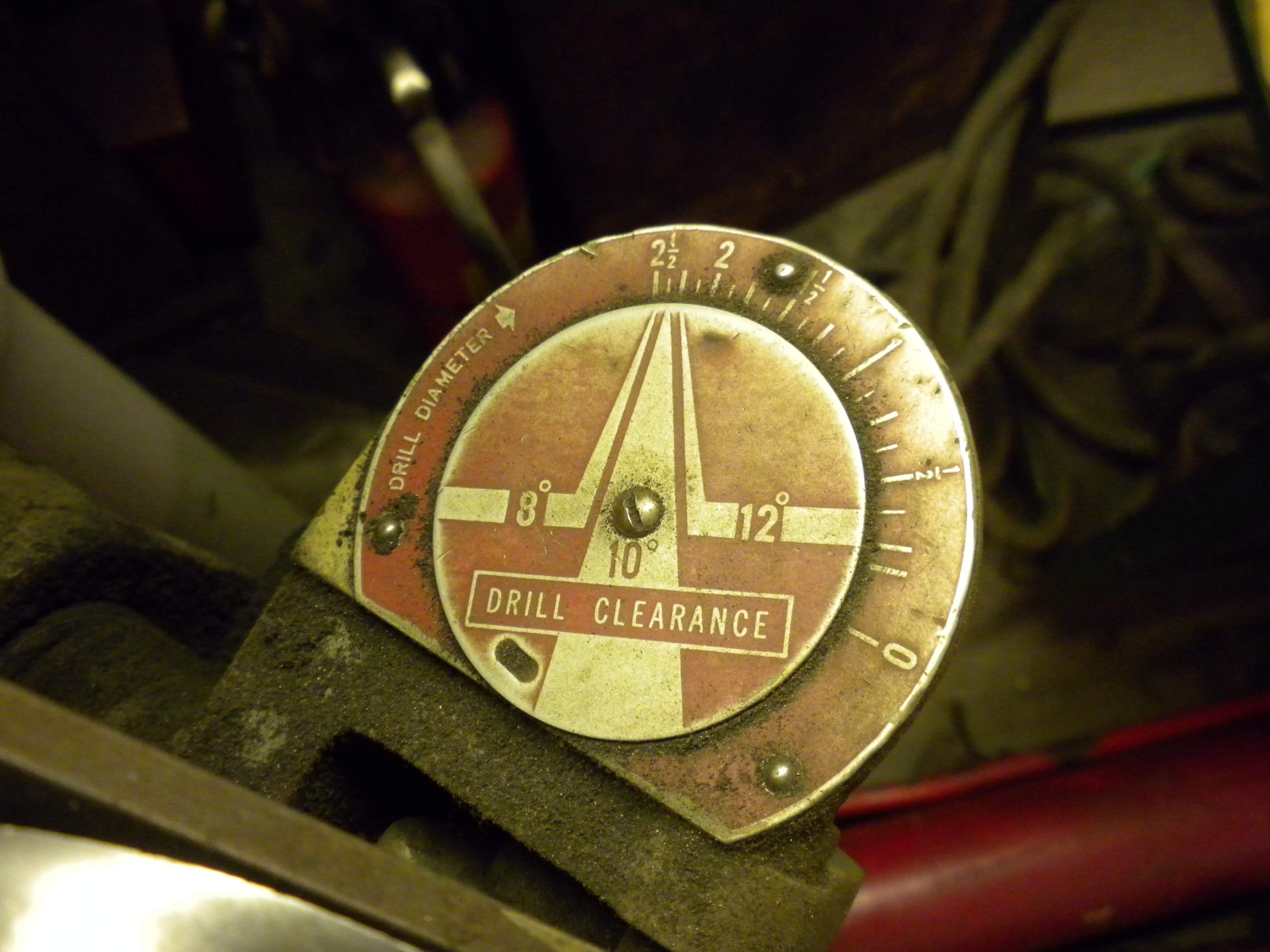

I was given a Drill Doctor years ago. I gave it away, took too long to get the bit in the holder. I'm just use to doing it by hand.

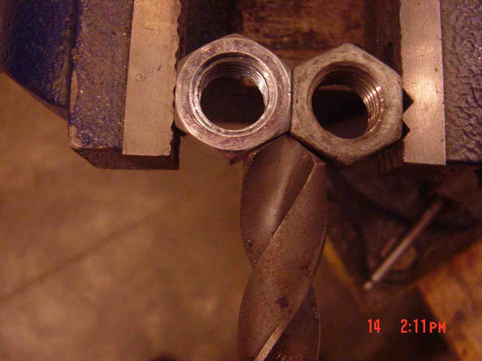

I re-sharpen HSS drill bits only. I do not buy the coated ones for the simple reason that the coated bits can not be re-sharpened and last anytime at all because the coating is gone.
I do them by hand on a bench grinder and utilize 2 hex nuts super-glued together for a 120 degree visual reference comparison guide when grinding/sharpening the bits. This low cost poor man's comparison guide allows me to get close enough to the factory's 117 degree O.E. angle. If a bit is badly mangled then one should only grind a little bit at a time and let cool so as to not remove the temper from the bit. If you see blue colored areas on your freshly sharpened edge then you ground too much too fast and got it too hot - the edge will not last.
