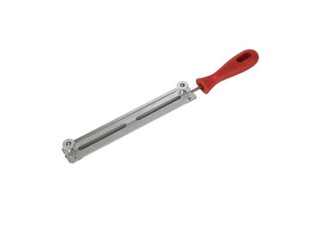

I use this thing, there is a guide for the angle, and you can't screw the depth it works pretty good for me. As for file I am not sure a file is a file but I think I use Oregon. I simply buy lots, I am not scared to throw it out and grab a new one.

I use one like @Rockbadchild shows. I also have a small flat file and a gauge for lowering the rakers. It all came as a kit from Stihl. I’m about 75% with my sharpening. I get good chips but also a little sawdust, which means some of the teeth are less than perfect. It helps if I actually use a magnifying glass to look at them afterwards. I think sometimes I’m a little low on the tooth with the file. I improve the more I do it.
I've found this to be better than using a dremil tool. And that's just my opinion.
