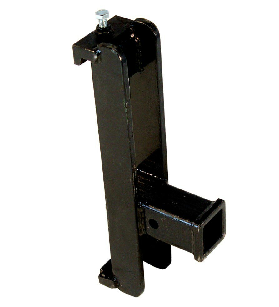

If you have pallet forks, use this.trailer_hitch_receiver_for_pallet_fork_frame_4_.jpg

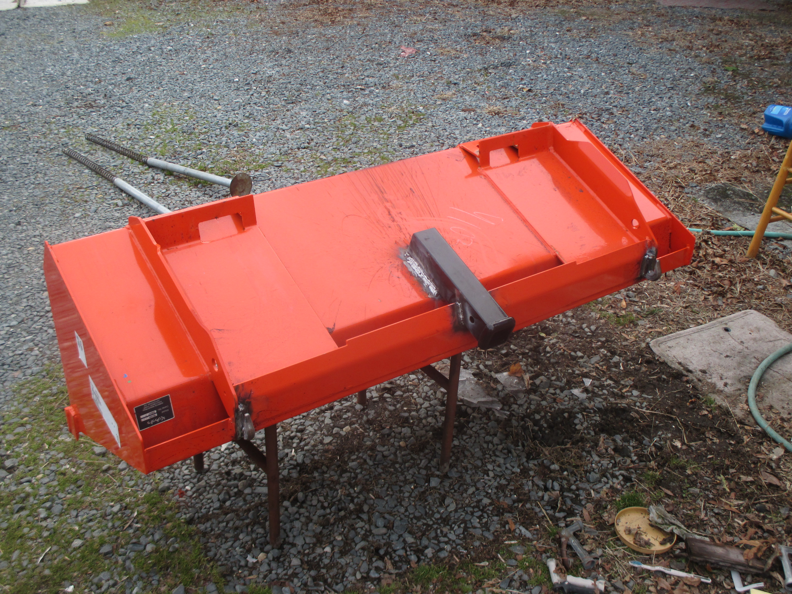

both tractors have SSQA and I have a three point hitch/2" receiver on a SS plate, however it's easier to move a 2" receiver hitch than the plate so i have welded a 2' receiver on my kubota bucket, (also dad's little JD 2210) both work very well. i don't know how well you can see the SS plate on my JD in the pics but it's there.

... welded a 2' receiver on my kubota bucket...
That's doing it the right way, mounting the receiver where you roll the bucket forward to get the hitch ball down low under the trailer. I welded my simpler ball mount on the little Yanmar (photo above) with that in mind.
My other elderly Yanmar came with a ball bolted to the top lip of the bucket. Not very practical, you have to wind the trailer jack to the top before it's high enough to set on that ball. Even considering that this bucket isn't as tall as most loaders.
