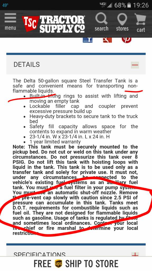

What about the pickup bed tanks on construction sites?
   / Share Pics of People Hauling or Towing Something Wrong #4,342
Tanks in truck beds, as designed, are more protected. And also normally only carry diesel fuel. Ive never seen gasoline on a construction site in anything other than 5 gallon or smaller cans. The explosive aspect of gas is a much higher risk...
Once you hit 110 gallons of capacity, hazmat/tanker/CDL things come into play... Which is why most bed tanks max at 105 gallons. Put in 2, not legal in the eye of DOT. Beware...

You better hope a VA State Trooper doesn't ever stop you. It's legal to haul diesel in those type of tanks, but not gasoline (or anything flammable). They come down on people hard for that sort of thing in my part of the state. There's probably a tag or sticker on the tank with the regulations, so you won't be able to claim you didn't know.
Agreed. I'll do lots of things and readily take calculated risks but won't haul gasoline like that. Lot's of things can go wrong including nothing but static. Then boom; fireball.
   / Share Pics of People Hauling or Towing Something Wrong #4,345
For what is worth right from TSC product description. uploadfromtaptalk1477870576760.jpeg
