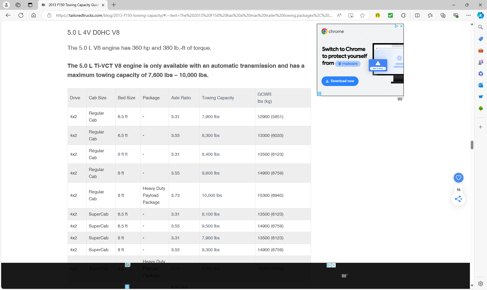

But not all 1/2 tons are the same. My ‘13 F150 with HDPP has a heavier frame, heavier suspension, heavier shocks, LT tires and brakes that are almost as big as a 3/4. On top of that it has a CCC of 2592 lbs (more than some older 3/4’s) It tows my 8000 scale weight trailer just as well as a 3/4 and has more ccc than some current diesel 3/4’s
You know that door sticker has nothing to do with how much you can tow, right?
You need to look up the GCWR for your truck's configuration. It won't be in the Owner's Manual (they are just generic); you'll have to contact Ford for the info.
No matter what your CCC is, you can't legally exceed the GCWR for your vehicle.
GCW = truck curb weight + weight of all passengers in the truck + weight of all cargo in the truck (not just the bed, also anything under the seats etc.) + weight of trailer and its contents.
If this value is greater than GCWR then you are not legal (or safe).
Many people just look up the tow rating of their truck and go with that, but you need to use whichever is less between the tow rating and GCWR.
   / Share Pics of People Hauling or Towing Something Wrong #20,670
Geez... you make it sound like he needs to call Henry or Edsel, himself. :ROFLMAO:
Maybe you haven't heard, but Al Gore invented this thing called the "Internet". All kinds of great information there.
Ford has wiped their site of data that old, but it can still be found on third-party aggregators, like this one:
Just a small snippet below, as a sample:
