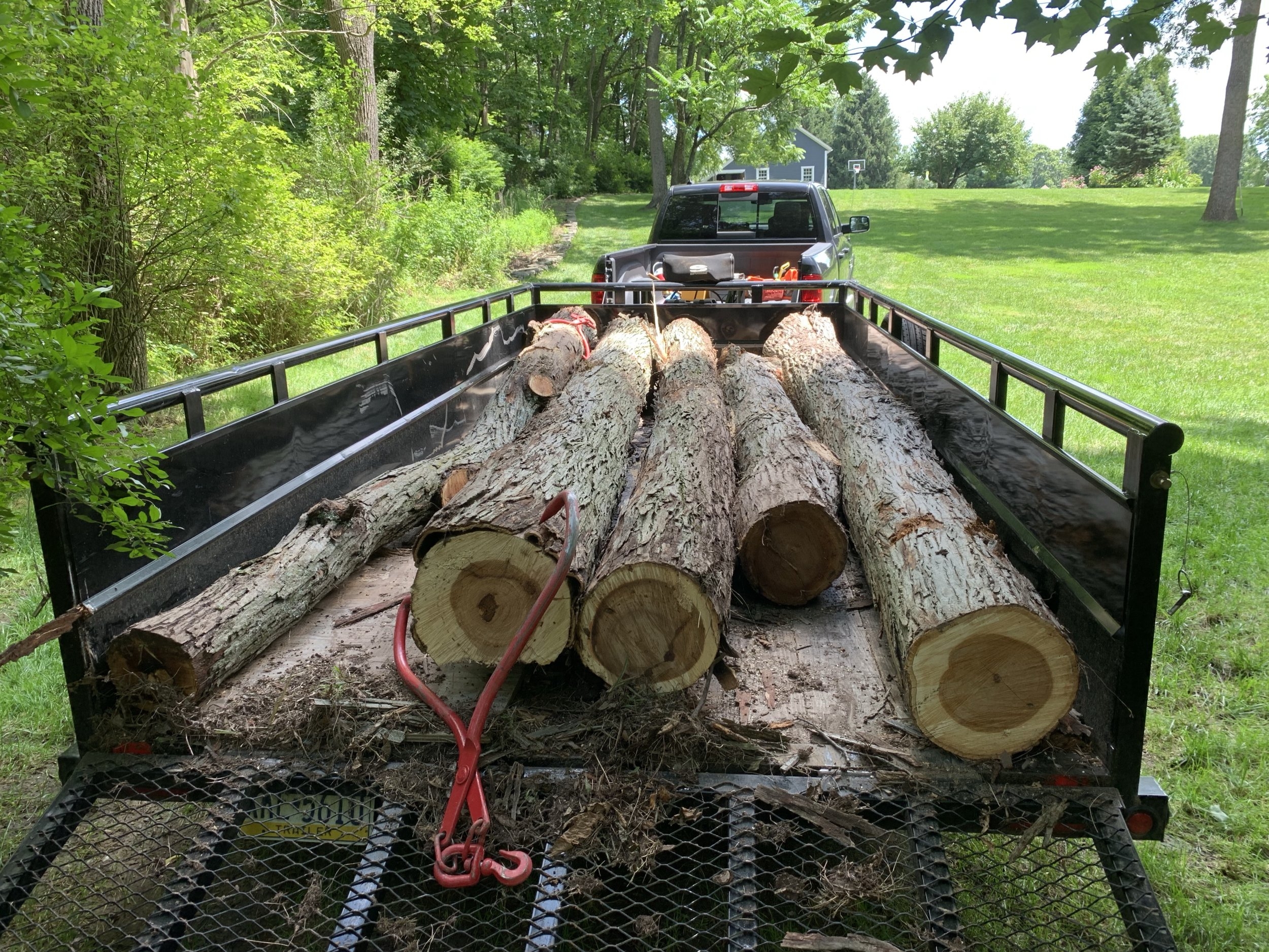

This is exactly the same system I have. 1/2 ton crew cab with heavy-duty rear springs + 7000 GTWR trailer with 16' closed-side box and ramp. Way easier picking up 12' or 16' lumber in that trailer, than in any pickup, even a "long bed". Plus, I use the trailer for hauling firewood, and mounted a winch on the front for fast retrieval of logs, rather than heaving rounds into a stupid pickup bed. I haul maybe 10 loads of logs per winter, from various sites to my house.
Trailer is also a great way to move your tractor, either for work or repair.
I probably should run a weight-distributing hitch, but so far haven't bothered, as all my heavier hauling is real local.
Looks similar to my BNM Trailer Sales from Michigan. Any chance the same manufacturer? Jon
That's a Big-Tex Vanguard 70TV. Not sure if BNM is private-labeling Big-Tex, or the other way around, but wouldn't be totally surprised either way.
   / Share Pics of People Hauling or Towing Something Wrong #20,135
I have been to BNM's shop among a farming community. Small shop, started by dad years ago and the boys grew up in the business and have since taken over. Not sure they would have any connections to other manufacturers. Been happy with the two I had/have. The 16ft looking like yours they incorporated items I wanted and increased the weight limit for my needs. Plus they painted it instead of using powder coating like my previous one (that peeled from improper preparation). Jon
