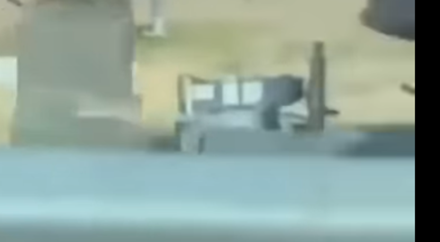

Couldn't tell what kind of break-away brakes it had; didn't seem to work.
My 2021 car trailer has a break-away system with battery. I don't know how to test it, but do ANY of them actually work?
   / Share Pics of People Hauling or Towing Something Wrong #19,932
Interesting both hitch and safety chains failed. Couldn't tell what kind of break-away brakes it had; didn't seem to work.
From about 0:17
Bruce
   / Share Pics of People Hauling or Towing Something Wrong #19,933
Good catch! I've worked on a few of those hydraulic brake trailer systems. The cross/slider bolts are super critical, this is what happens when they fail. I don't like 'em.

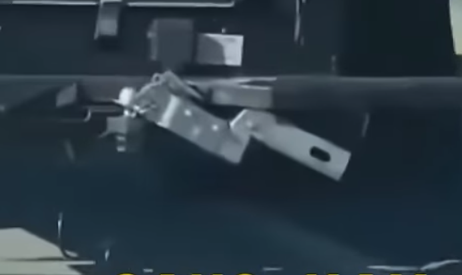

From about 0:33 showing front of trailer.

Kinda hard for the safety chains to be of use when the trailer tongue breaks or disconnects mid-way. There definitely should have been breaks though.
Safety chains should have been attached to the frame of the trailer, not the sliding hydraulic brakes mechanism.
