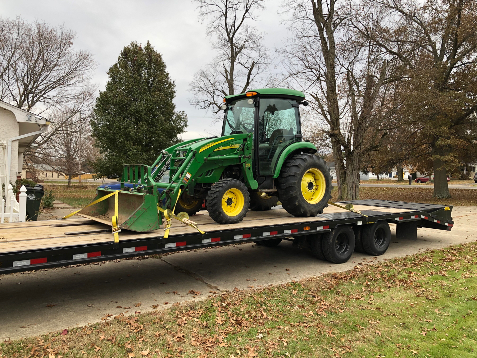

Sold a tractor today. Hauling Guy that came to fetch it had an unusual way to strap it down lol and was unprepared to haul the tractor.
I suggested to him, 2 straps on front, one around the axle just behind both front tires and a 3rd strap on the drawbar with a shackle. Then one strap on the bucket sitting on the pallet forks with back pressure to the forks.
He fished one strap threw the loader cross member, after I verbally suggested I wouldn’t do that because it could be hard on the loader pistons if the tractor moves. He put two straps diagonally across the bucket. He had a puzzled look on his face on the rear, I asked if he had a shackle and he said he didn’t, so I got in my car and gave him one for the drawbar.
I gave him a plastic bag and some zip ties to cover the exhaust since it’s front facing and tractor has a turbo. I even gave him zip ties to secure his slack straps because he didn’t bring tape or zip ties lol.
He had a real nice rig though, dually tandem trailer pulled behind a newer F350 I believe.
Running those straps down and hooking them like they are can easily be a problem also. Get a little slack in the strap and the hook turns loose. Always best to poke the strap hooks through the rub bar and then hook them back on top of the rub bar. That way even if the strap gets some slack it still stays hooked up.

That whole tie down job is a joke. The rear can slide all around the place. I agree the bucket and cross tube might cut the strap and I would also just use chains and binders.
Sad thing is it was probably fine and the guy will continue on ignorant as usual

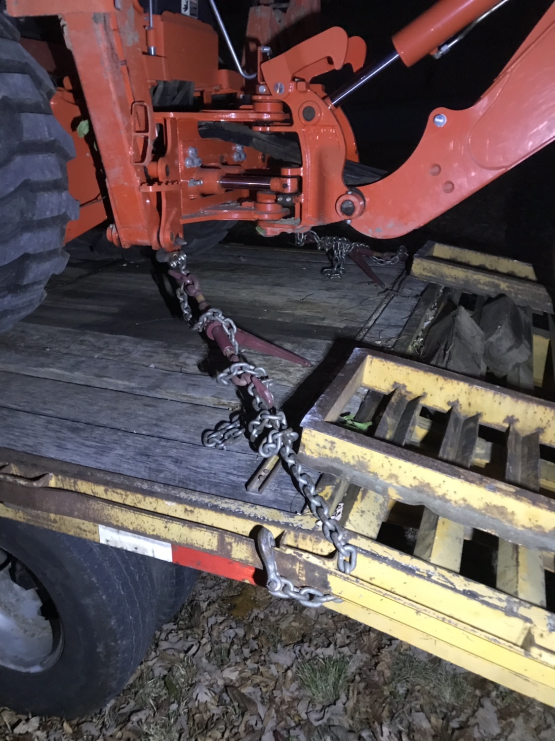

I’d abandon the straps all together. They’re too likely to get cut. Sometimes I use straps to secure additional implements but they always get protection under them. It’s legal not to for equipment under 10,000 pounds but I usually use 4 chains. And he hooked the straps wrong. They should be hooked so that can’t come off if they get slack. If you’re in Canada you’ll have to do something else because straps aren’t allowed outside the rub rail. IMG_7849.JPGIMG_7851.JPG]
