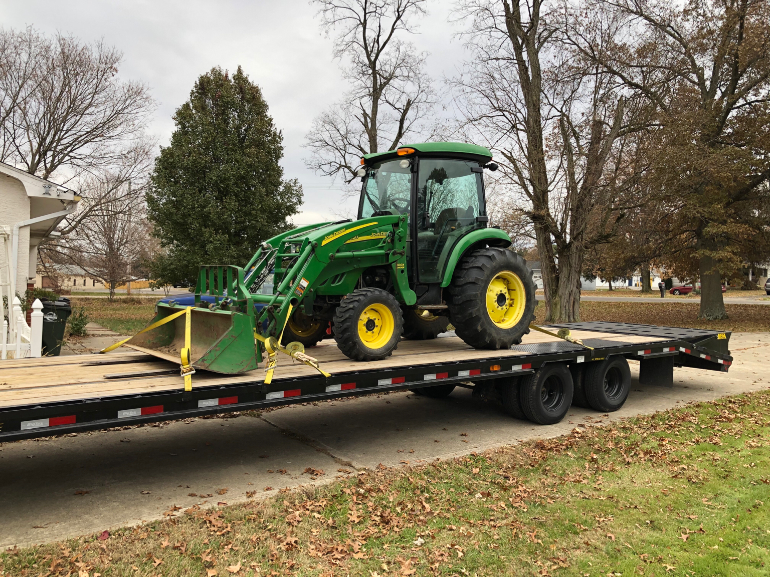

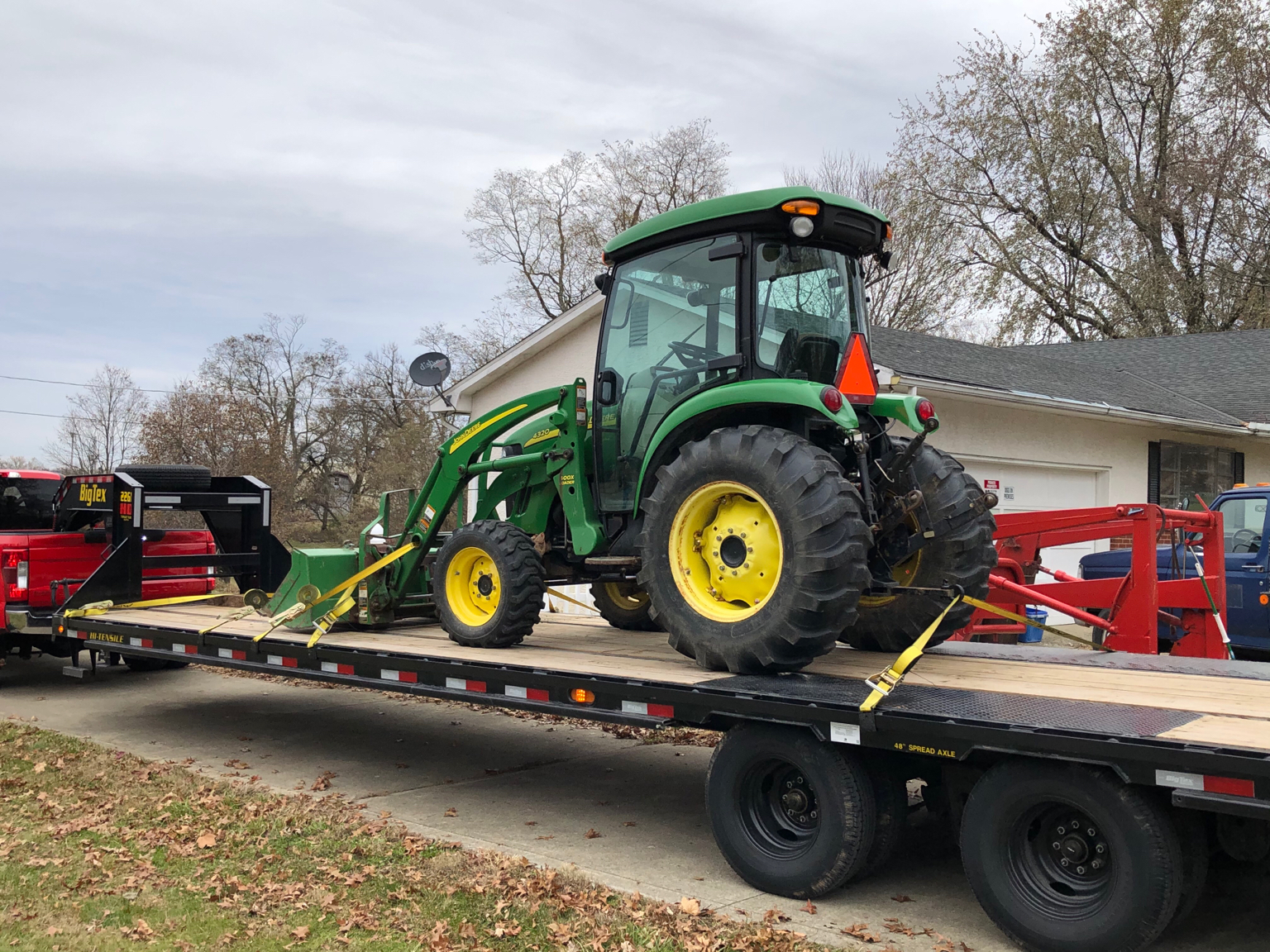

Sold a tractor today. Hauling Guy that came to fetch it had an unusual way to strap it down lol and was unprepared to haul the tractor.
I suggested to him, 2 straps on front, one around the axle just behind both front tires and a 3rd strap on the drawbar with a shackle. Then one strap on the bucket sitting on the pallet forks with back pressure to the forks.
He fished one strap threw the loader cross member, after I verbally suggested I wouldn’t do that because it could be hard on the loader pistons if the tractor moves. He put two straps diagonally across the bucket. He had a puzzled look on his face on the rear, I asked if he had a shackle and he said he didn’t, so I got in my car and gave him one for the drawbar.
I gave him a plastic bag and some zip ties to cover the exhaust since it’s front facing and tractor has a turbo. I even gave him zip ties to secure his slack straps because he didn’t bring tape or zip ties lol.
He had a real nice rig though, dually tandem trailer pulled behind a newer F350 I believe.

From other discussions I have seen,, using straps to tie down ANY machine is cause for an instant ticket in some states,,
I would never use straps for a machine that large,, only chains,, but,, that is me,,
I have also seen guys say you need to be careful about running straps across a bucket,, it will make the strap fray,, :eek: - :confused2:
The only way I would use a strap is to hold the hood down, or keep the doors closed,, but, that is me,,, :)

Same for that one running through the tubing.
I'd be surprised if it wasnt 'dancing' in the rear with that strap configuration. I would have have used one strap for each side on the rear.

That whole tie down job is a joke. The rear can slide all around the place. I agree the bucket and cross tube might cut the strap and I would also just use chains and binders.
Sad thing is it was probably fine and the guy will continue on ignorant as usual

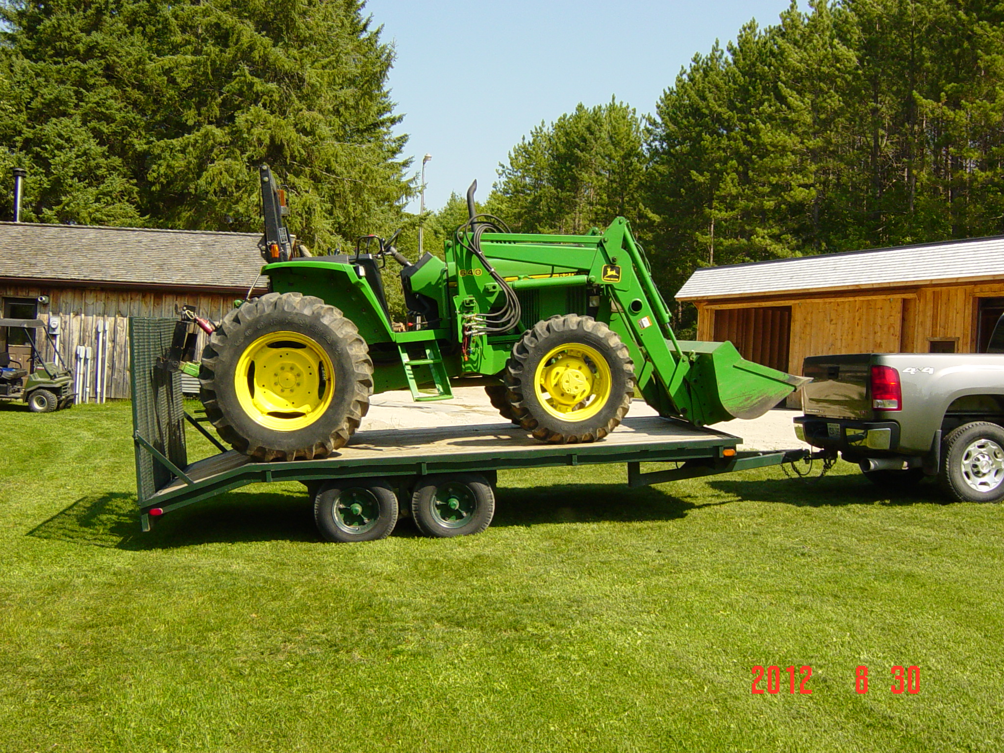

I was only playing when I took that JD 6200 on the trailer picture. I was selling the trailer and thought I would make like a "Serving Suggestion"
