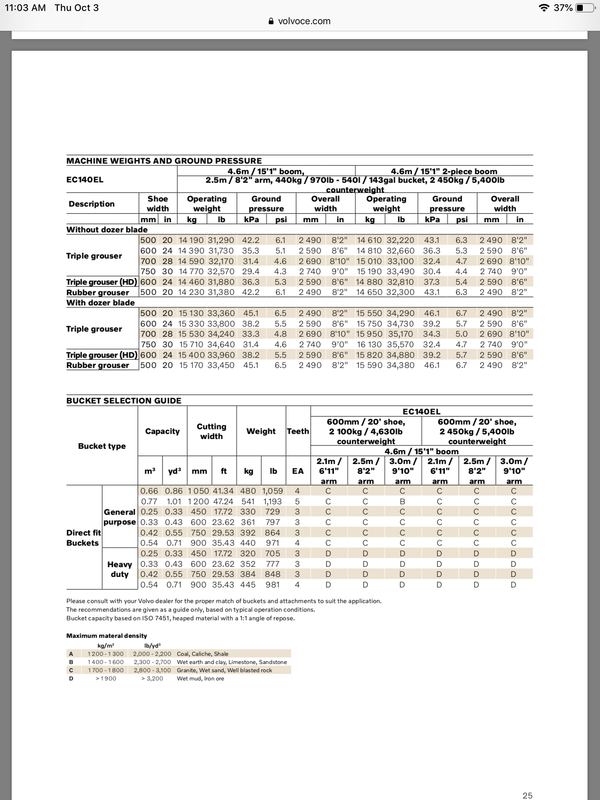

Saw this, on Facebook. 31k-35k machine on a dual tandem trailer behind a F350 or F-450 pickup.
There are 3 axles on that trailer. The Volvo excavator specs at around 29,000 pounds. If it is a F450 it could have a towing capacity of 34,000. Still over capacity, given the likely trailer weight, though.
   / Share Pics of People Hauling or Towing Something Wrong #10,987
I missed the third trailer axle.
According to Volvo, it’s 31k-35k:
Even at 30k, plus 7k, for the trailer, with 20% tongue weight = 7400 lbs on the truck. At 25% tongue weight, that’s around 9,259 lbs tongue weight.
Ford likes to list their gooseneck tongue weights with 10-15% tongue weight, but most trailers (with a load) will put 20-25% on the tow vehicle.
Most vehicles are rated for marketing. They run out of payload long before “towing rating”.
