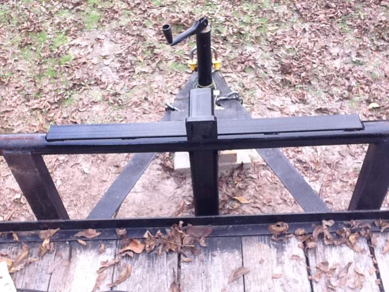

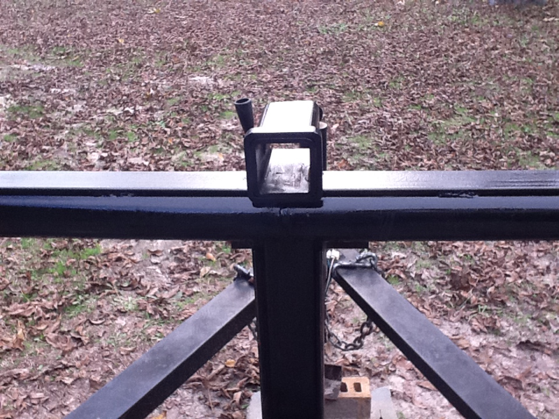

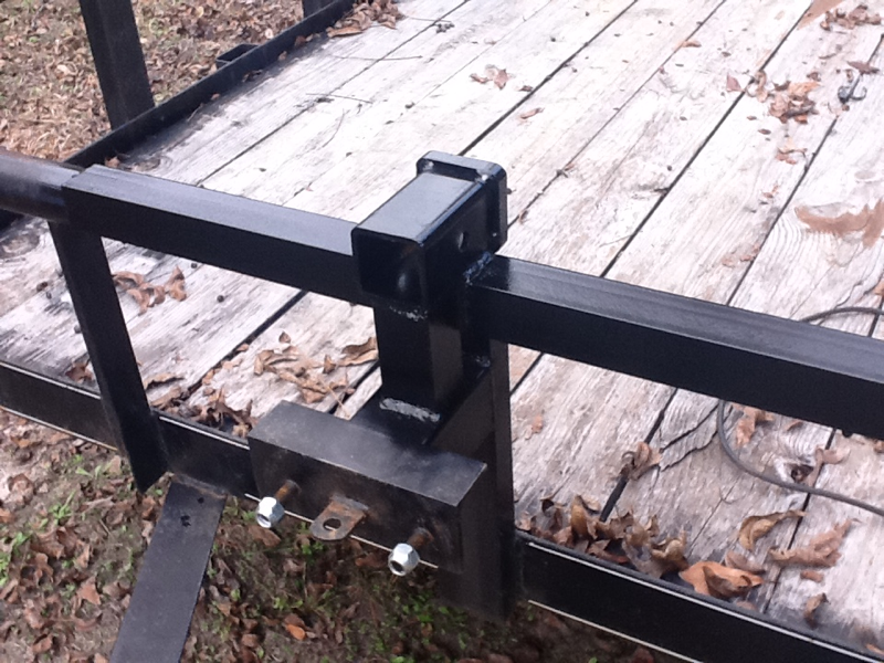

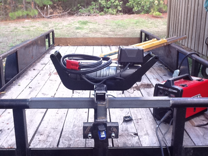

We added a bracket for a winch onto a utility trailer. The winch is in a cradle which slides into the receiver.

I like that set up, that means you only need one winch and you can move it from truck to trailer.
Was this your idea?

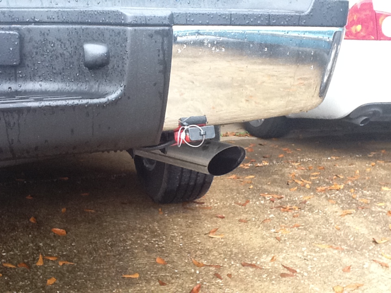

Yes. I have receiver hitches on both the front and rear now, and am planning to add a removable receiver hitch to my trailer and the flatbed of my truck. Planning to run power cables to the front and rear of the truck. I have a long jumper cable with the SB350 connectors on it that I can use to power the winch when it's on the bed of the truck. I haven't run any power cable yet, trying to figure out where to attach the plug near the front hitch. I know where I want to put it on the rear, but need to get a long piece of cable to use.

Did you use 175 or 350 amp connectors? I was a bit surprised to see that under full load, my winch draws almost 360 amps. Might be something to check on.

As for the removable receivers, that was a big deal for me. The trailer doesn't have a rail like yours, and the jack is mounted right in the center at the front of the bed. Even if I wanted to weld a receiver on, there wasn't a really ideal spot.
Since I didn't want a receiver all the time, and didn't have anything to tie it into even if I did, my solution is a removable crossmember. I'm planning to use some 4" square tubing with a 1/2" thick wall that will go across the width of the trailer. I can weld some rectangular tube or channel onto each end that will drop into the stake pockets of the trailer (or flatbed on the truck) and secure below the stake pockets with a pin. I can attach the receiver to that, and simply lift the entire thing out of the way when I don't need it.

You will find that it has other uses too. I have hauled several small boat trailers with questionable tires, bad wheel bearings or no tags by using the receiver tube to do what it was made for, a hitch. Just haul the bad trailer up on to the deck then remove the winch, put in the ball and hitch up the trailer. Don't forget to tie down the back of the trailer as well.
